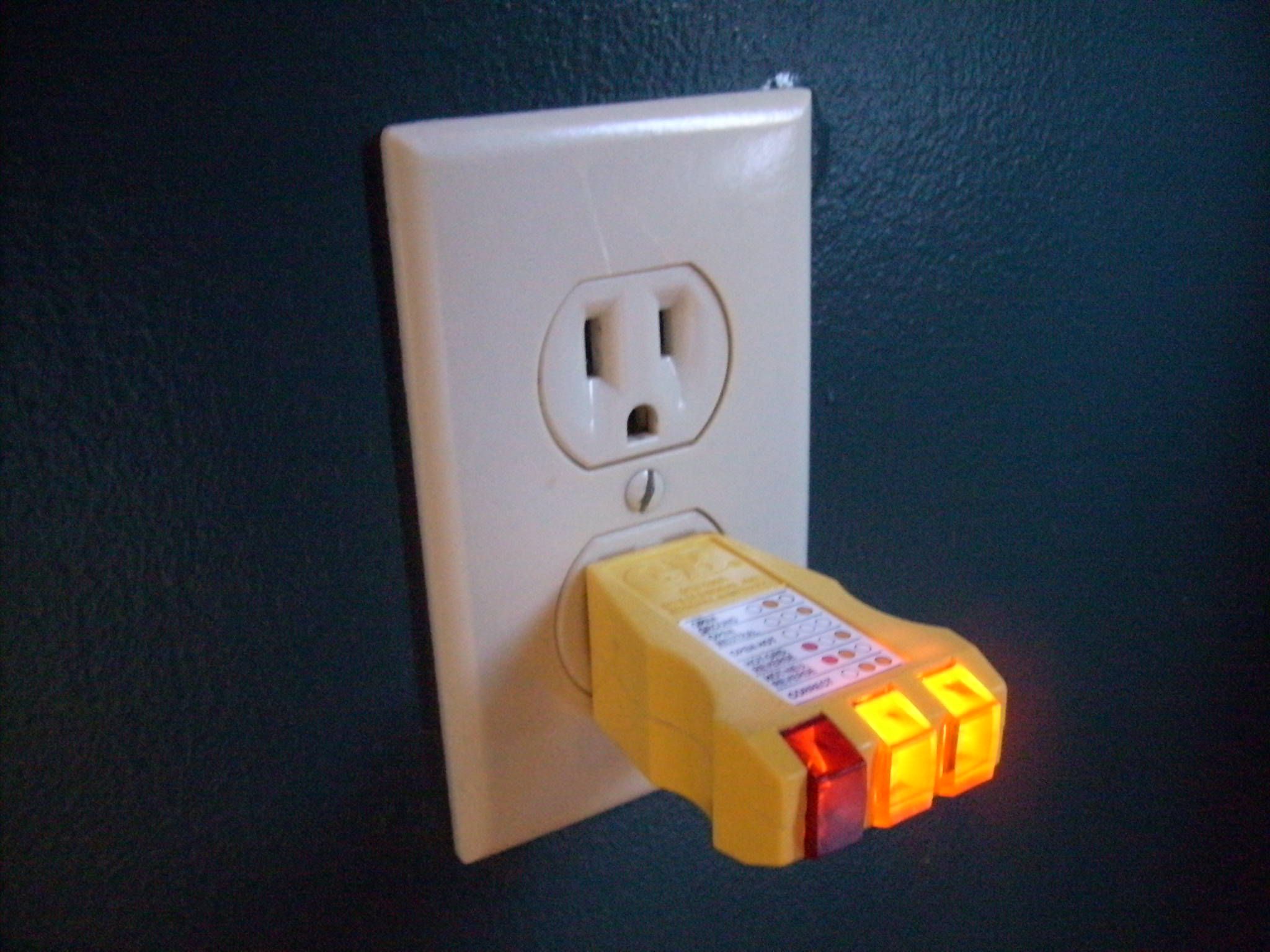

Here's a test, if this works, it might prove the "hot ground" theory, and you'll need to take further steps to get that issue corrected. Do NOT use this as a permanent solution as it could be dangerous with unknown reasons as the true cause of where the stray voltage is getting into the mix. Do NOT connect the grounding tab to anything, leave it floating, and make SURE it doesn't touch the screw on the center of the outlet you plug it into. I also stress that while you do this test, you disconnect your receiver from the coax, and do NOT touch the ASC1 case, or anything else!
Cheater plug:
plug this into your outlet, and plug the ASC1 into it.

That is a correct light display for the outlet wiring, but how about the interaction between the satellite dish ground and the electrical outlet to structure ground?
Is the satellite dish ground bonded to the structure ground? If no dedicated bonding wire is connecting the satellite dish to the structure ground, stray voltages may be traveling back through the control wires, circuits and exiting to the structure ground via the ASC1's grounded 3 pin AC plug. This would be an example of "voltage potential" and the plug LED tester would not indicate this wiring problem.
