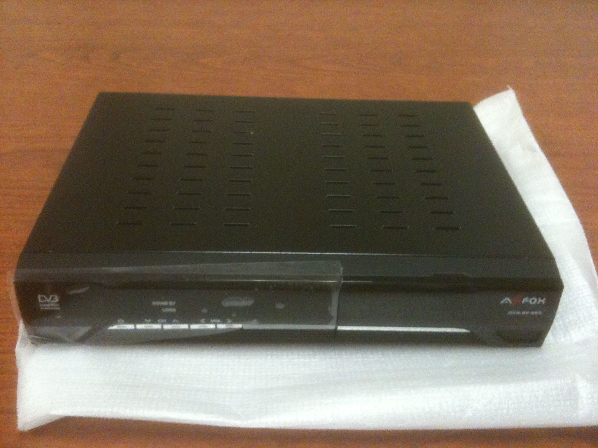

Dr Seuss here, az fox is here.

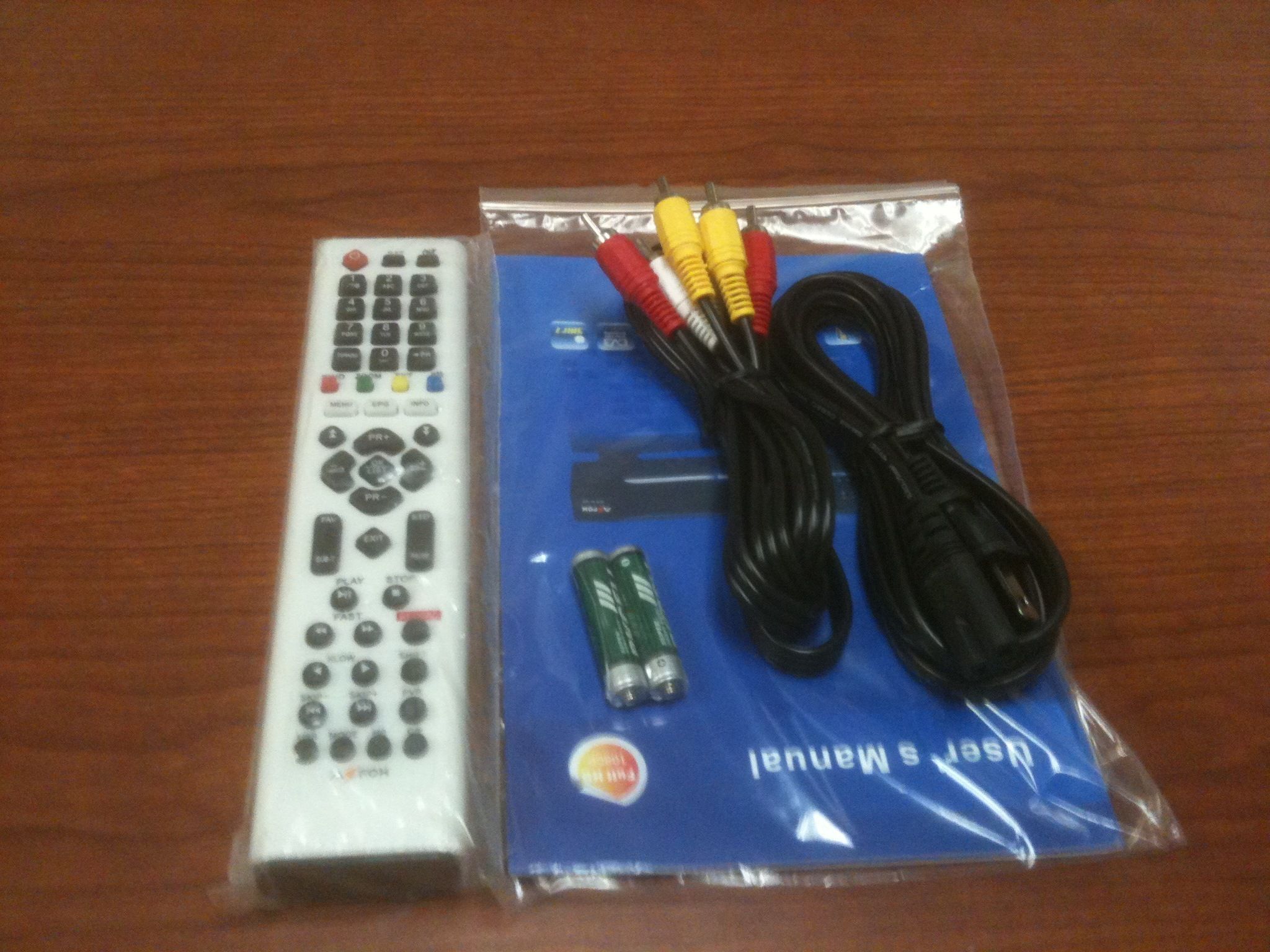

I think the remote has rocks from iceberg.

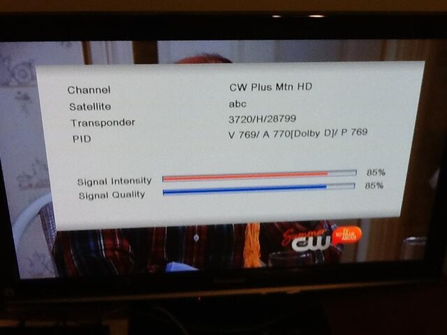

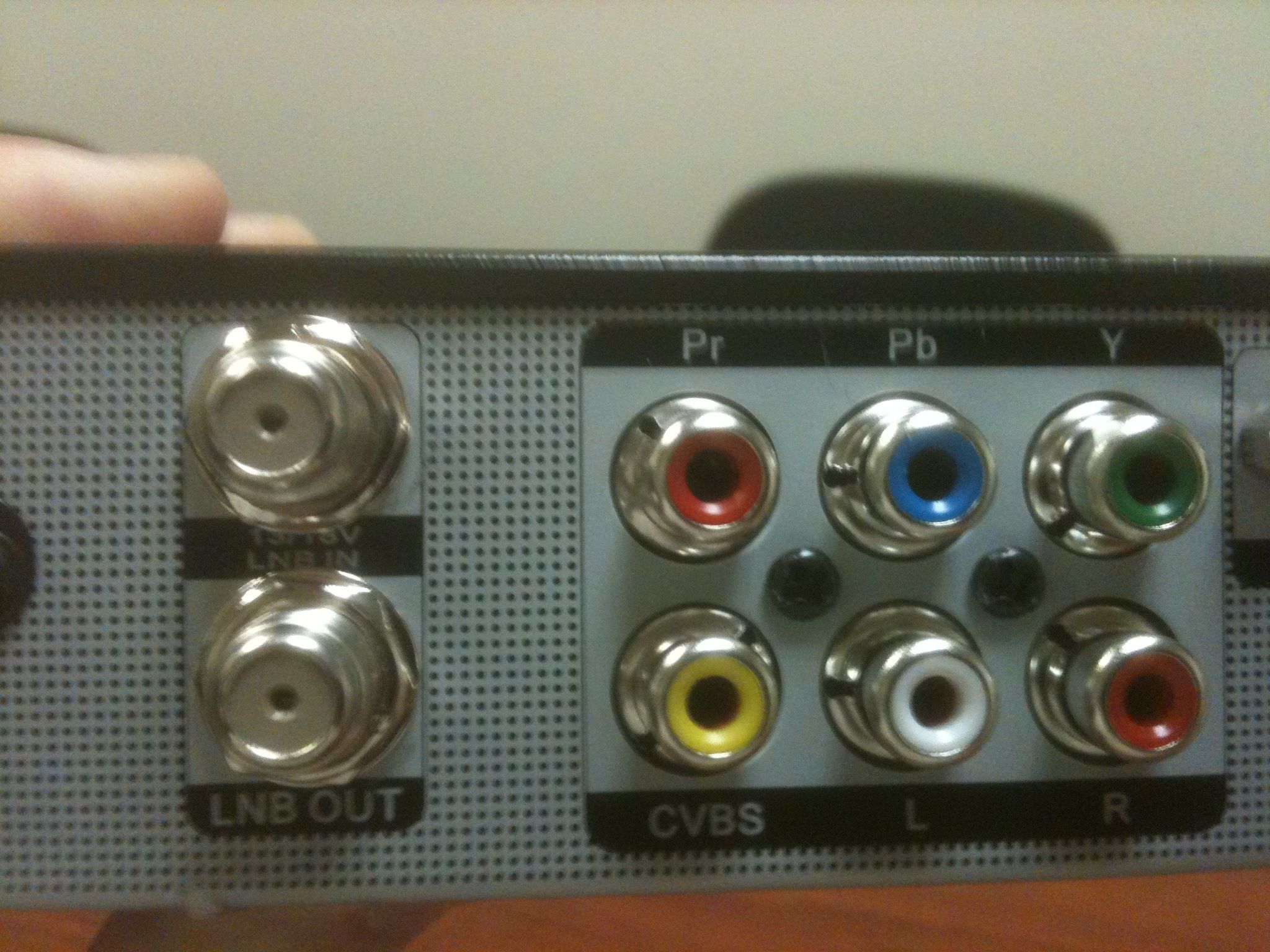

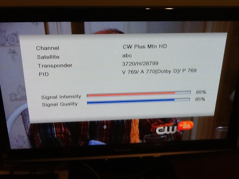

So I blind scan in 91C. Go to watch reelz video but no audio hum check settings try different hdmi cable no audio. I then hook analog LR still nothing at this point I'm think it's must not do DD so I go to arts and bam audio. This is off to great start.
it has to do dolby digital. Alot (maybe all) of the S2 has dolby digital audio.
Per the specs you posted in post 1
Audio Decoding MPEG-1 Layer 1 & 2, Dolby Downmix
check in the menus to see if there is anything

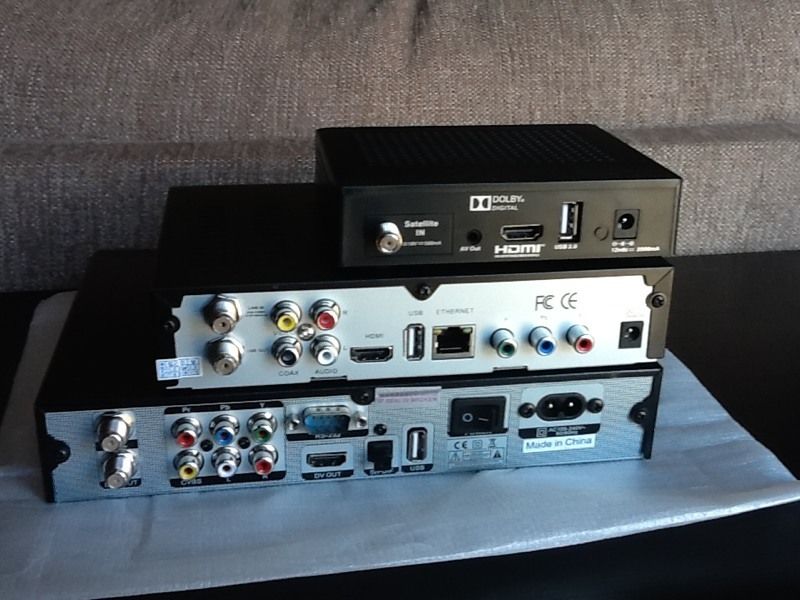

wait a minute...scratch that. Notice the SPDIF output on the picture? Maybe it doesnt decode it internally. I remember thew Sathawk originally didnt do that either (software late on added that option where it was decoded internally)
Yup that's what's going on here to.
When I connect to my denon sound works on DD ch's. (Have to switch to BS Out on digital audio out under TV System in menu)

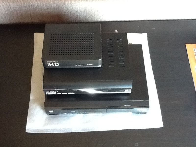

Line up
AZ fox S2S
DBS6000HD
MicroHD

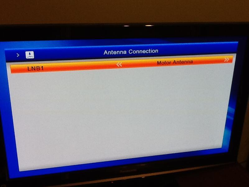

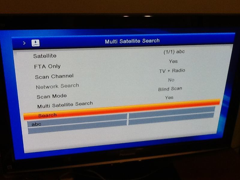

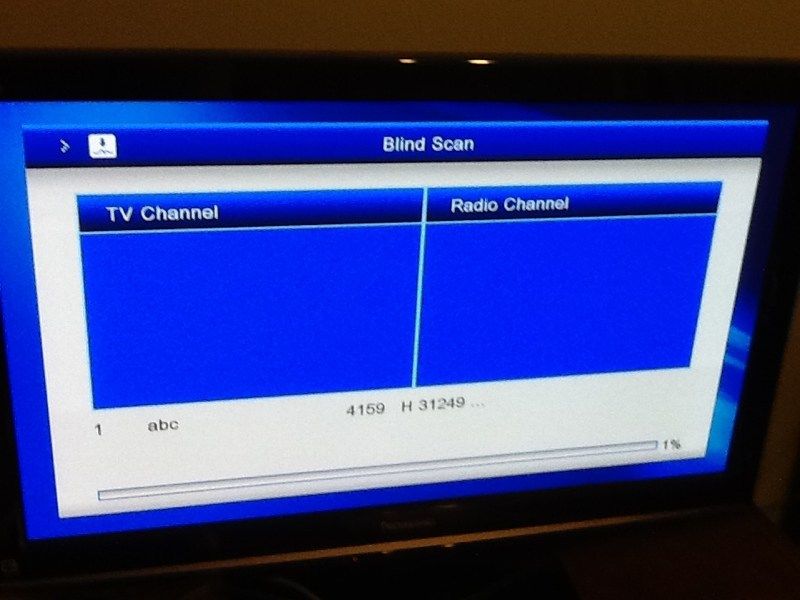

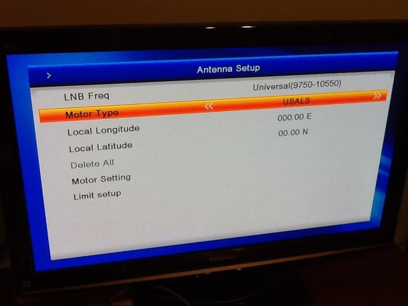

Screen shots

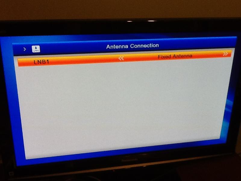

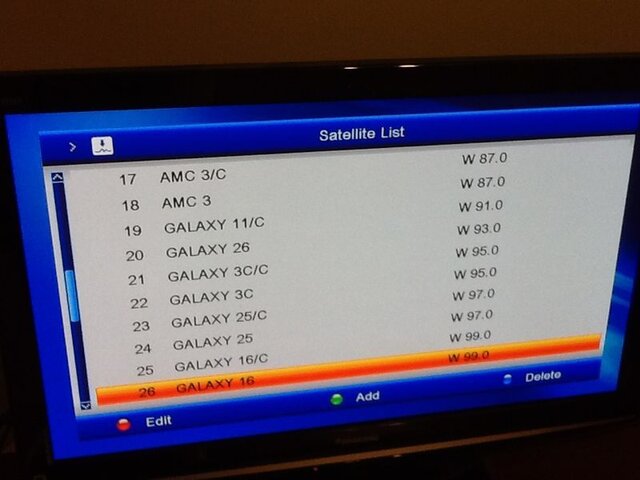

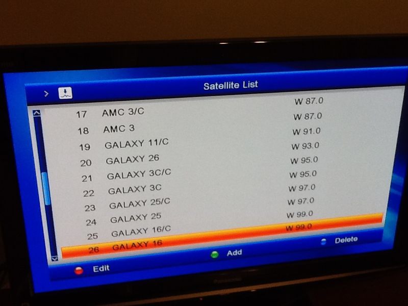

on the pic of the satellite list.....a wee bit outdated
G11
G25 at 97W
AMC3
no satellite at 89W???
hope you can update the satellite list
also looks like its a either or with a switch and motor......just like the Sathawk I got a few years ago
