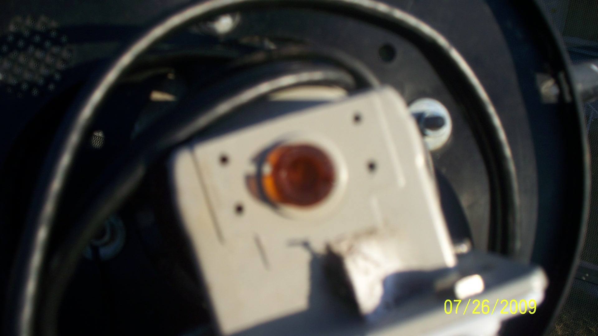

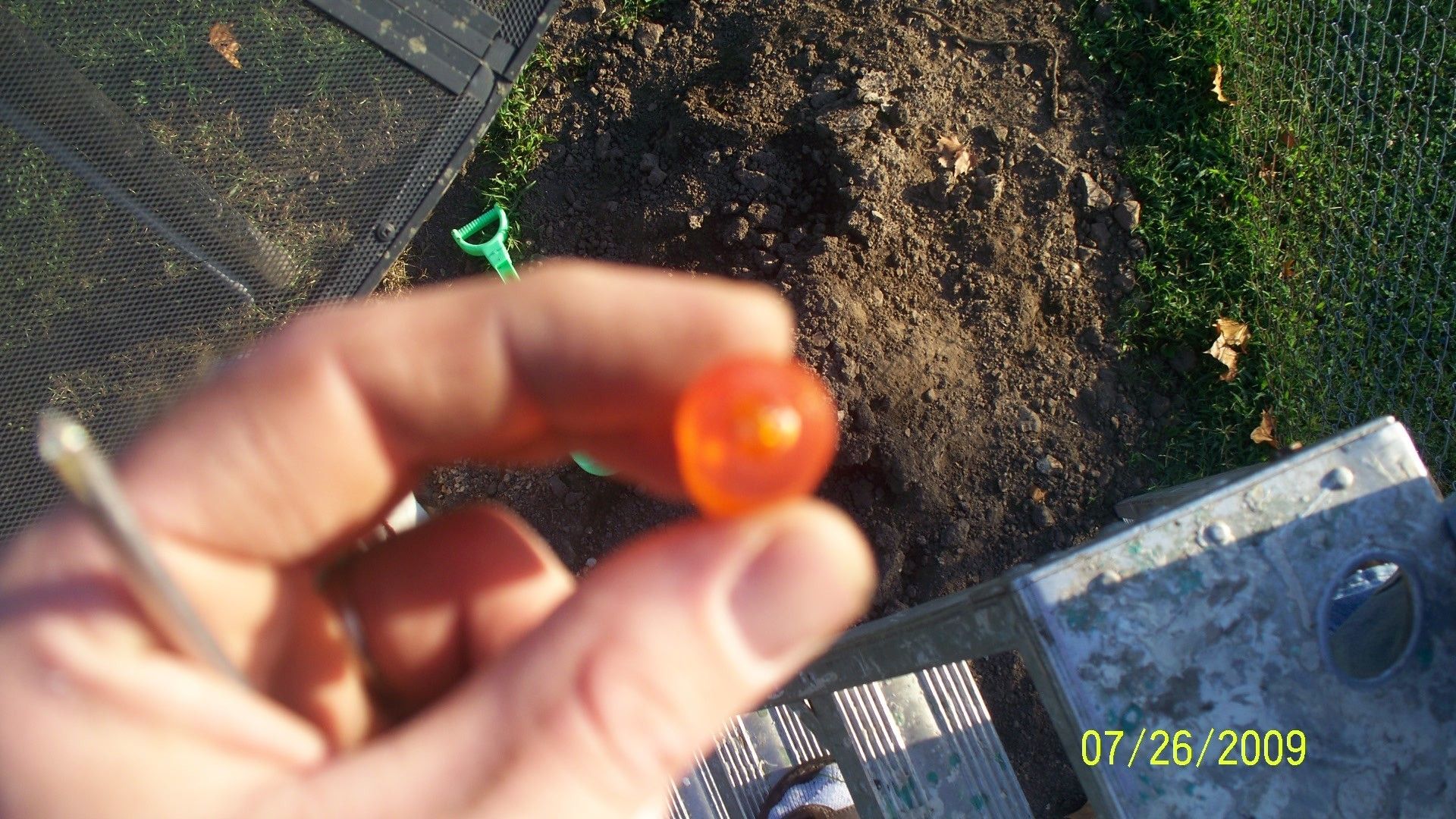

If the servo is all that is bad, than you should be able to buy one for about 20 or 30 bucks/dollars. My servo didn't work when I found my dish, so I bought a DMS LNBF . Two reason's why,first I wanted to use a pci dvb-s card(no servo control) second My servo problem could not be fixed on my lnb look at pic (broke on the inside). If I was you I would buy just the servo or a lnb because you will be able to fine tune the skew. On flea bay I've seen lnb with servo for about $40.00 maybe cheaper.
You could take the cap off of the lnb and look at the pin or needle,if it's facing up and down you can check your V-polarity channels if they work than you know you need a servo. If it's facing east to west than check H-polarity channels. If the needle moves when you change channel's and still no picture than you no the lnb is bad. Just some food for thought.
