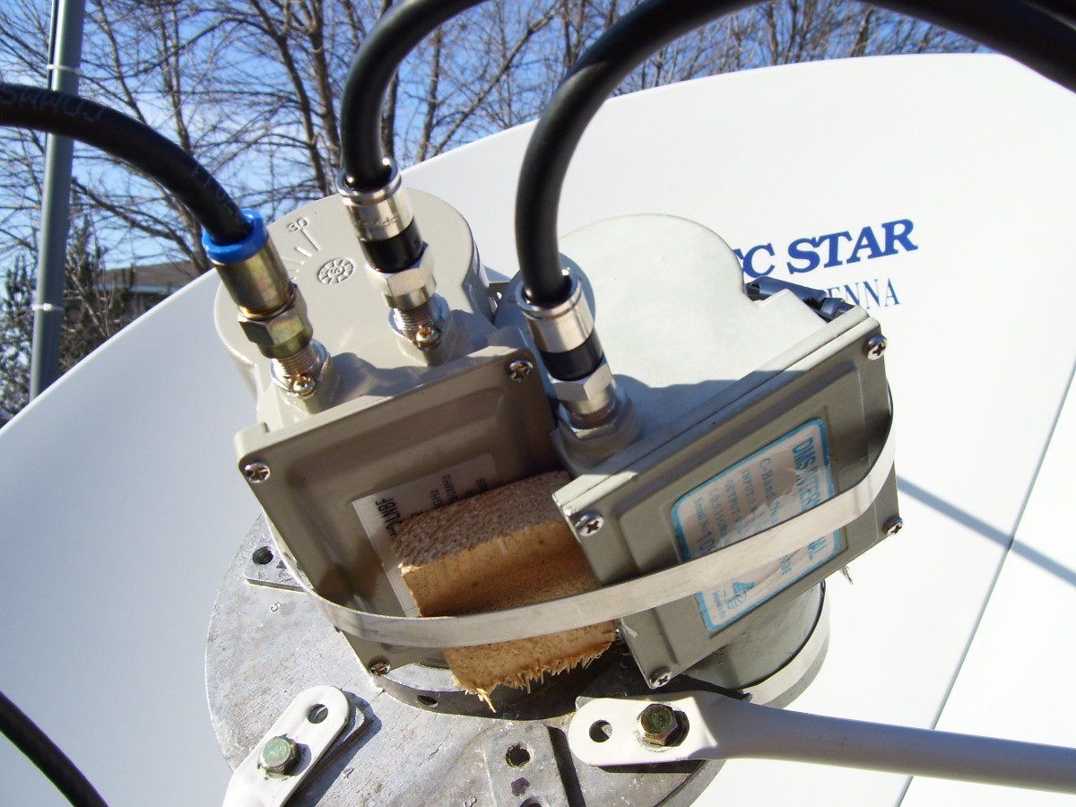

I just replaced my BSC-421 on my 7.5 footer with the new C-2 that I just got. The 30--0--30 markings are oriented differently on the 2 LNBFs. So I looked down each one's "throat" and the probes are in the exact same place with respect to the box on the outside -not the 30--0--30 marks. So, I installed the new one oriented the same way the old (421) was, disregarding the marking,and I got nothing on the 4DTV 'till I selected "Rotated 90" in the menu. The 30--0--30 on the old 421 was lined up with the "0" on the north-south axis of the dish and it worked without rotated 90 selected. I'm confused, since the probes inside are aligned the same as the old one was. They should both be the same, no? :confused:
I've noticed from previous C2 LNB's that they are off by 90 degrees for some reason
Interesting as my old 421 was also 90 degrees off
see attached pic...this was the 99/103 dish setup I had a while back
my true south is 93
So should I turn it so the 4DTV works without "rotated 90" selected..? 'cause the 4200V will be sharing this feed, and everything gets entered manually on it so reverse polarity will be a royal PITA!
Rotated it so the 30--0--30 marks are lined up with the polar axis and ...success! The DSR-920 and the DSR-4200V are sharing the 7.5! The polarities are correct. Thanks Ice. -That was just step one...going back outside now. :) (The Primestars are looking at me funny...they know they're next!) :eek:
