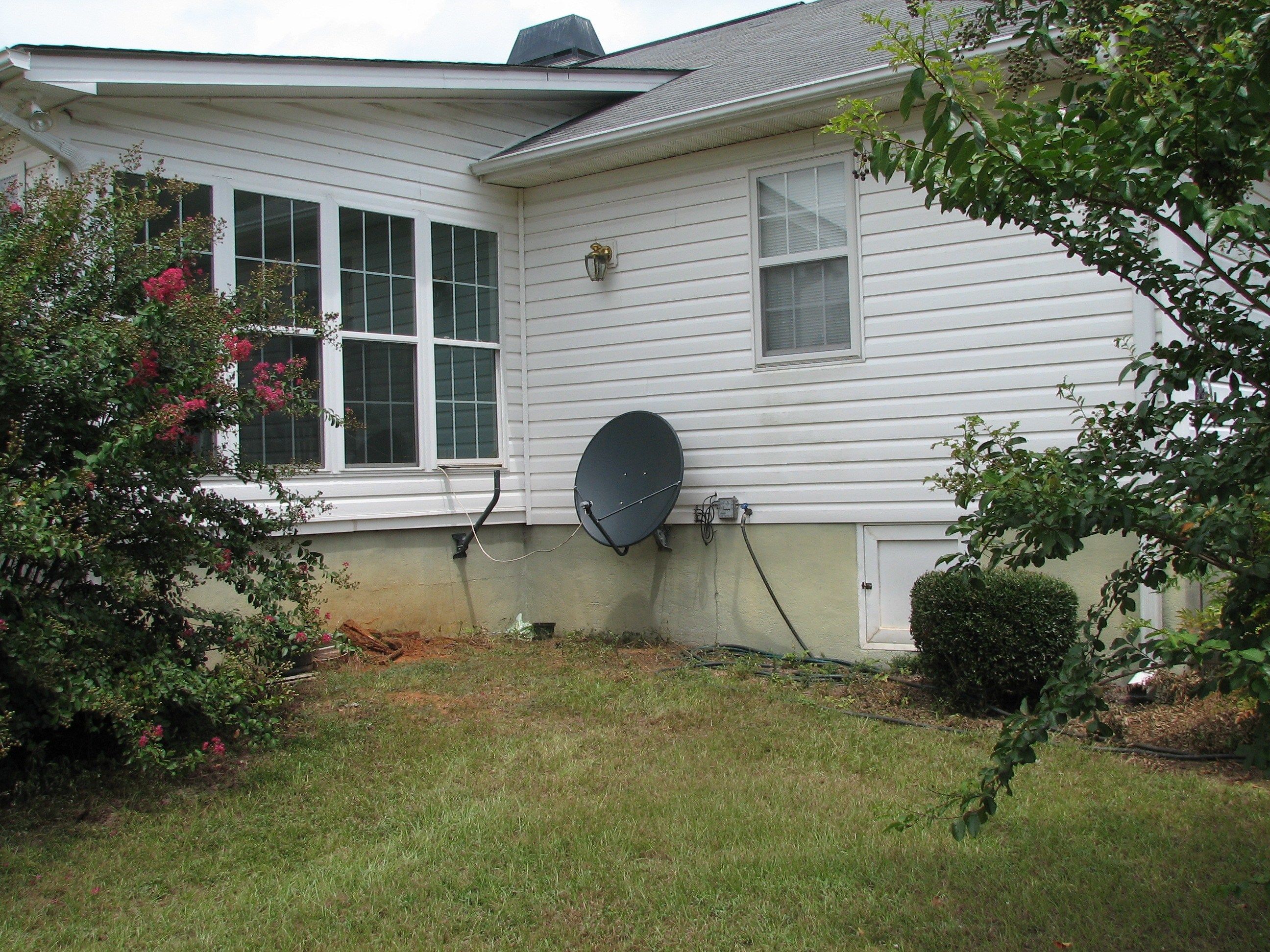

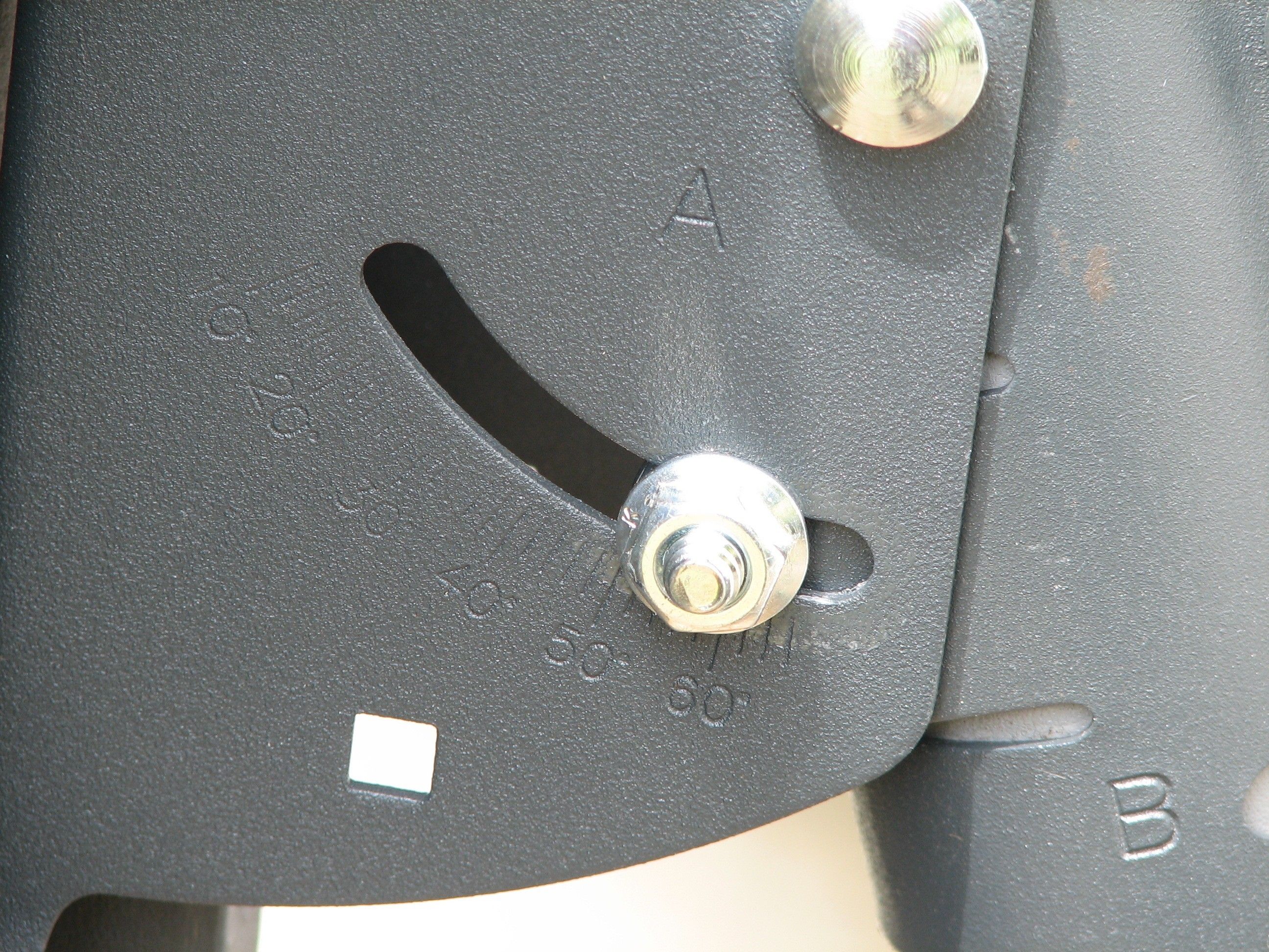

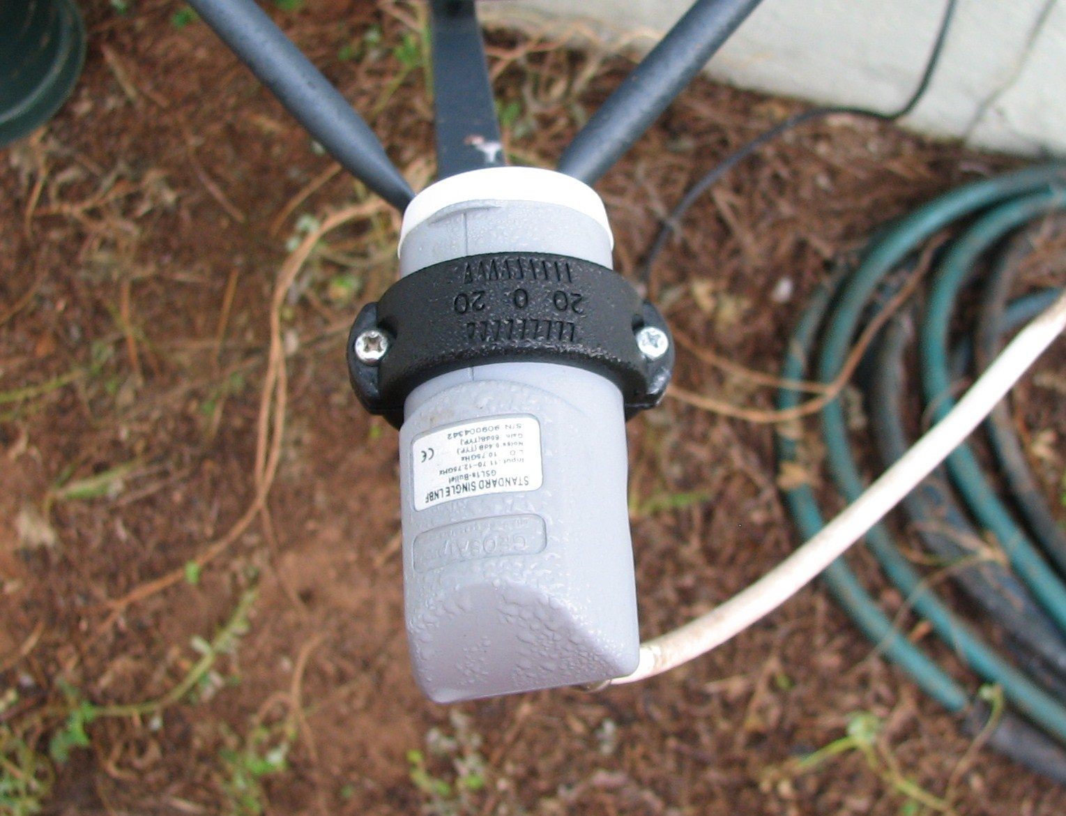

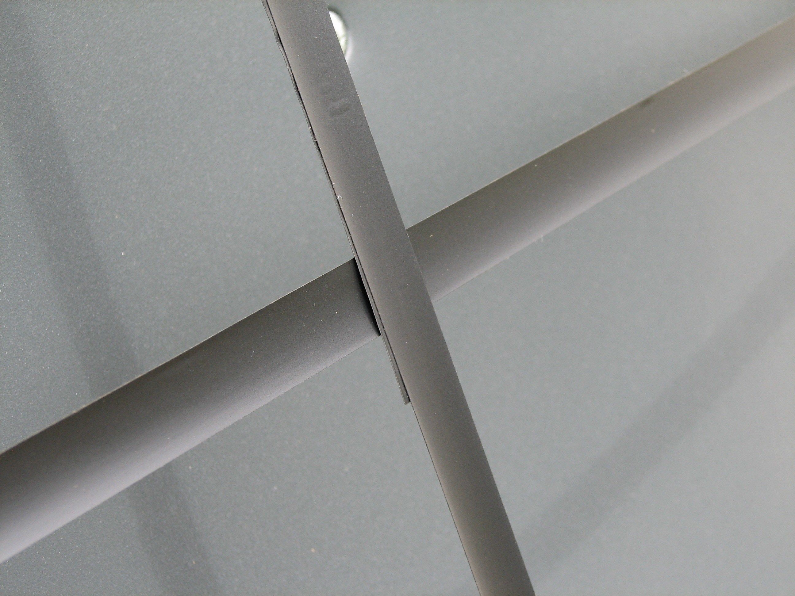

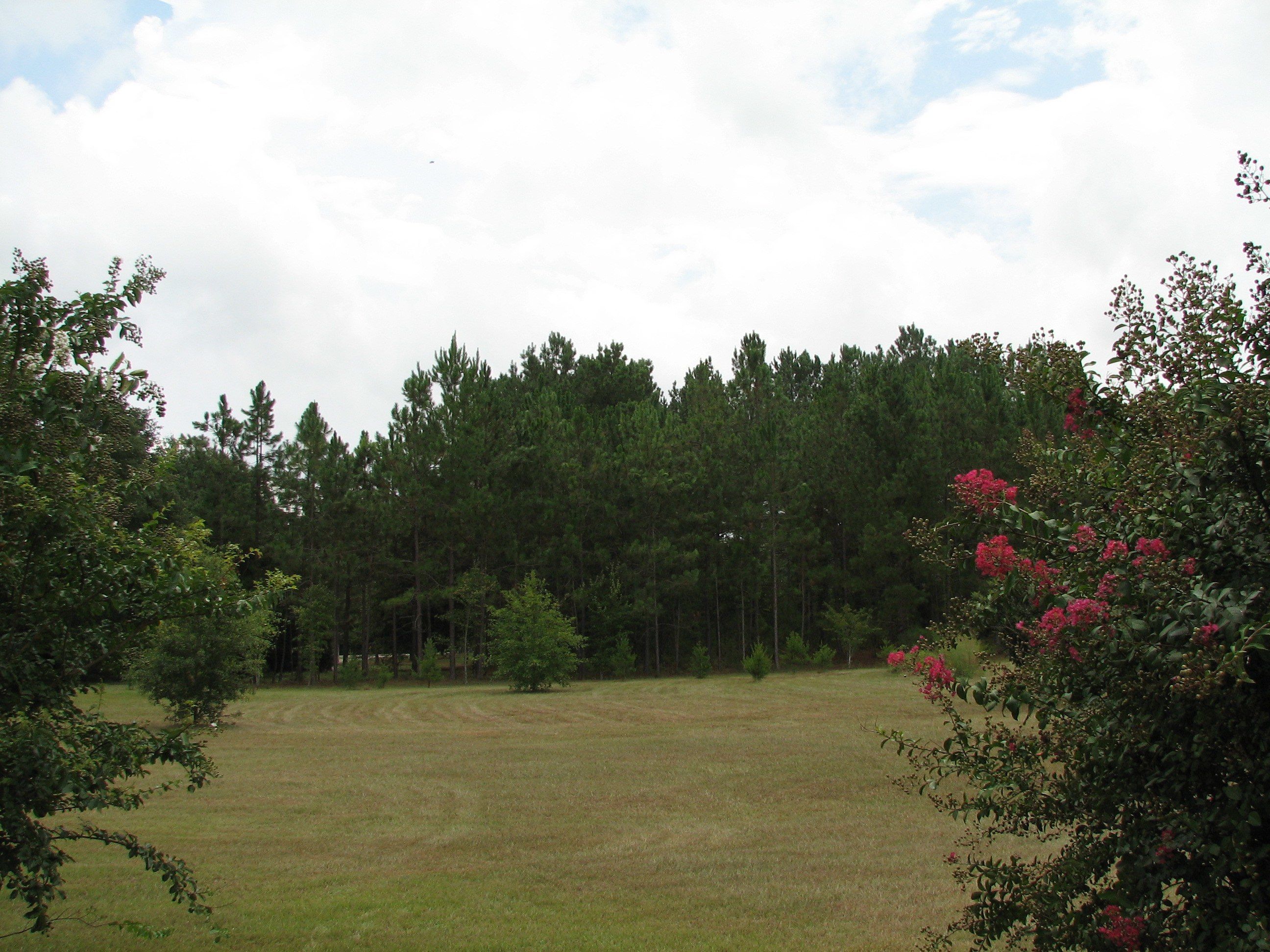

I have tried off and on without success, but on Friday, I found G19. I had most channels I want except Life&Health. Some others that I have no interest in weren't there though. I thought... 'good, maybe I can use this now'.
OOPS! My success was short lived. I left it on this am and installed some hardware on a friend's computer. Came back and found the channel still playing. When I changed the channel, I had only 2 readable channels, none of which were on 11842.
It just seems G19 is unreliable here. I always can find SES1, but there is not much I want to see on there.
I tried to post pictures on here before, but they didn't go. I'll try again with this post.
Thanks for your sympanthies.
Bill

Hello,
Bill

During the past few hours, I have been trying and as the heat has changed a lot over the past few days (mid 60's to mid 90's), I remember Brian's suggestion to exchange lnbf to see if it is reacting to the heat. I re-installed the large input lnbf from WS International - NOTHING at all. I wasted a lot of time and money on them. Don't ever buy anything from them! (although they have a slightly larger dish at a lower price) The last newer lnbf from Glorystar did give me most channels, including the ones on 11842. Many of the others are not there.
T4Runner: Yes, I understand how sensitive east/west rotation is. And 1/16 inch here represents miles of distance relative to the satellite up there. These dishes don't lend themselves to that sensitive adjustment. If I loosen the rotational bolts, including the long one through the top over the mount post enough to easily pan east/west, then re-tighten them, the elevation pulls up. I either have something from G19 or nothing. The concept of finding the satellite and then tweaking has always worked for me on AMC4, but never on G19. When I pan and hit on G19, I stop at that point, and any motion at all loses the signal. The current position gives me 65 Quality on some channels and most that I get are 50 or above. Very slight elevation or rotational movement only degrades the signal quality. I may turn the receiver back on in the am when the temperature has dropped and get nothing on 11842 and some on other tp's. Is the dish warping? I don't know, but don't think so. It is new with side braces. I have posted some pictures recently and you can see the sky is clear, the house protects the dish from wind, etc. The house also protects from TI from the direction of the Air base 45 miles away.

I have two lnb's and have noticed a difference between one and the other when it came to signal strength. Tightening and loosening the bolts makes a big difference on the signal. I keep the meter connected until I am done tightening and try to figure out how to compensate.

Concerning dish adjustment: Yes, you remind me I have three different size Channel Master dishes and they all have me spoiled with their dish elevation adjustment system. A bolt that you can put a ratchet wrench on and make small peaking adjustments so easy compared to all these 'other' dishes.
Once you have found a satellite and adjusted it to the peak on a channel master, you never want to touch another brand...

Not a line of sight issue - Verified no trees or buildings blocking the satellite signal.
Possible local interference or adjacent satellite interference - Op shielded the LNBF with fabricated larger scaler/cone. A spectrum analyzer might point to interfering RF or the variable that is present when the reception is good or bad. Might try a larger dish with tighter beam pattern (1.2m or larger) as a test.

rv1pop's story about finding the satellite somewhere outside his expectation is well taken. The site we worked on yesterday is near some trees, right beside 3 direct TV dishes working fine. I have heard that direct's satellites are at the same elevation as G19. I used the elevation scale on the GeoSat book and find the target just over those trees.
