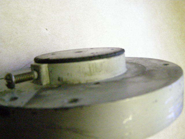

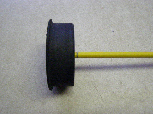

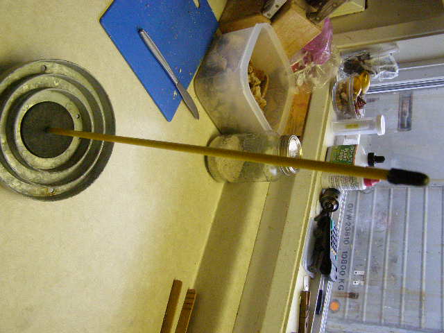

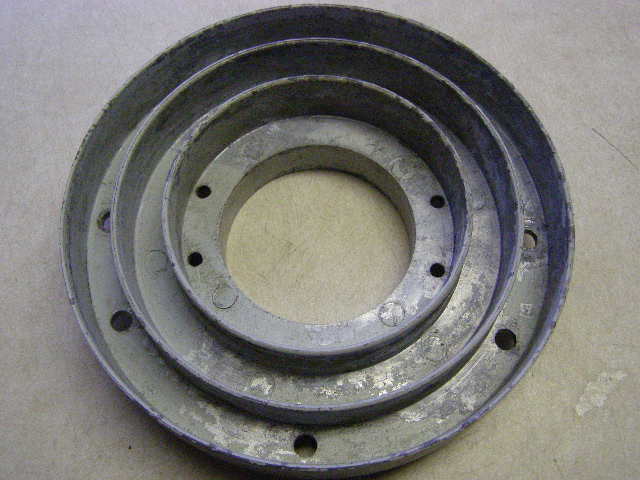

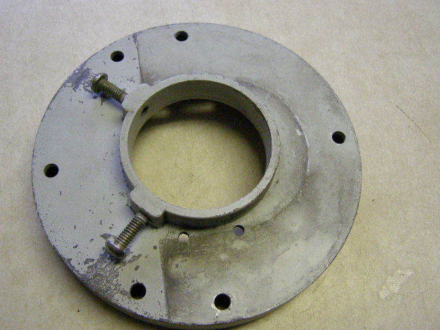

I use a hockey puck cut down on a lathe to fit the inside of the scaler ring, careful though I have non Chaparral Lnb's and there diameter is different, not a standard inside measurement, with a 1/4 inch center hole drilled in puck on the lathe as well and a straight fiberglass tent pole section to find the dish center. The small lip on the hockey puck is to make sure of the proper alignment. See pictures. The puck was turned on a wood lathe with wood tools and finished with a large file for a perfect fit. For your non removable scaler ring just reverse the puck on the tent pole, it's also hollow to use a string for deeper dishes. May not work on a Chapparal ku corotor, but on a scaler ring no problem
