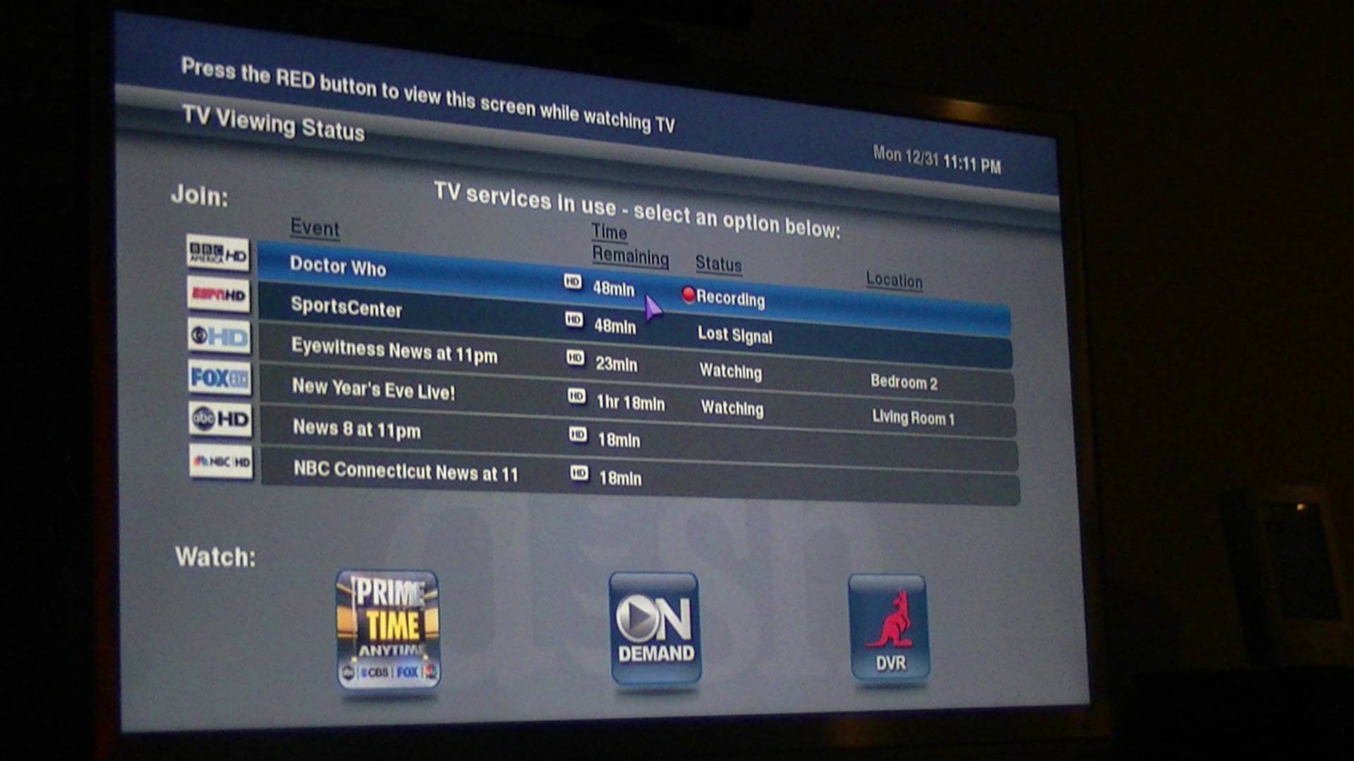

I appear to have the same issue here in SE CT with both Hopper's in my 2H2J setup. Check switch shows all green, but one tuner will show Lost Signal. I did resets, power cycles, etc., but it would not resolve the issue. Then, miraculously, it works the following morning. It has happened a few nights now, and it wasn't until I saw this thread that I realized the Duo node is mounted on the side of the house where the sun rises.
If you are having this issue where no channels are coming in, press the RED button the remote and select a different tuner.
