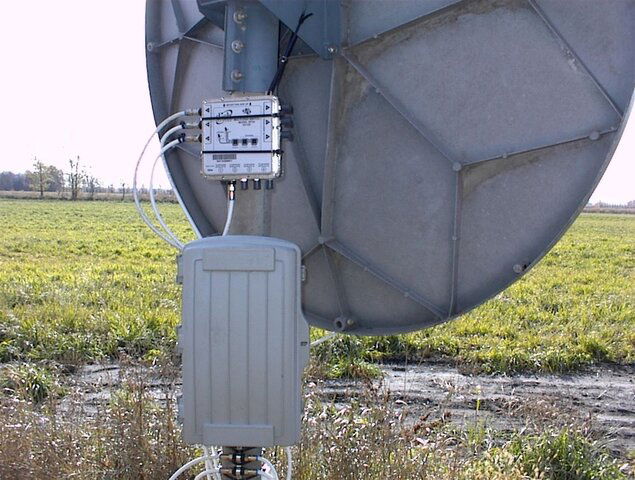

Always keep outside connectors horizontal if possible and route the cable into at least one loop so that water runs away from the connector. Water running into a connector will cause even the good ones to "rot" .

Hey Cadsulfide
Is that a Primestar box hanging on the pole? In all the dishes I snagged from yards I never got the box. Wish I had. I found a box at Home Depot for sprinkler control electronics that works pretty well but is not nearly so spacious

Yep, found it at the town dump. Pretty much anything that keeps most of the rain out will do. Another hint, small cable ties work great for tagging your cables, one two, three, etc.
