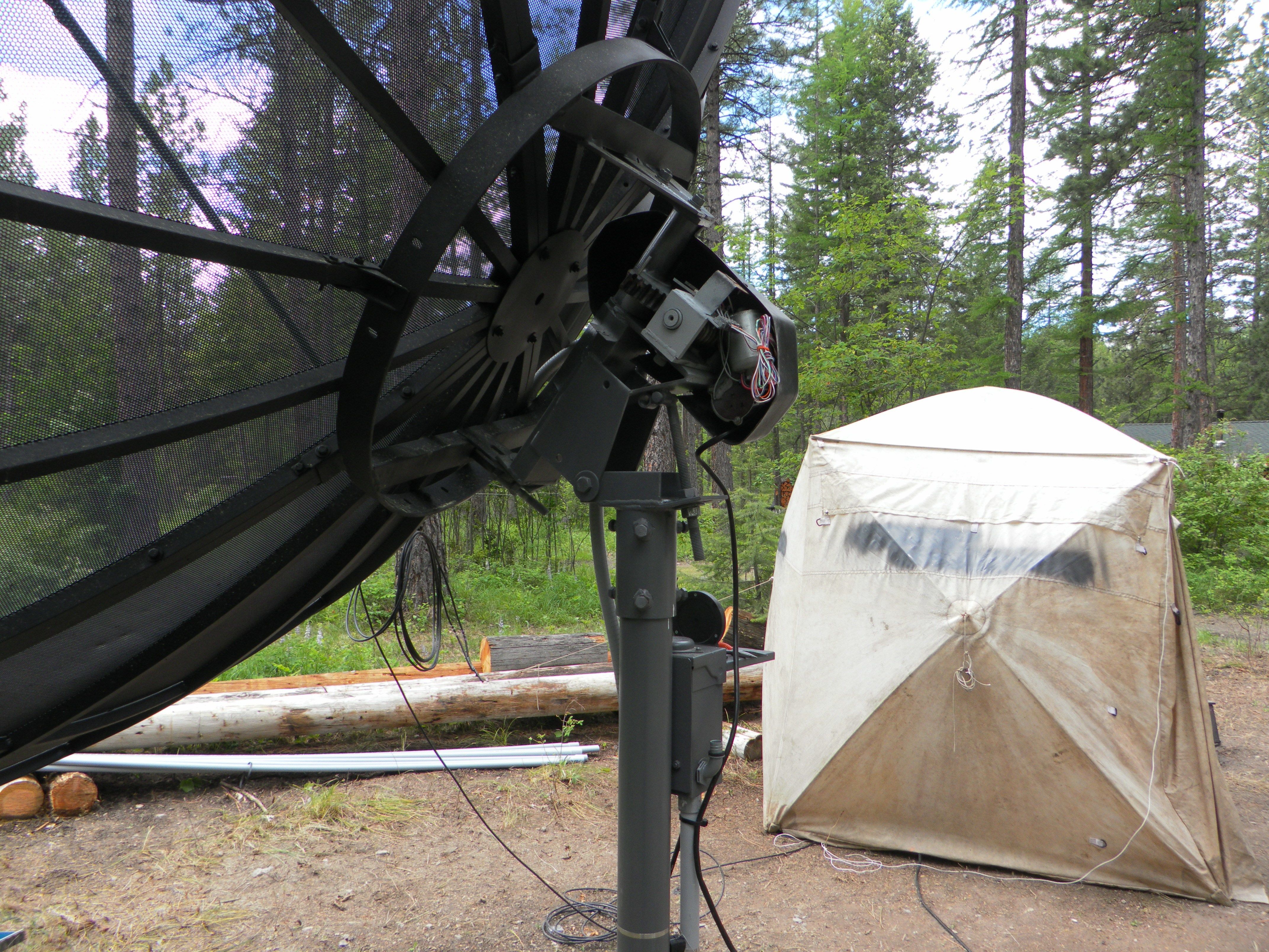

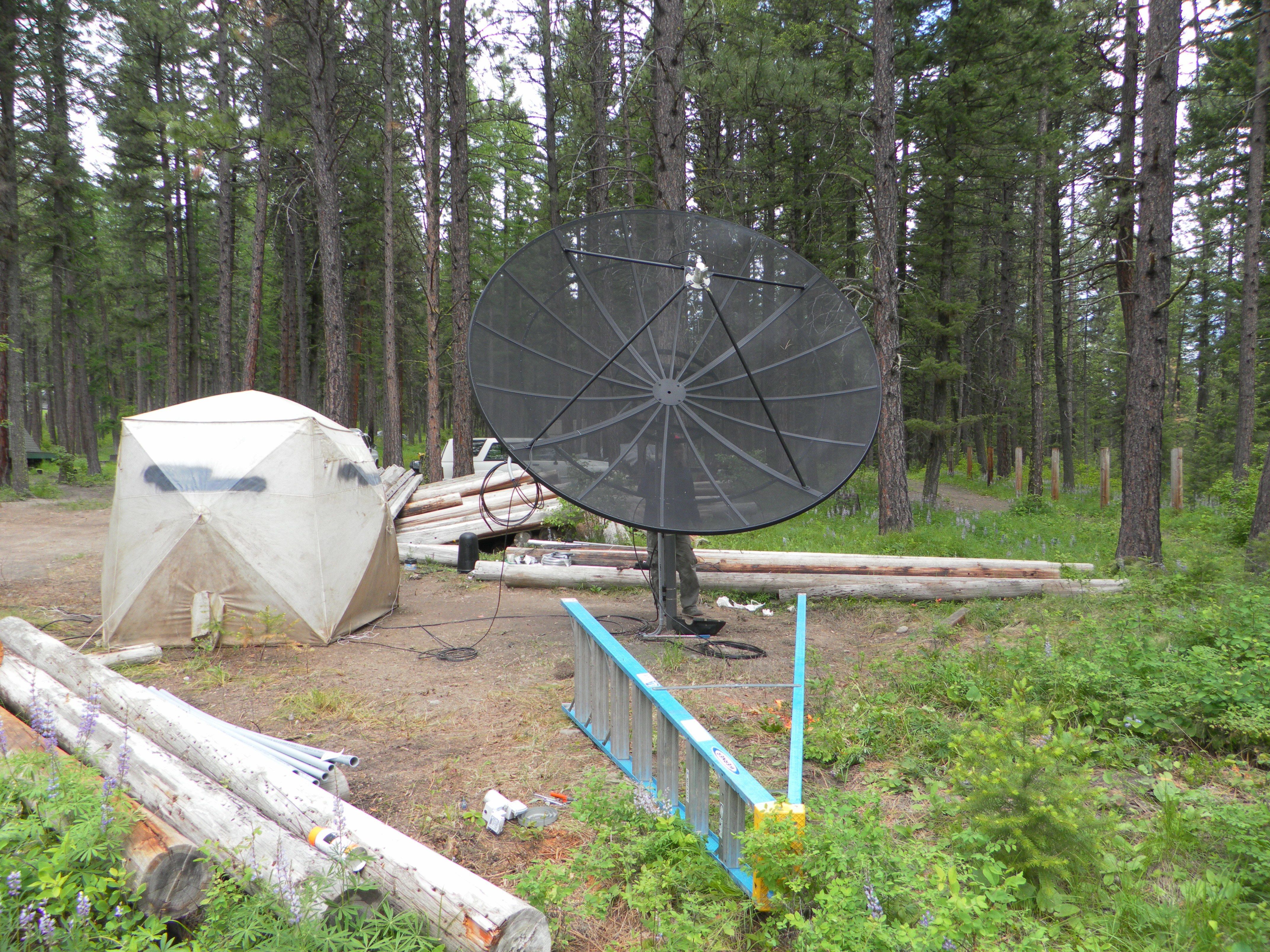

Well the eager beaver has met the real world of FTA and all the junk you can buy. He is waiting for his FOURTH VBox 7. The first two arrived with the transformer ripped from the bottom of the plastic box it's in and rolling around inside. I think the dealer got a big box full of them that had been dropped. The force of the impact tore loose all the transformers. The next one comes from a reputable dealer for $15 more and the sensor circuit doesn't work, no power. So perpetual ER2. "Well s**t, we'll work around it" he says. So hours go buy and no signal, nothing. I'm like wait a minute, take that WSI crap LNB off there and put this GSP C1 on that I brought. Two minutes later we got lock! We then parked it on SES1 to wait for a VBox (again)

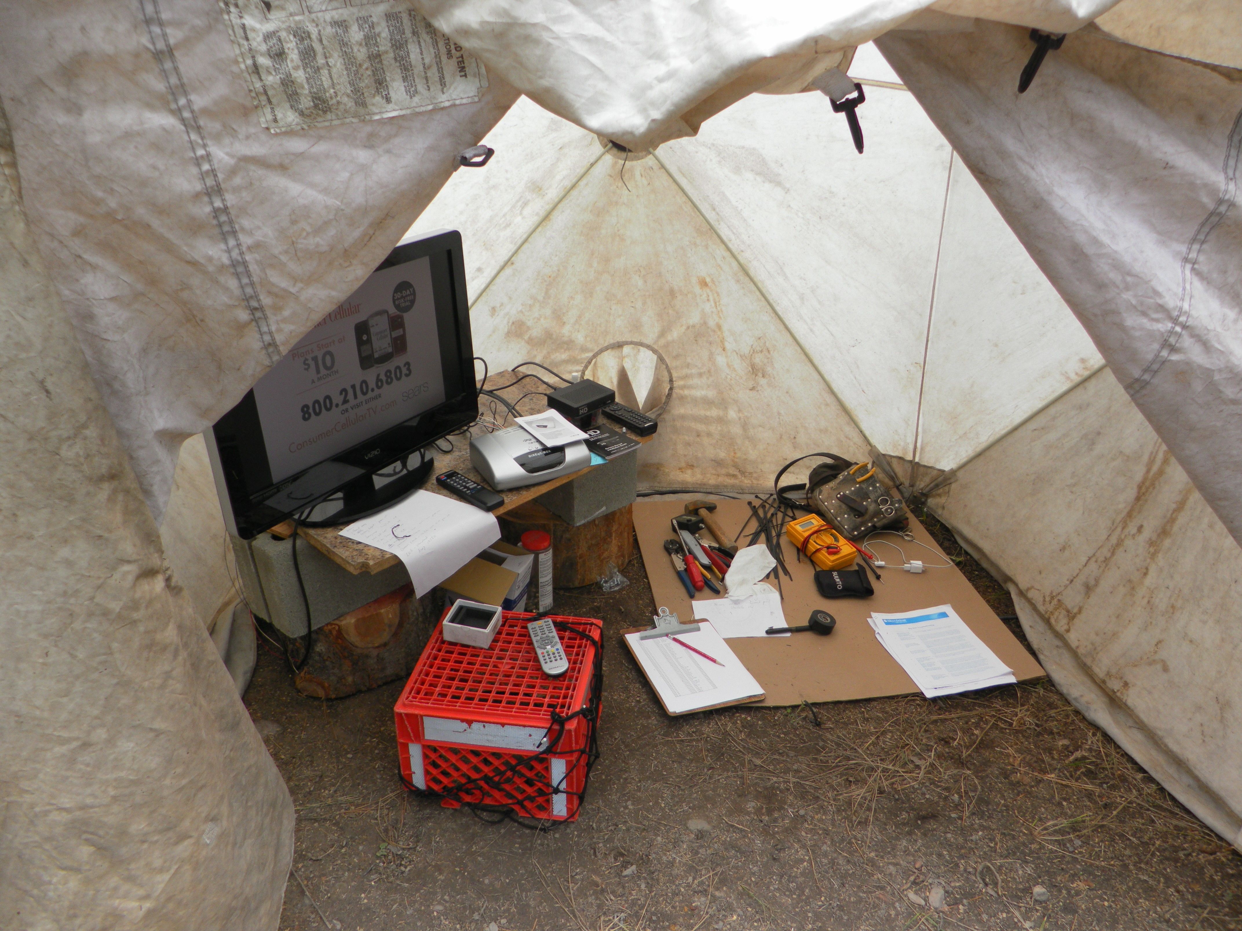

Just a tent to live in, but he's got C band!

Is that an Ajak 180?

10' Uni-Mesh perforated on an AJAK

Nice little tent to work with when you have a cool day with intermittant showers. You see those parked over open manholes usually.
