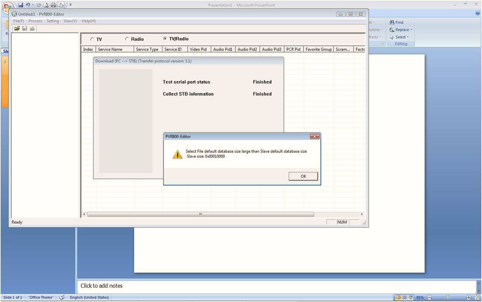

Well, I went and tried to upload the backup file, but I'm not sure if I'm using the correct loader. I get a file mismatch size and it looks like this. I can download the file from the box, but it doesn't want to send it back up.
If you PM me with your email address, I'll send you a different loader, which might help with recovery. The good news is that your stb downloads still, so it's got a brain! :) Remember that you need to start the transfer with the stb turned off at the switch. :)
