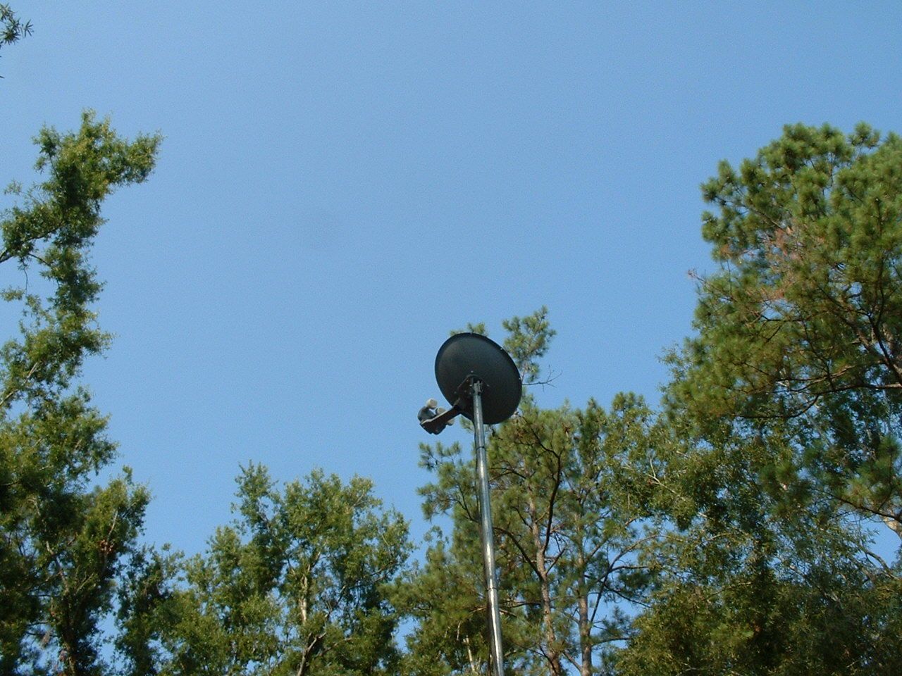

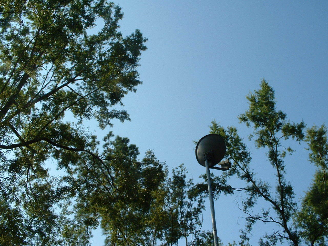

Yep that is exactly what he looked like. I talked to another local installer and he told me my multisat dish (phase III) was the exact same size as the 1000 so it was just another lie from an installer. The first Dish guy said that the Dish sat would snap the pole in two.
All of the installers have told me that the 129 was blocked by a tree. I got excited when I heard about the 61.5 dish sat. I pulled out a compass and thought I had an unobstructed view of it but I saw I was reading the compass wrong. I still might be able to hit from the back of my house. I have the last installer coming out on July 6th. He said he has 20 years of experience doing this (I've heard that before) so if he is being honest either he can do it or it is impossible. If its impossible then that is that but as of yet not one has pulled out a dish. How can he cut that pole in half and still get a signal? Maxing out the elevation of the dish?
I'm posting two more pictures one from each side of the dish to get your opinions on the 129 or 61.5. Any of you guys seen that bad but funny movie "One Crazy Summer" with Demi Moore and John Cuzack? I feel like the guy in the bathrobe sitting around the radio chain smoking trying to a radio show contest. :)

you can still hit the 129 with current set up
doubt the 61.5 will hit

Looking at the photos I would have to agree with Stevo...... no shot at the 61.5 but looks as though the 129 would be there. And as mentioned earlier.. there is always the possibilty of a two dish system... your current location for 110/119 and another at 61.5 or 129 if 61.5 isn't possible.

First off, I would have never installed your satellite on a pole of that length. Windsheer alone will degrade your signal. You know that pole is swaying on windy days. I won't install a system that's only going to get a half ass signal. Another issue is that the AT9 1st generation dish is almost 40 lbs in weight! No way an sane tech would put it on a pole that high even if it were the correct diameter (which by the way yours isn't. the AT9 requires a wider diameter pole than the 3 LNB dish). The second generation AT9 dish has just come out which is slightly bigger than the 3 LNB dish, but again a pole that high up isn't an option forget the trees for the moment.
Now other techs on this board are telling it can be done on a pole on your property. Based on just pictures alone, I would say no. You get the stabilty for your AT9 dish with a pole in the ground that is no more than 5' high. Looking at your situation, a tech would use a Sunuto inclinometer and tell you EXACTLY where each satellite signal is coming from. In Virginia where I am a installer for Ironwood (HSP provider bv the way) we have to deal with people that are buried in trees just like yourself. I refuse to give a customer false hope and tell them they "might" get a signal. When I do an install, I want them to get QUALITY service for years to come not months or weeks (which appears to be the case with your set up). Plus I don't want a repeat service call. Techs for Ironwood don't get paid for repeat service calls. I really do hope you find an answer, but if you get another tech out there, during his site survey have him show not only the direction (azimuth) the signal is coming each satellite, but the elevation too. That way you know specifically which trees you will have to deal on the location you are looking to relocate your dish with before any installation is done.

Perhaps you haven't read this entire thread. That pole mount has been working for three years. It survived hurricane Katrina! A big pine tree fell in my yard but the DirecTV setup I did survived without a scratch. As soon as I had power I had TV. From what I gathered from the various techs my current setup will not work with the big AT9. One of the older installers told me that a pole mount would probably work we set a date for it to be done and guess what they send another kid out here that wouldn't do it. That is when I started to get mad.
I think those pictures can be misleading. You have to remember I took them at ground level it looks like that pole is reaching into the heavens. It is about six feet from where my roof starts. I agree with you about having a quality install. My job obviously was since it has survived for over three years and I get mid 90's signal strength from the three sats I hit. Right now around here there is extremely high demand so there is no incentive for them to fool around for three hours and bury cables etc... it is much easier to just go on to the next job. I have my last tech coming out tomorrow. He suppose to an old vet and I explained everything to him. If he says no way then I will just keep my current setup and use my OTA for HD. I'm very upset about being lied to by the Bruister tech and the pole mount was never even attempted. I've been with DirecTV since 1998 but if the Dish tech can do the install I'm a gone pecan. If he says it is impossible I will stay with DirecTV until the trees finally do me in or if my local cable company offers a better HD package.
