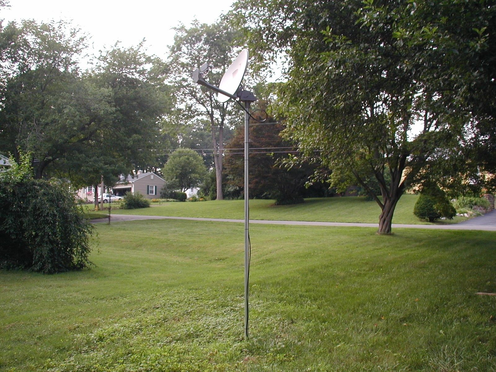

My AT9 is 9 feet in the air, the pole is three in the ground. It will need guy wires, but even in moderate wind it is okay. Here is a shot of the install.
Are you getting a good signal? Who did the install? I think that setup would work for me.
I installed the pole. The signals are fine. I would have gone four feet down, but I hit ground water! :( Halsted put the dish on the pole and aligned it. That's all they did, since I also ran the cables in a trench for them!
I have a few days of vacation time coming up I might just do it all myself. How far did you dig for the trench and do you need special cables?
The trench is about a foot deep. Get some electric conduit to put the wire in, then bury that. The cable is buriable without conduit, but it protects it from other problems, like accidental cutting.
Thanks for the info my "LAST" installer is suppose to come out today. If he will not do it then I'll do it. What is conduit? A tuble to protect the cable?
Yes. You can get them at Home Depot or Lowes. Get one big enough for more wire. You might want to run extras in case you want them later for another receiver or a dvr.

A real pro came out today. He spent about 30 minutes with his instruments trying to find a line of sight on the various sats. 61.5 is blocked and 129 he was if on it. He said it was doable but he didn't have the pole he needed. He said he would need a sturdier pole for the bigger dish. So he said he will come back out in the next few weeks and hook me up. As a customer I really appreciated it. If he decides eventually it is impossible I will not have a problem with it. He really tried hard. It is the guys that show up and take one look and take off I have a problem with. I don't blame them after learning they get paid by the job. The real problem lies with these two companies for not taking care of their workers and not giving them the incentive to do a hard job.

If the 61.5 is blocked and the 129 is iffy then you aren't gaining anything by installing the AT9 dish. The thing that you should concentrate on is battling your HOA to be able to cut out (or at least top) some of the tall trees around your home. Use the reccent hurricanes as a reason. Find some photos of homes in the area that were damaged by fallen trees as evidence to back you up on why the trees need to be topped. Even if it weren't for the dish alignment problems I would do it for the sake of the nice home you have. It would be a shame to see a home as nice as yours crushed by a fallen tree just because of an HOA's closed minded rule.
