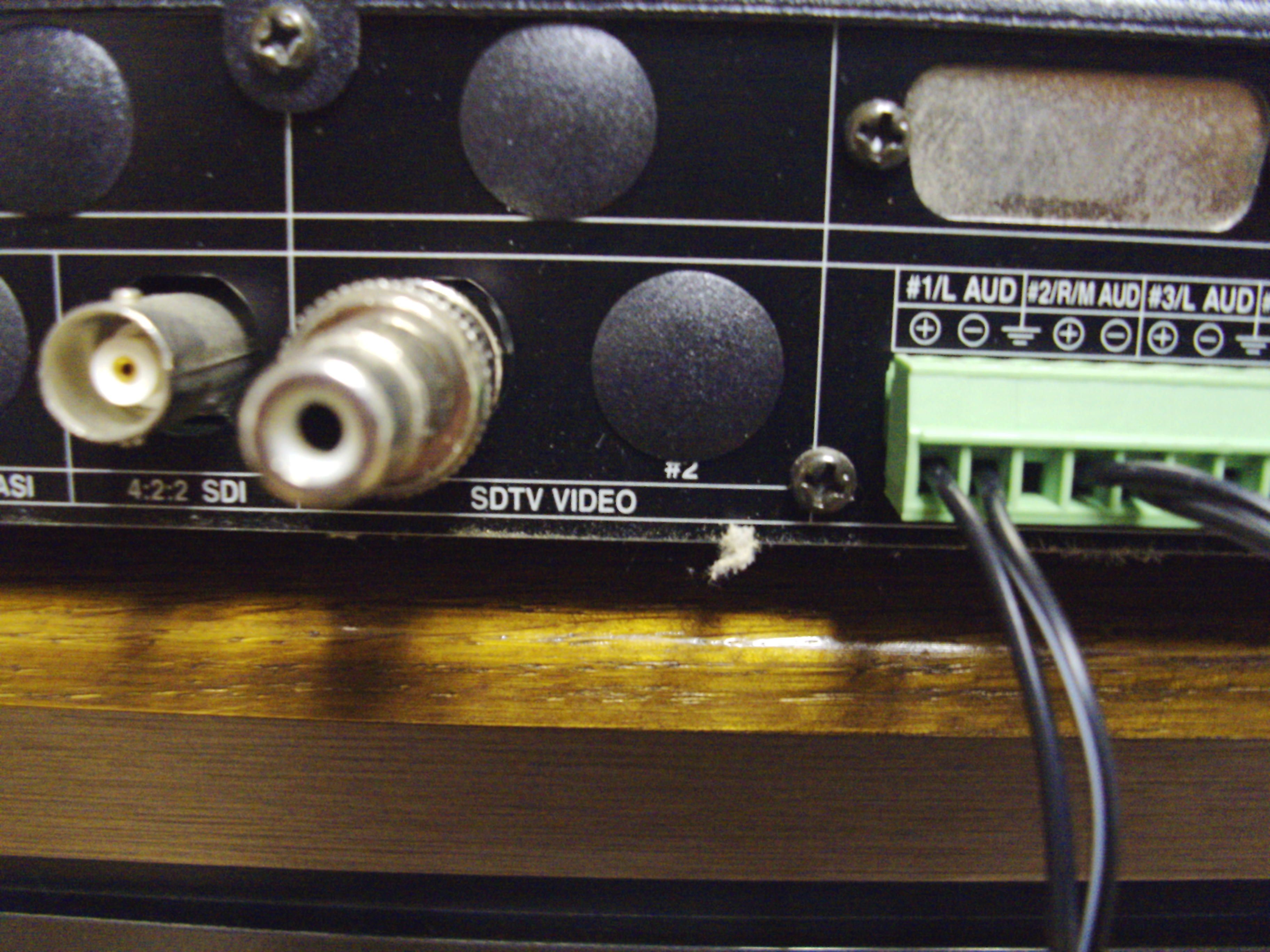

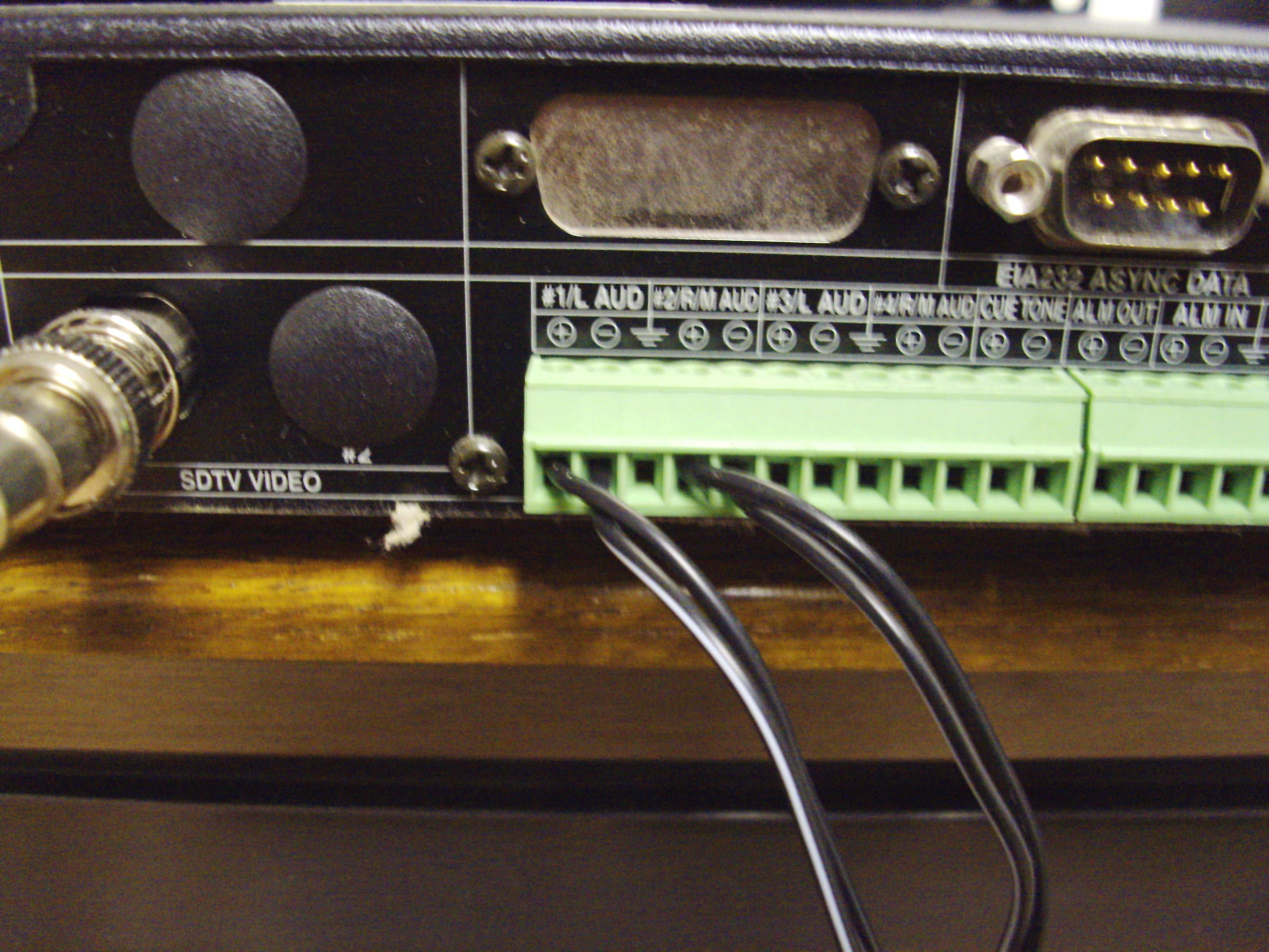

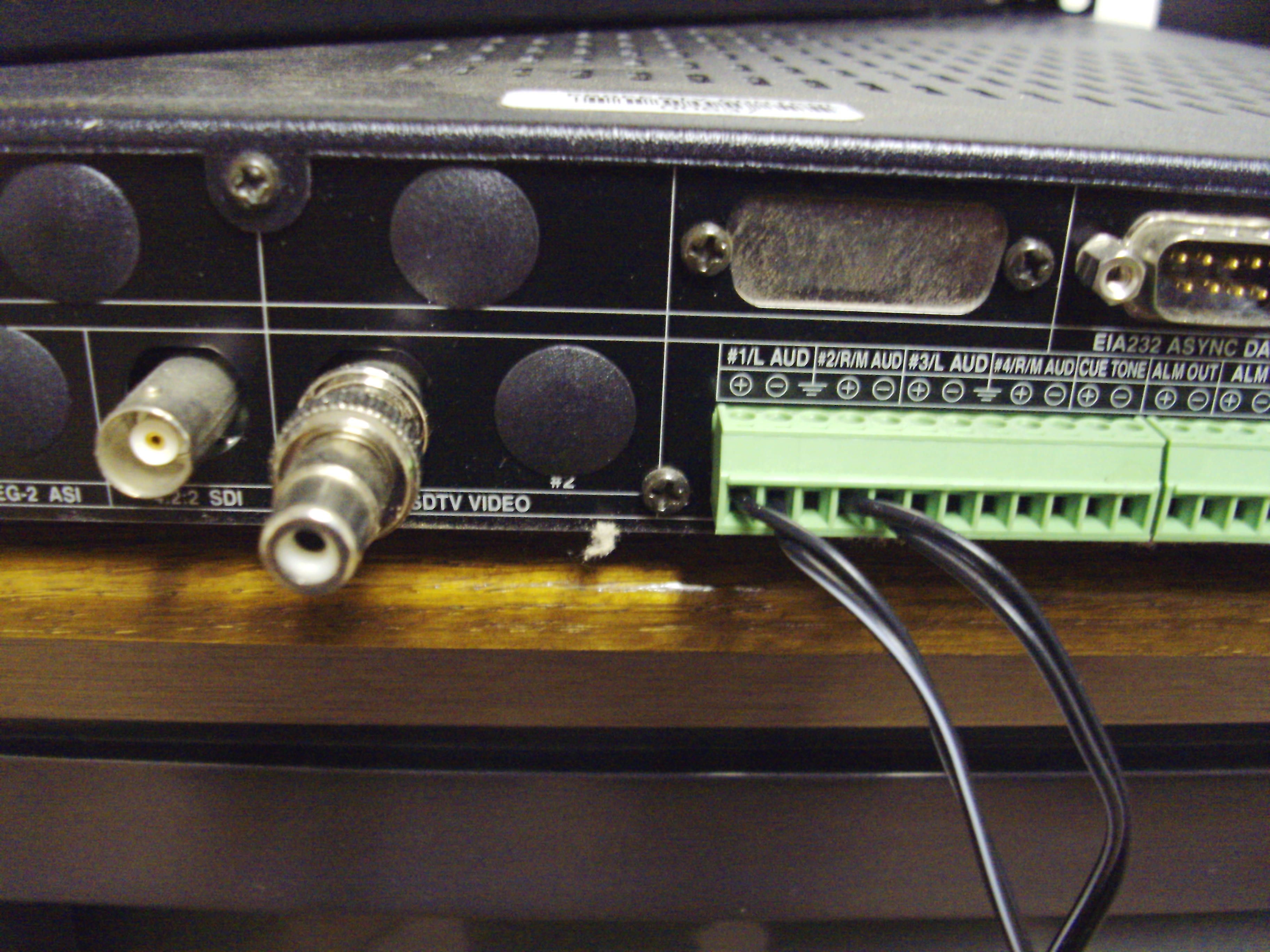

The audio is done via those strips. Its the 2 closest ones next to the BNC connector. I took an old speaker wire that had a rca plug on the end and split those 2 wires. One is positive one negative and plugged them in. That worked for the audio
Maybe I'll try and take some pics to show you. Otherwise check the manual. Here is the link

pics of mine.

so that will convert the audio ok? I would just hook that up to the yellow rca input? It has 4 bnc outs: Mpeg, 4:2:2, and 2 SDTV
yes it will convert the audio OK. Those strips are the audio outputs
I just use a yellow rca cable for the video and the 2 strips for the audio
if its the only conpleted one on Ebay you're missing the actual strips that plug into the green slots for audio. Look at my pics and look at the ones in the auction
You plug the wires into the green strips and they plug into the slots.

My GI 4810 (AKA Digitrans 7150) has the same green strip as the one he got on Ebay.
Does your green strip hold the wires in like a speaker terminal on a surround receiver???
yes. I use a small flathead screwdriver (like for tightening screws on glasses) to unscrew it and then put the bare wire in there and tighten down
