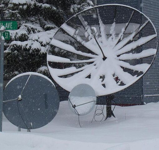

I had thought of that too. I just checked. I haven't looked at my 6' dish in so long I forgot how fine the mesh was. The 10' is bigger...but it is not like some I have seen....Won't do squat on Ku. Seems to me they say if you can get a pencil through it, forget Ku.
On the 6' there is like 5 holes under the penny and on the 10' it is just 3 1/2 or so.
What do you guys think? Do I now have a $20 10' C band dish?
Yep that is C band only mesh. You will notice not only are the holes large but that the surface is rougher than the tighter mesh on the Ku compatible 6 ft dish.
The mesh on my dish looks the same as yours. It works very well on C band, but KU was poor. A one meter solid dish performs much better on KU.
Your mesh is identical to mine. Ku performance was BAD. The .75m Ch Master did better. So I mounted the .75 on the BUD.

Um, um, I mean...Yes you are probably right. I for sure want good C and Ku, I don't wanna do it again. Back dish hunting...

Very interesting set up. Never seen anyone do that before. Would like to see a pix of how you did the mounting of the KU dish.
I've seen it somewhere...but not details and I think it was on top.
So Fat Air, all that snow and your location? Must be somewhere around Grand Forks, ND.
Yep, not too far from GF. I thought I posted details on how I mounted the little offset dish to the bud. But I can't find it, or the attachments I would have used. Maybe it's still just a notepad doc somewhere here. Will start another thread.
