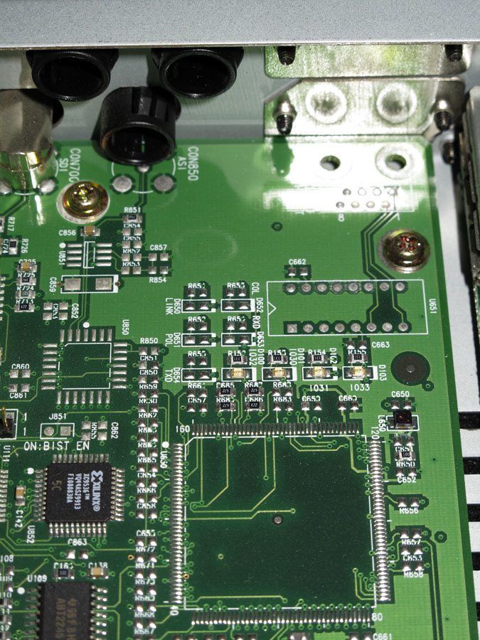

My DTE 7150 doesn't have an ASI output. Just SDTV and 4:2:2 SDI whatever that is. Can I add ASI to it?

look under the hood, you may just need to solder on a BNC. if the traces arent there let me know and ill get out the DMM and draw the circuit for you.
@photoman76
Here is a picture of my missing ASI connection. Looks like some chips are missing on the motherboard. I'm not sure if they are related to ASI or not.

the biggest missing chip is the network controller
DP83934 - SONIC-T Systems-Oriented Network Interface Controller with Twisted Pair Interface [Obsolete]
(putney's nemesis)
the two smaller ones are in circuit with ASI
u851 is CLC007AJE pdf, CLC007AJE description, CLC007AJE datasheets, CLC007AJE view ::: ALLDATASHEET :::
u850 is CY7B9234-400JC pdf, CY7B9234-400JC description, CY7B9234-400JC datasheets, CY7B9234-400JC view ::: ALLDATASHEET :::
plus some caps and resistors(if you want values let me know). need to take the board out to see the underside if you want me to trace the circuit.
it would be a herculean effort, some smd soldering experience would help. plus your firmware may not support it.
my firmware version is 0262-0423-0198-0240
Thanks for the info. It's beyond my capabilities. Probably cheaper to wait for another one to become available with ASI. Everyone is switching to DVB-S2 anyway, so it doesn't make too much sense to invest in it any further.
