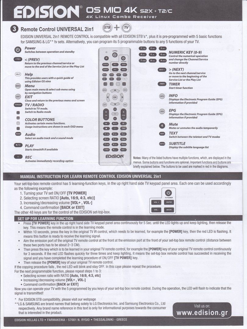

Info with the remote says compatible with Samsung and LG sets. You have 5 programmable keys marked Power, Vol+, Vol-, Ratio, and Back.
I have a Samsung. I programmed the first three keys as labeled. The Ratio was programmed as the Video Size key and the Back button I set for the Sound Mode. I was curious if anyone got a different brand to program and/or what you programmed your buttons for.

Where do I find information on how to program these keys to control my TV?
Read this

Thanks guys for the great info! My Visio's power on off worked out of the box. I now have a 2nd Mio and this got the Insignia's power button working. Also programed a button for input\source like Magic suggested. Also "enter" for another so I don't have to wait for the Insignia to switch sources
Thanks again
Reactions: primestar31
Thought I would report back with an update. I run one of my Mio's audio through a Onkyo AV receiver. I was able to program the mio remote to control the volume up and down on the Onkyo. On my other Mio I run the audio through a Yamaha. Was also able to program the Mio remote for the Yamaha's volume. Sweet!
Power button still operates the tv. Ratio is now inputs on the tv.
