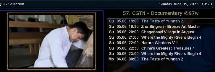

I successfully got an EPG for CGTN documentary. The start/stop times were in milliseconds, which took me a bit of time to figure that out.
Code:
Example :
startTime	"1654430400000"
I wrote a couple functions to convert milliseconds to date/time and back.
Function : ms2d = (milliseconds 2 date)
Function : d2ms = (date 2 milliseconds)
Code:
? ms2d("1654430400000")
6/5/2022 8:00:00 AM
? d2ms(#6/5/2022 8:00:00 AM#)
1654430400000
After i got that figured out, the rest was easy.....
