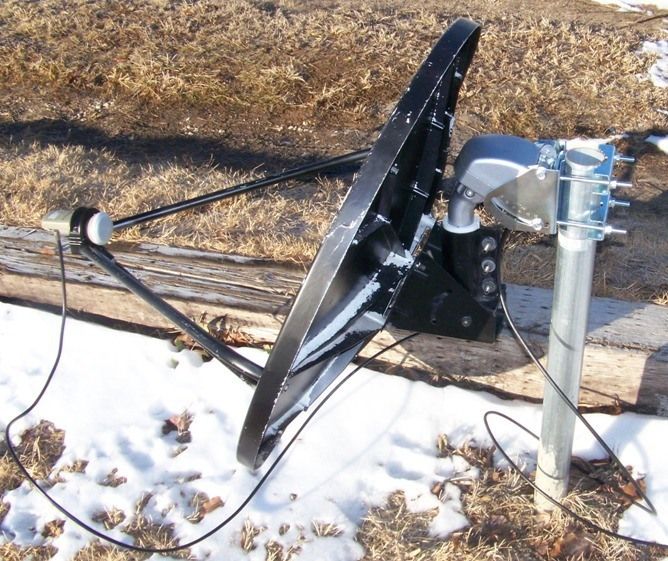

Well, it is not pretty, but it's up. And I got it up in the dark. And it moved. I think my pole is a little short(no jokes please) and I think I might hit a railroad tie if I to over to G10R.
I will post picture tomorrow....
So here is the picture.
BUT, I need help. I have the Traxis 3500 but I do not know how to get USALS working. Anyone have suggestions?? I put in the lat and longitude and I am on 97 which is my true south, but I don't know what to put on the limit part.
My first thought was "boy he's got that awfully low to the ground" I have a C band dish 10 footer. I dont use USALS. On that my limits are set according to how far east or west I can basically see. I have the east at 72. I haven't tried to look any further east. The west is at 137. I'm guessing this is what you are setting but, not sure. I don't have the Traxxis either. You might want to move the dish manually and make sure you can see all sats that you want. It could be a situation where you will want to "get your pole up":D
It is low, and I think I am slowly getting it figured out. I am moving and scanning most satellites, but SBS6 still eludes me.
Dumb me, I didn't have the elevation on the motor set. I just put the dish on it, adjusted until I got signal and forgot about motor elevation.
Special Thank You to IceBerg!!
