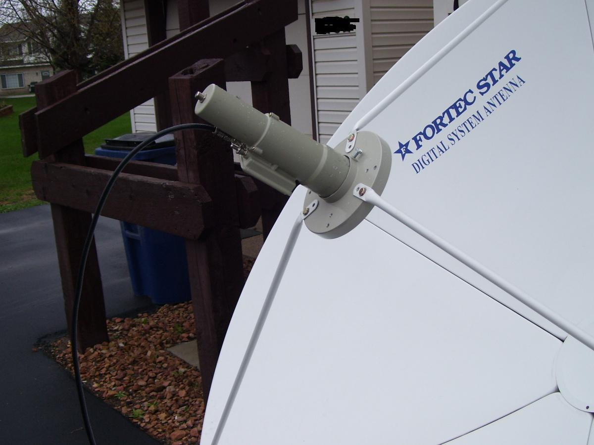

I have regular scaler rings on both of my 6 foot dishes. One has a bandstacked LNB on it and the other has a 621-2...the 621 fit real snug into the scaler ring but works great :)

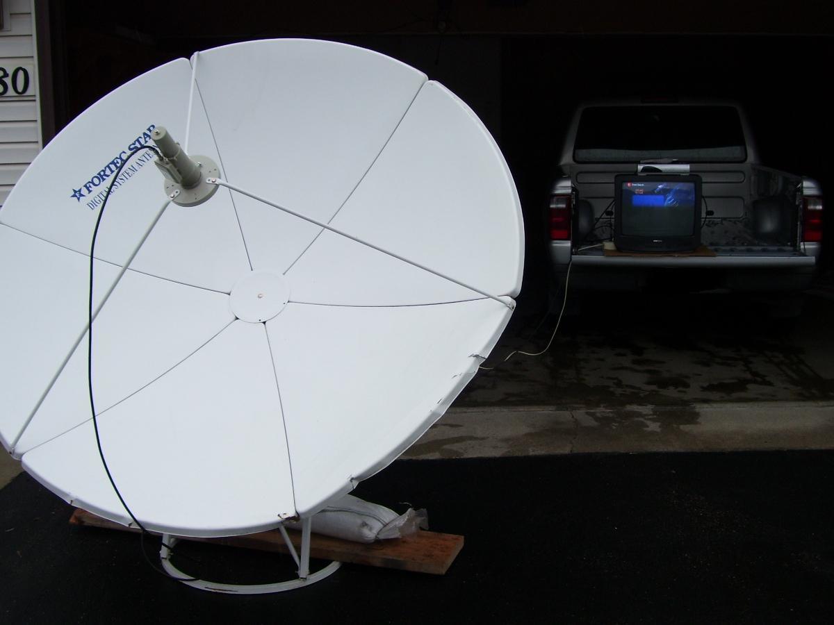

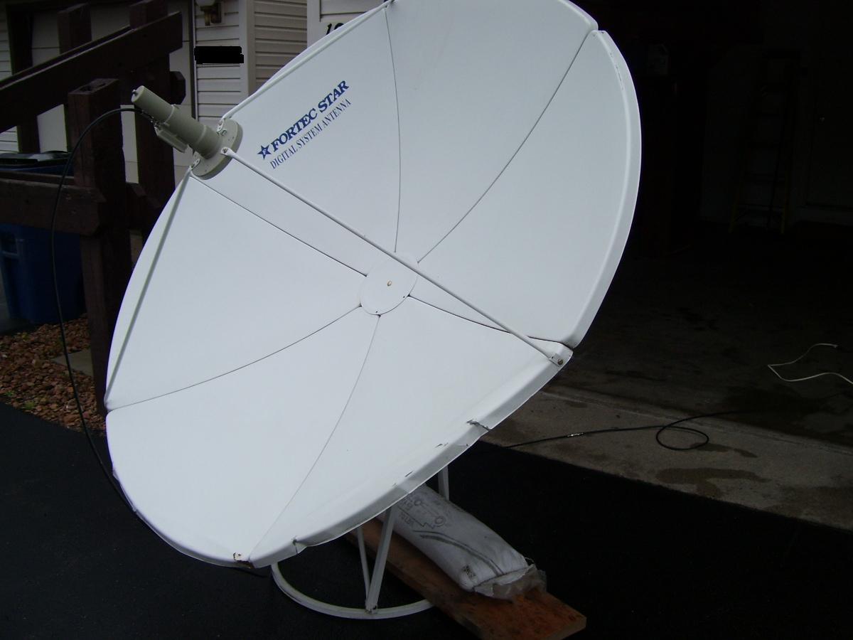

lemme see...since one is ghetto moved in front of the garage here are some pics
yes the dish gets moved out from in the garage and aimed. This is due to bad line of sight for the fixed dish on the other side of the house

In both setups the scaler rings are just stock units that came with some old LNB's...got them off Ebay a while back...a bunch of LNB's and scaler rings.
Nice part with these is they are heavy duty and they have a good screw to tighten and keep the LNB in...bad part is its a hex key...no biggie if you're motorized or have a fixed dish. But if you ghetto move the dish like I do...well then I had to take a trip to the home improvement store to get a hex key....or is it an allen wrench....I forget
