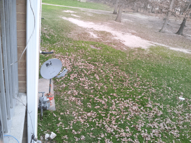

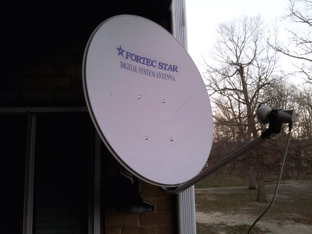

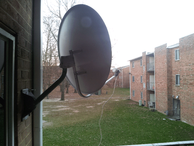

I have attached the pictures am also in the last picture my neighbor has direct tv installed.

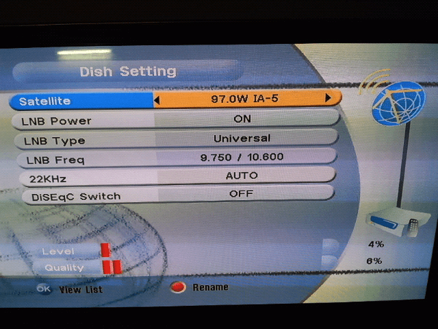

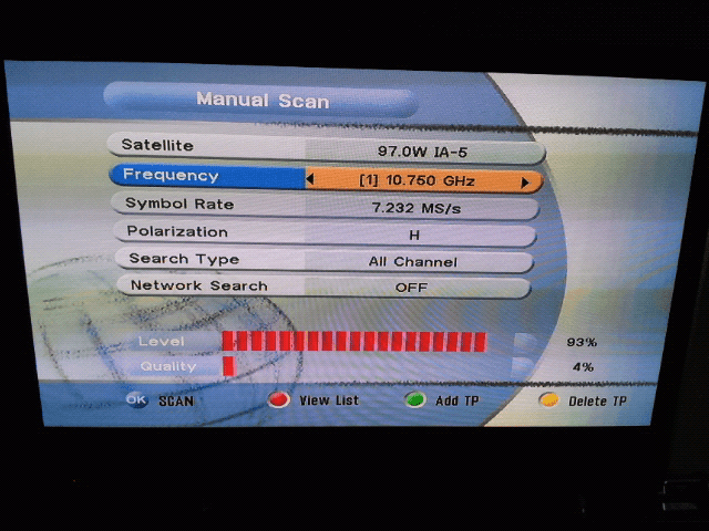

You need to show us a picture of your Antenna Setup (not sure if that is the right name in your Coolsat) screen.
That is where you would set your LNBF to 10750. This is assuming that your LNBF is a 10750 standard type, that info should be printed on there somewhere, please verify that.
You have the transponder frequency set to 10750, that is not correct.
You can go here to get transponder parameters that are active.
http://www.satelliteguys.us/thelist/index.php?page=97+Galaxy+25

Is your LNBF a standard or Universal? Most likely it is standard, but could be the other one, not knowing what the installer did. If it is standard you have the wrong IF Freq. set .

coolsat 6000 premium, OK. What are the numbers on the LNBF on the front of the dish?? Got to know in order to program your receiver correctly to get a Quality reading. These have to be right to see anything:
LNB type and L.O. (frequency)
Transponder Frequency, polarity and SR. (Must be active, 24/7, unless you know when an itinerant transponder is ON)
Without these being correct, there's nothing to tell you that you are aimed at a satellite.
