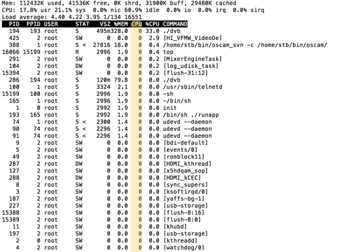

I just tried the 'top' command on mine. The 'CPU' field is the core identifier and the '%CPU' field is the percentage of time that each listed process is using.
The 'CPU' field is always 0 because it appears that only a single core is present. If there were two cores, some of the listed CPU identifiers would say '1'. But they're all '0'.
This appears to be a single core and not a dual core like I posted on Friday. I was looking at the specs for the Hi3712 here: http://www.hisilicon.com/news/news/20130926.html I saw the 'Dual-Core' but that was for the Hi3716 listed at the top of the page. We have the Hi3712 single core. Sorry I made that mistake. :sorrysign
Here is the 'top' display screen. The highlighted column is the CPU identifier which is always '0'.

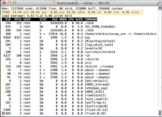

Thanks Fred. I telnet'ed into my HDVR3500 and got the new display as you suggested. I highlighted the single core in yellow:

A few weeks ago during a Telnet session to find out why the RCU response was sluggish on a sample unit provided by Satellite AV, toggled between CPU 0 and CPU 1. This is really bugging me... Headed back to the shop to remove the heat sink on the sample and also grab a new unit out of a master carton to test.
Reactions: . Raine and rodder
Ack! It looks like you are right, single core. I was looking at the ID column and % column and thinking two cores. :(
Could it be two cores and one is disabled at the moment, to be enabled in future firmware? A single core for the streaming features seems foolishly optimistic, especially with the low ram. :(
