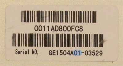

So the '41' on your info screen matches the '41' in the 8th and 9th positions of your serial number.
My STB info screen serial number (shown in post #159 here) matches the 8th and 9th positions of my sticker too '01'. I am not 100% certain if the 2 digit matches are simply a coincidence or consistent among boxes. Doesn't really matter though.
As for the hardware configuration, the only connection I have found so far is that my model number 'HW_VFD_N256_DDR256_1' contains the amount of flash NAND and DDR3 RAM (both 256 MB) which is confirmed by the chip labels.
