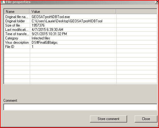

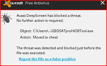

Avast antivirus quarantined it when I tried to run the Database Manager, trying to figure out if it's an issue or just a false positive:

Ok, I don't think this is actually a virus, almost sure it's a false positive, but it definitely isn't working quite right.
Now on the third try, it's opening and seems to be working without setting off the AV:

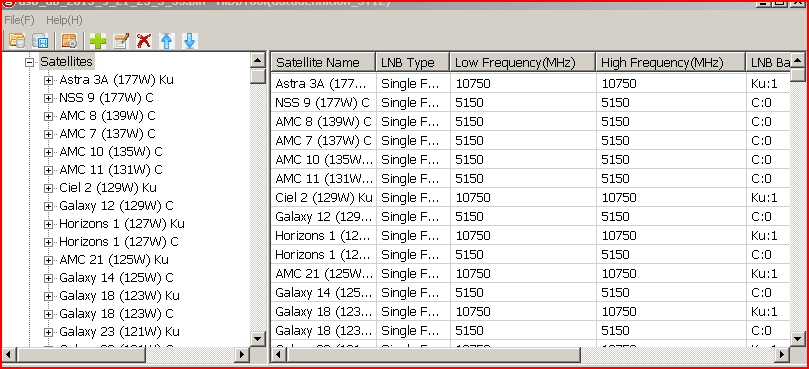

A little sloppy code, maybe? This will be nice, will make life easier. I'll probably play around with it tomorrow, little late tonight.
Seems that it didn't like the call to create the burnconfig.ini for the template path to the xml, so just a false positive. Maybe include a config file with the zip?
