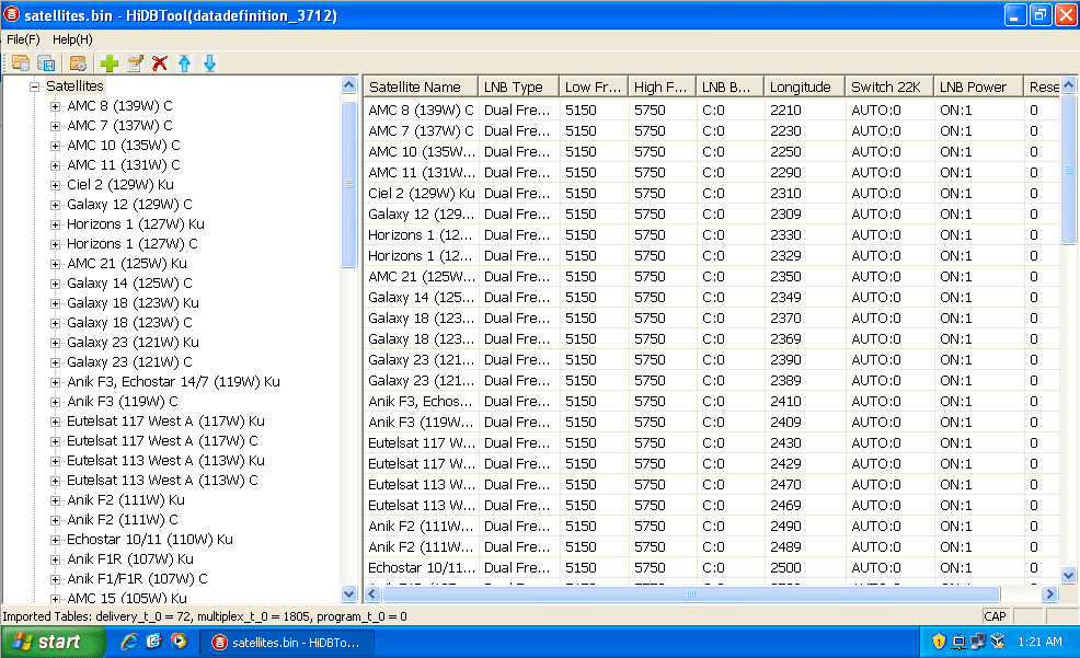

Don't know if this a bug or not, but when I open a satellite list that is a XML file, and save it as an XML file, and close the app, and try to reopen the file, it has moved all the satellite to the terrestrial category... if I save it as a BIN file it seems to set all satellites to c-band, (my list was ku-band only) and the LNB to dual 5150, so I have to re-edit them 1 by 1...
My file downloaded from the receiver seems to be OK, unless I delete satellites or add a new one, the I get the mixed up list like was mentioned in an earlier post, but mine seems to correct itself after powering off with the switch on the back of the receiver.
I was also wondering if sorting by satellite, transponders, channels, etc (similar to what Channel Master used to do) can be added to the editor? Also an option to change all the LNB settings for all or selected satellites.

Oops, I told you wrong it was placing them in the Cables category... playing with the satbeams file now, same issue made the Ku C-band...
