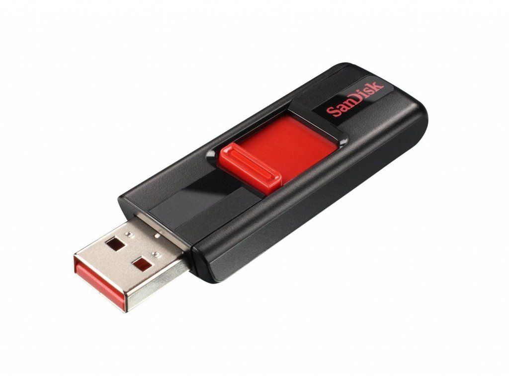

I switched out the 16GB internal drive with a Sandisk Cruzer 32GB I had laying around. I removed the plastic cover and the bare drive is the same size as the original drive so it fit perfect. So now I'm going to see if I can find a 64GB or larger drive made by them with hopes the internal board is the same size. This is the older style, so I don't know if the newer design will be the same size or not.
THANKS!
You can also use an extension cable
USB 2.0 Extension Cable Type A Male to Type A Female 6 ft, Black Amazon product ASIN B00182CIB8

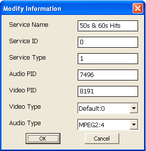

What settings should I be putting in the boxes for the radio channels on 103W in the Channel Editor? If I remember correctly, they are all MPEG2 audio. My old notes showed 8191 as the Video PID, so I'm guessing that setting is correct, and I know the Audio PID is correct. I think service ID is supposed to be 0, but not sure about service type or video type. THANKS!
