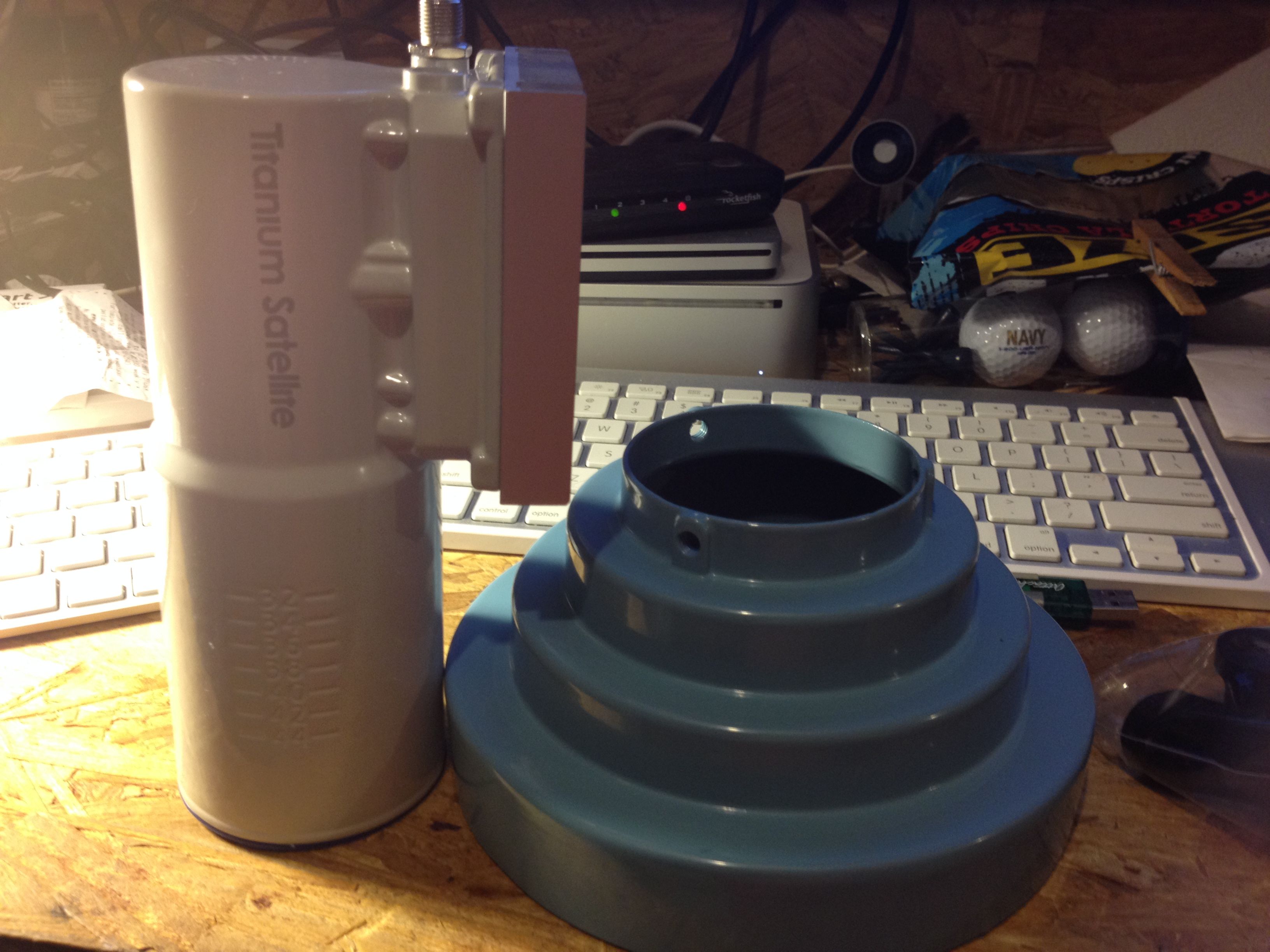

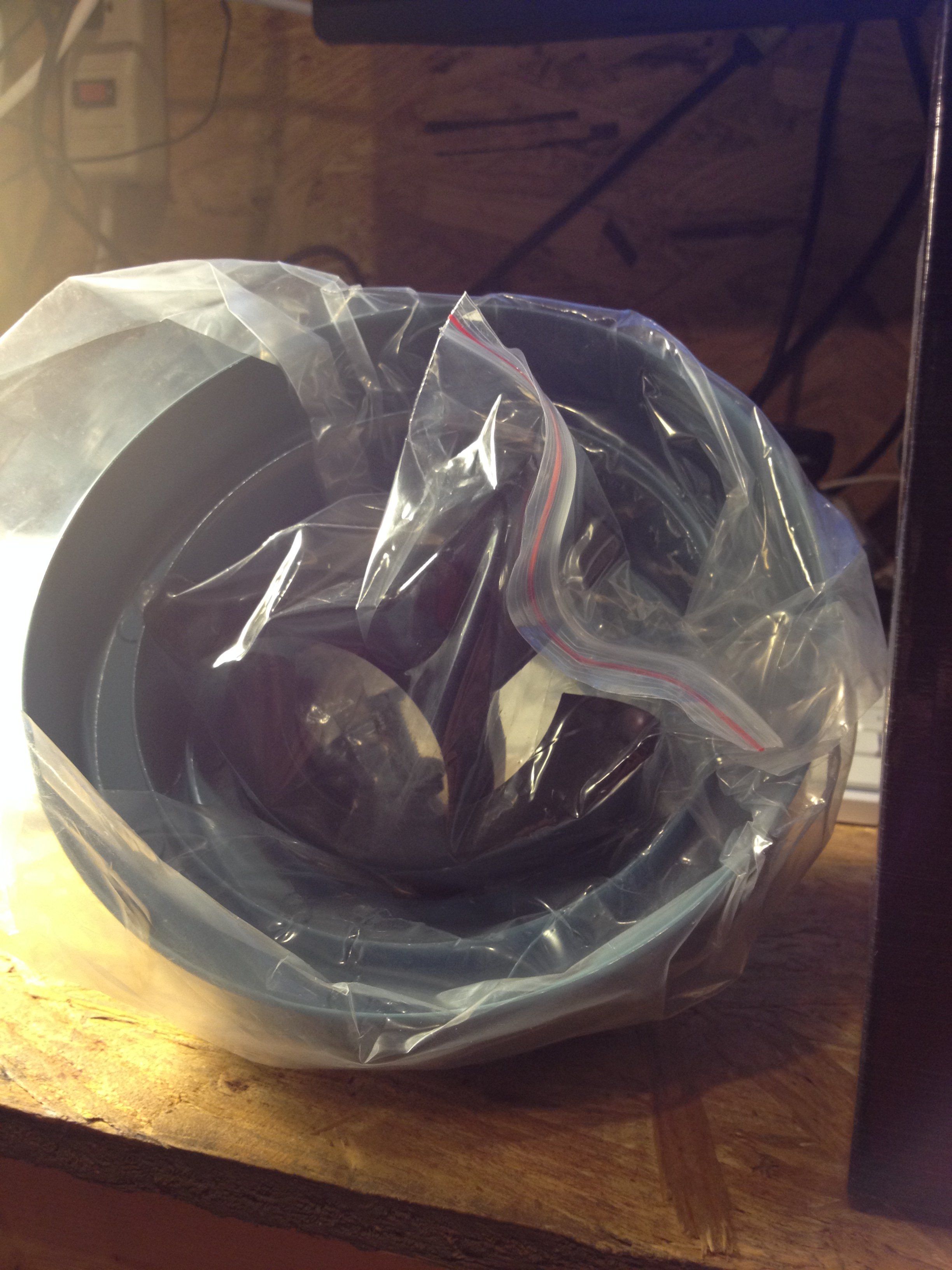

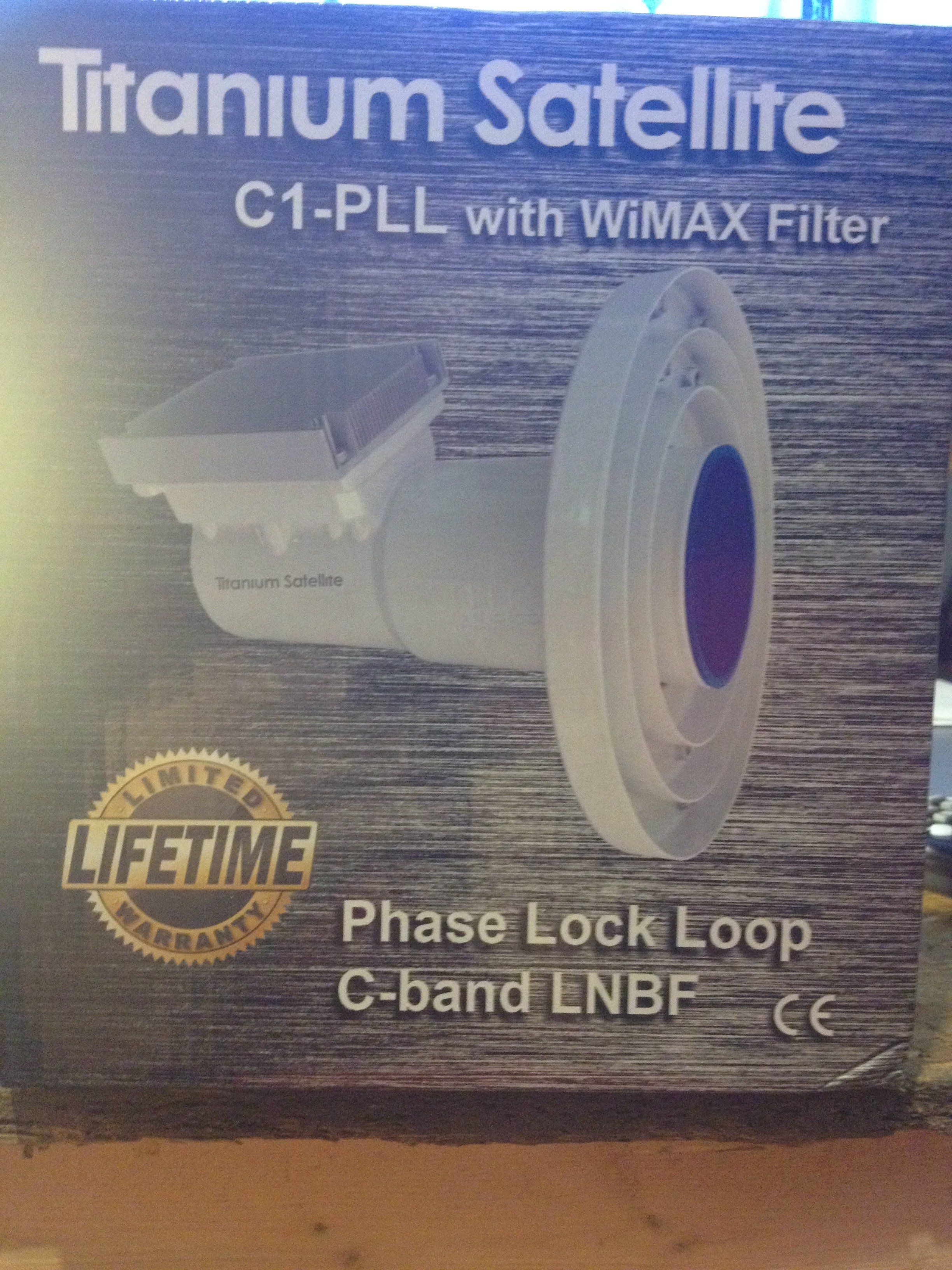

New toys have arrived for addition to my GEOSATpro HDVR3500 setup. Titanium Satellite C1-PLL with WiMAX Filter (C-band LNBF) & Conical Scalar Ring. Looks like tomorrow is going to be a fun filled day of experimenting ;)

I have had one of the C1-PLL LNBF's for about a year. I previously had an old polarotor lnb. The C1-PLL made a big improvement in my signal strength and even more for the stability and consistency of my signal. I hope that you receive as much improvement as I did. Oh, and it also allowed the automatic change from V to H channels with my simple system.

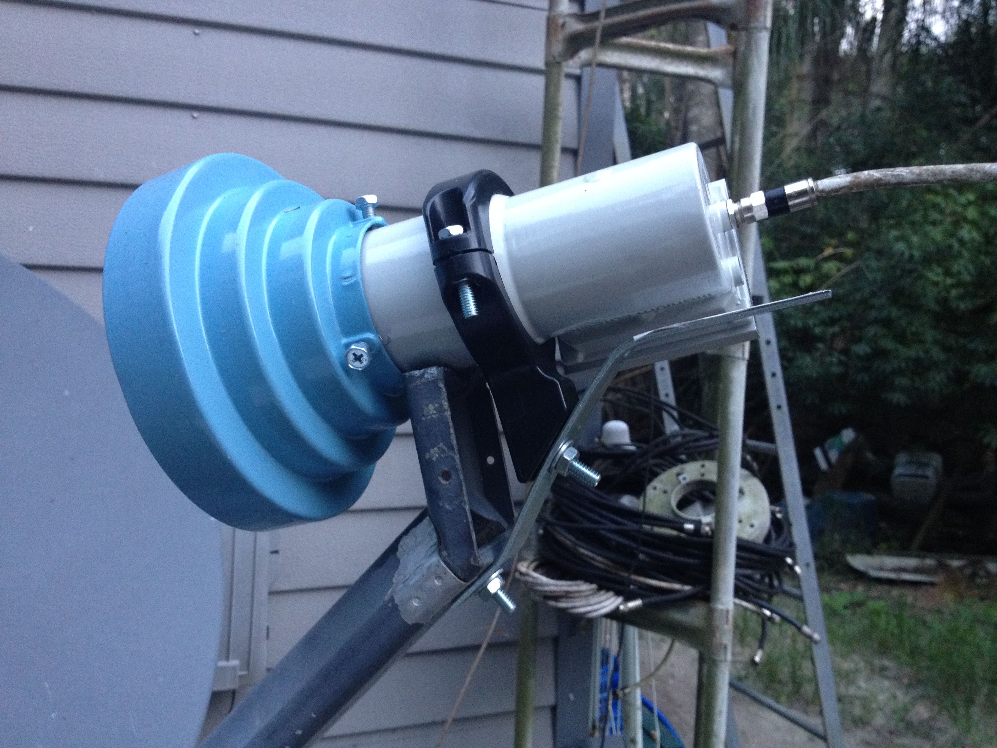

No luck with 99W C-band with my 3ft dish, had 91% signal, but could never get above 10% quality, so that's not very useable. Unless someone knows of a satellite which may have stronger transponders than 99W. I was thinking about trying 85W or 103W before I totally abandon. Or maybe try to get the Music Choice channels from 125W. May just have to go back to using the old Primestar dish, since I had good luck before picking up 95W, 97W and 99W.
I also retrieved an old 6 or 7ft dish that was lying in the woods for over 10 years, appears to be fiberglass, but it is damaged, has cracks around all the bolts where the mount on the back is, probably due to a tree falling on it during the hurricanes several years ago. Otherwise the dish doesn't look too bad. Has an arm that comes from the center to mount the LNBF on, and appears to still be straight. There is an old Chaparral LNB on there, but it is so corroded I'm sure it's dead, not even going to try. Thinking about removing all the old metal and trying to repair using automotive fiberglass filler, sanding, repainting, and maybe come up with a different way to mount, maybe reinforce the rear damaged area with an old 3 ft dish I have, and build a new mount. Probably just make it stationary just for one sat.
The experiment continues...

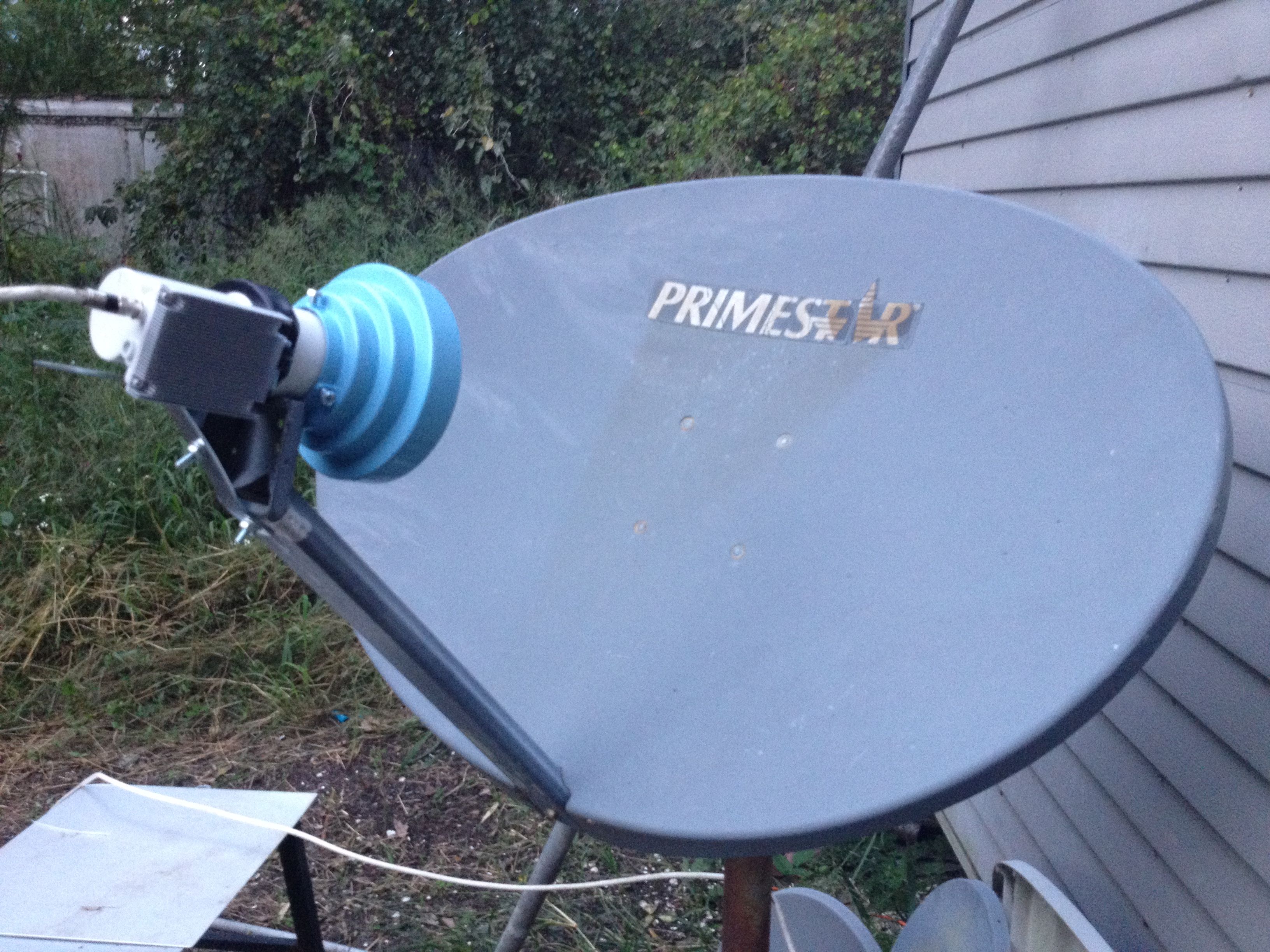

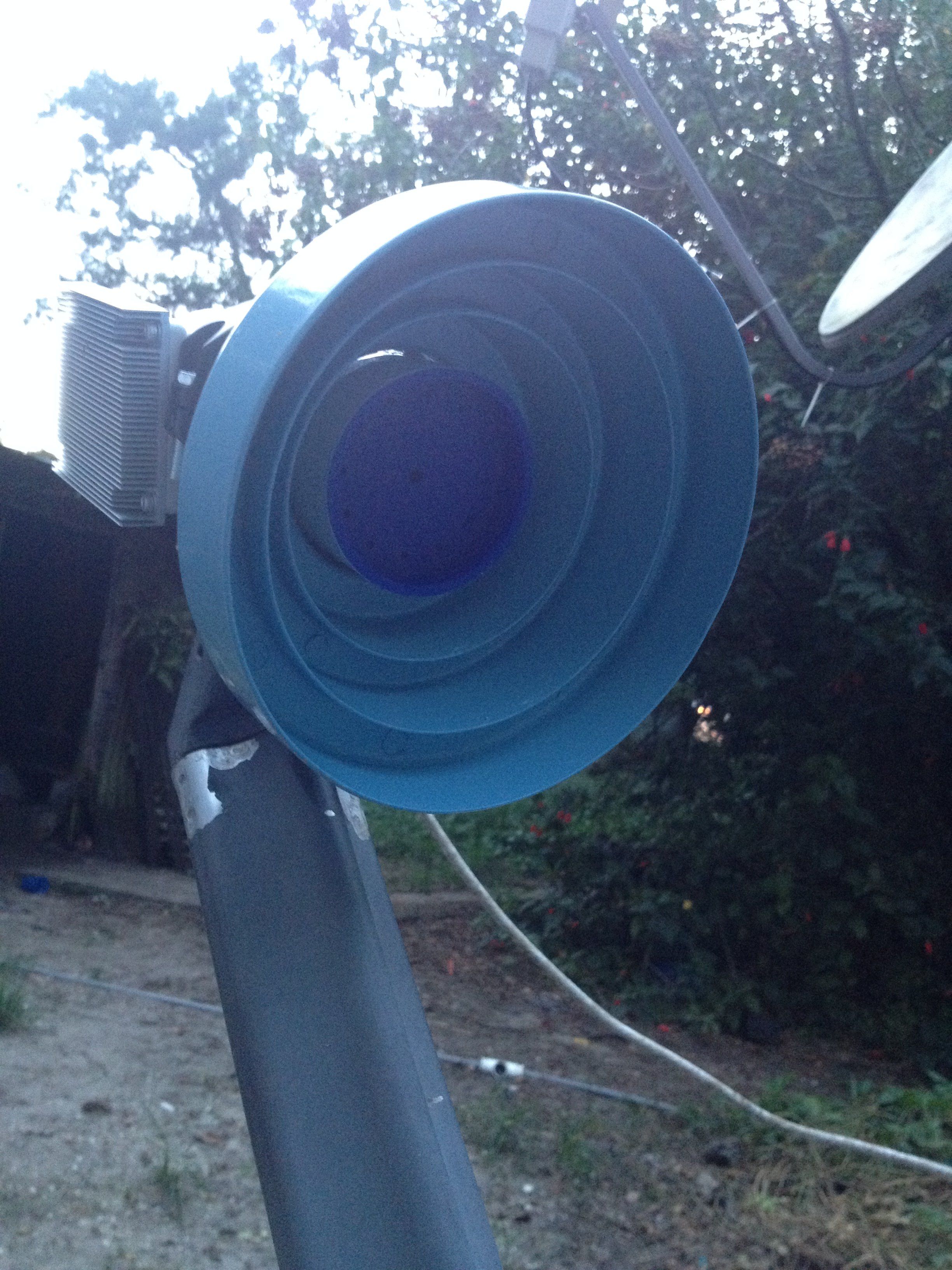

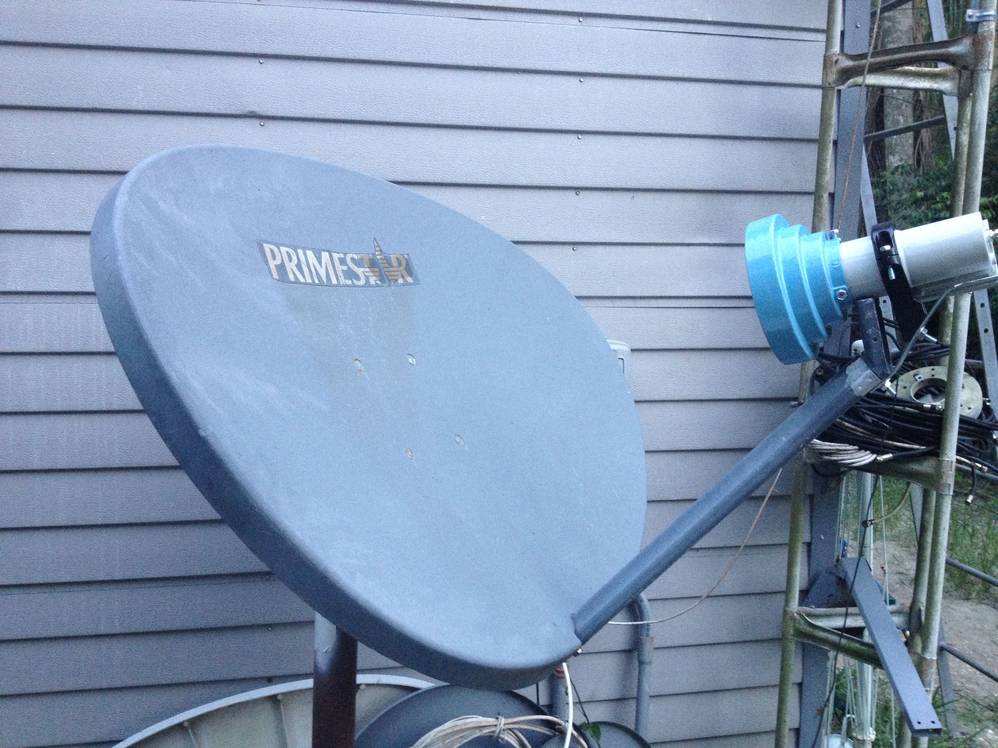

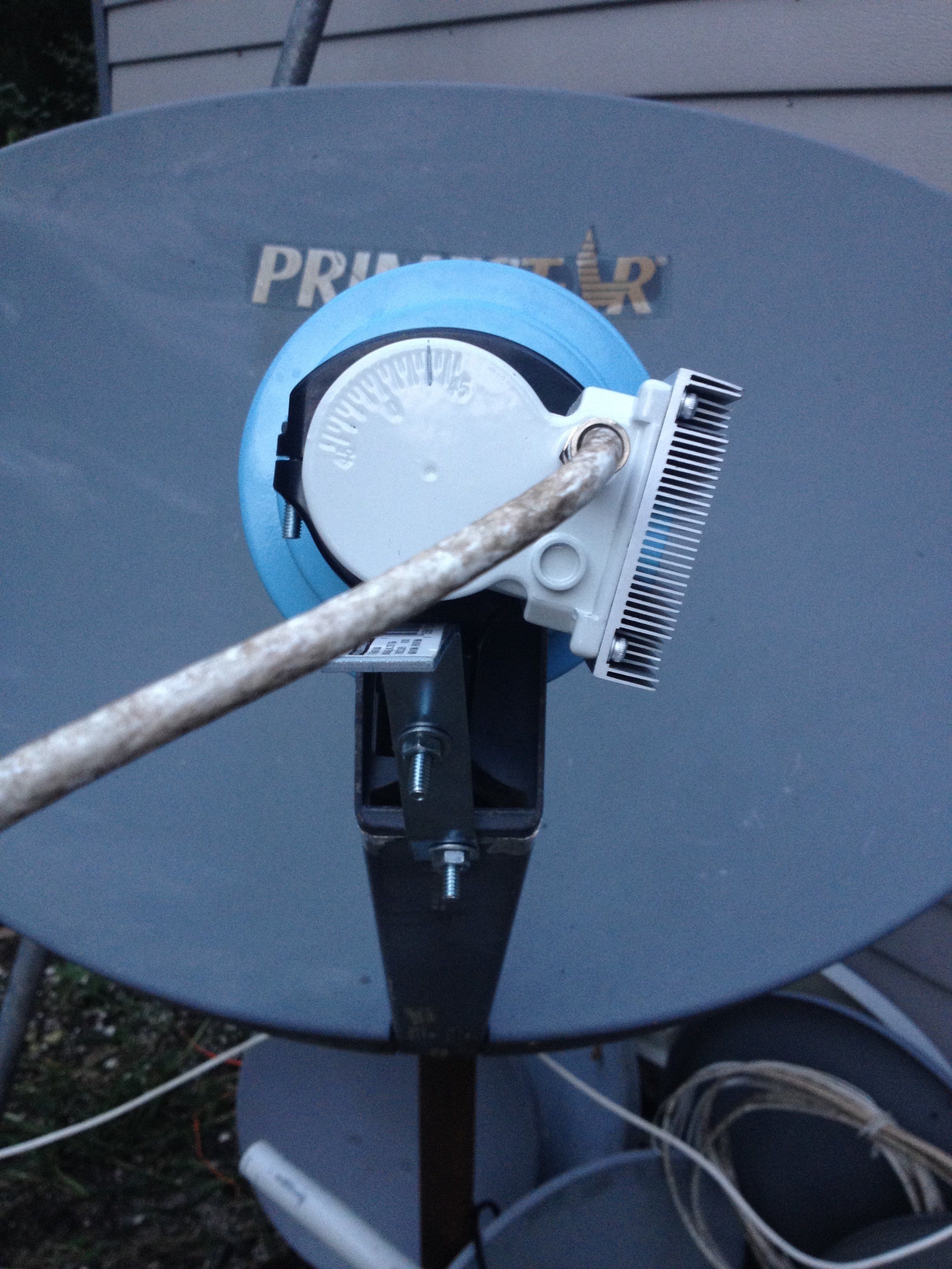

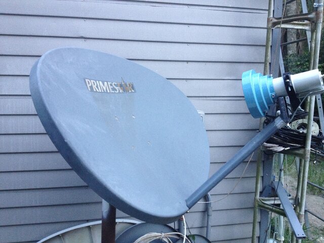

Gave up on trying to use my 3ft dish, went back to the old Primstar and was able to lock on to 97W and get 13 channels, AMG-TV was one I really wanted, we used to have a low powered UHF TV station here that carried AMG, but they still haven't moved to digital yet (although they have applied to renew their license), and most of the time it's just a test pattern now...

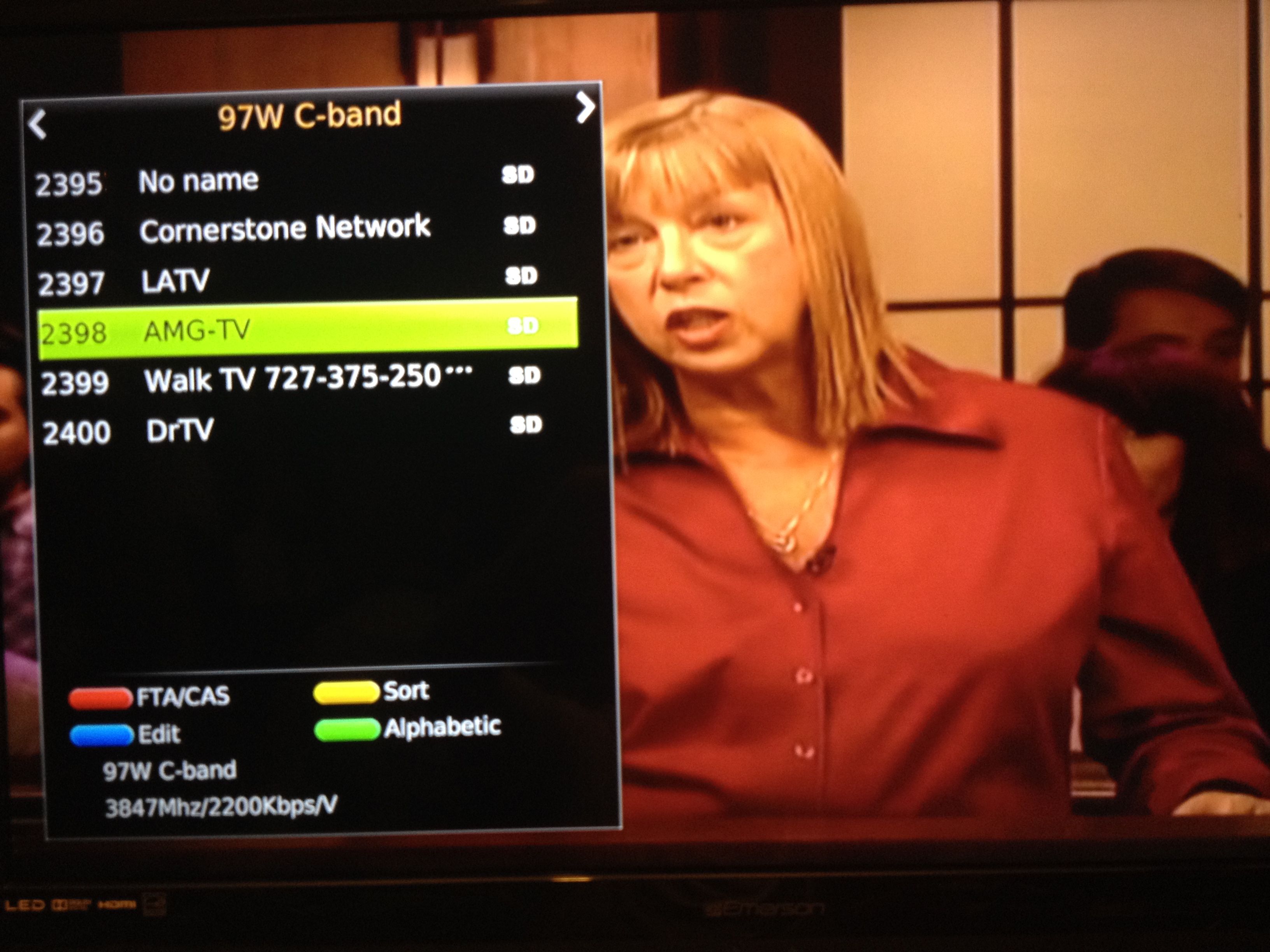

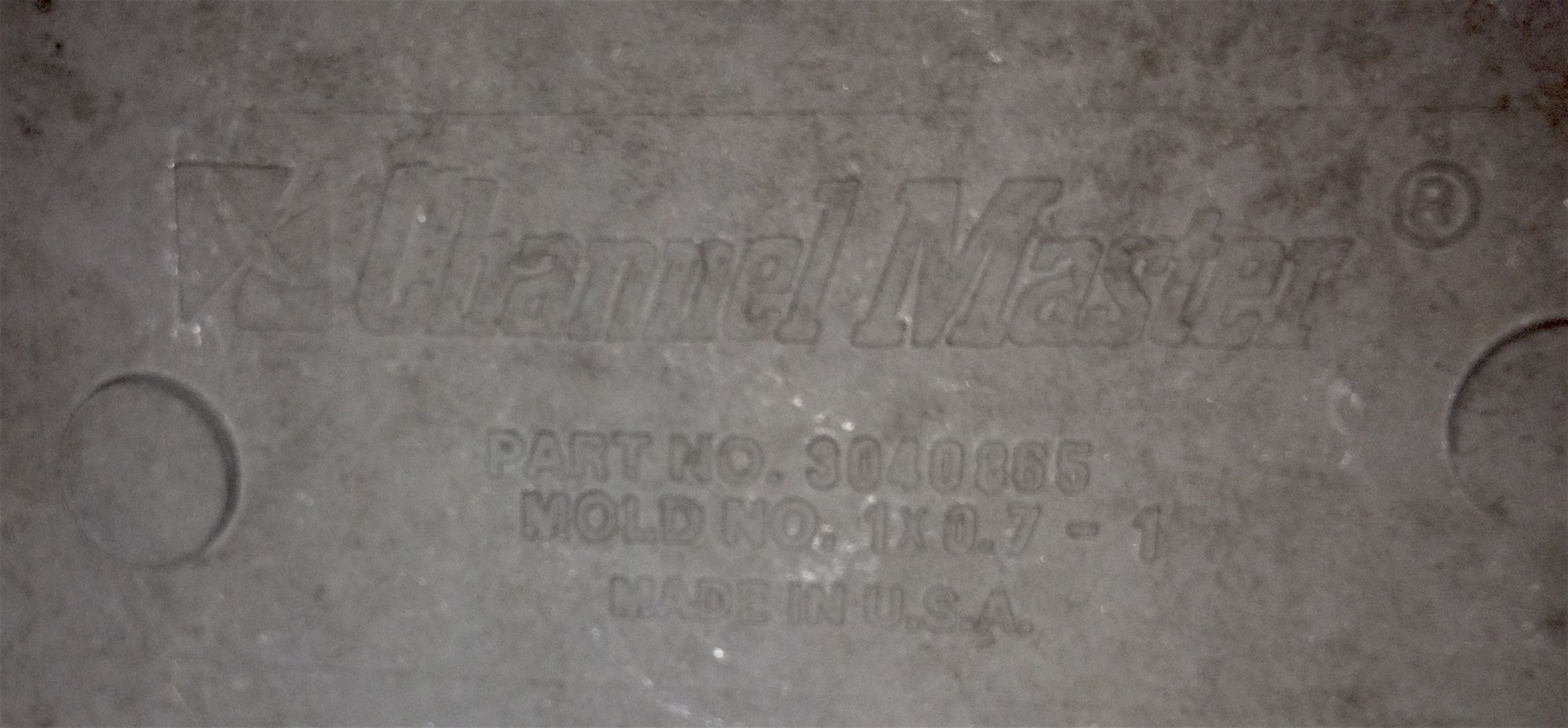

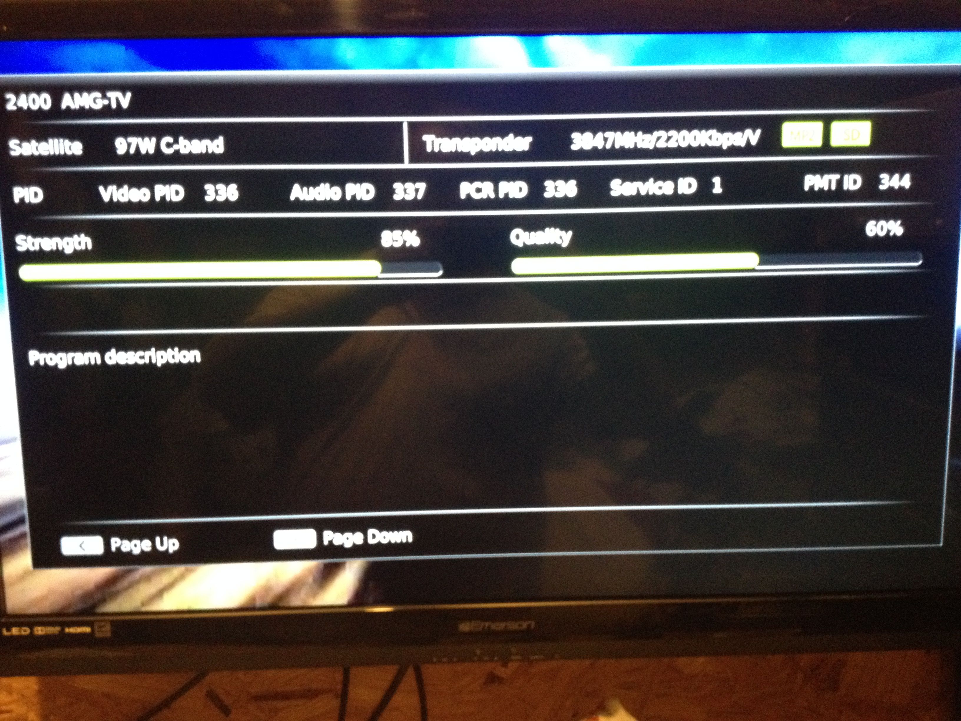

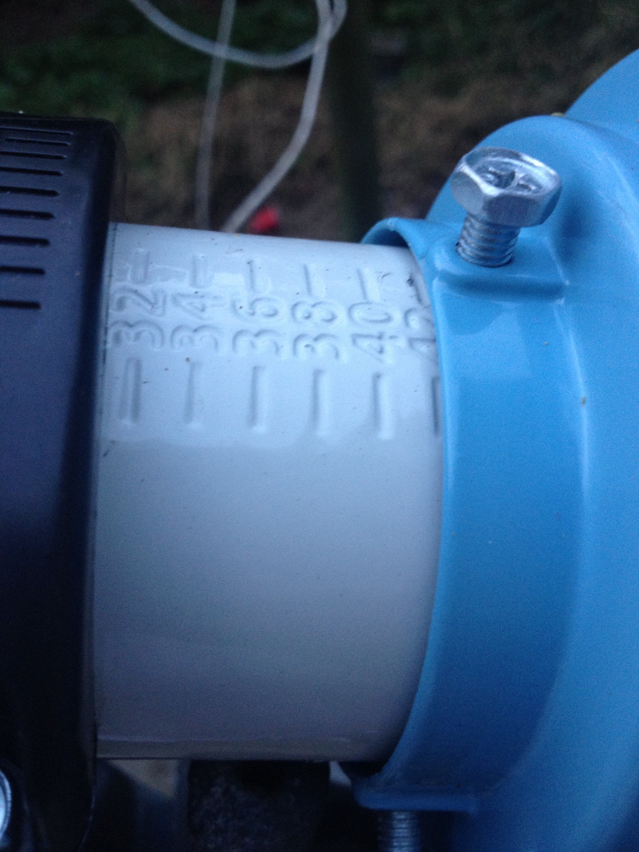

Not bad for a small dish. It is marked on the back: Channel Master, Part No. 3040865, Mold No. 1x0.7-1, Made In The USA. 85% Strength, 60% Quality on AMG-TV, that seems to be the strongest transponder. 3847MHz V 2200Kbps is what it scanned in as. Video Pid 336, Audio PID 337, PCR PID 336, Service ID 1, PMT ID 344.

These are the channels I ended up with after tweaking the dish, all channels have 45% or higher Quality at the moment. The other channels I was getting a weak signal from was from 99W. I still want to try and tweak some more over the weekend. The "No name" is BVOVN (Believer's Voice of Victory Network).
