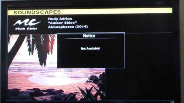

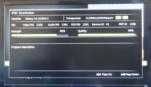

On a music channel with video, a message periodically flashes briefly on the screen saying 'Not available!'. Seems to happen about twice a minute. Let me know if you need more details. The music plays fine, and I can't detect any sound glitches when this happens. Here are screen shots showing the message and the signal strength (which was strong):
Haven't seen that message on the Music Choice channels. Does it happen on all MC channels or specific ones? Using time shift or DVR? Try disconnecting any external drive to test. The video bitrate is so low that the STB may be detecting that there is a loss of video.
Happened on all channels that I tried. Wasn't using an external drive. Even disconnected the network and tried all the time shift options and still got the warning message.
I have seen a box appear for a split second and go away but had never been able to determine exactly what it was.
Now I know.
This only occurs on the music choice channels so far as I know.
