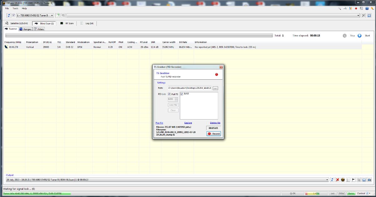

Recorded a .ts of the 125w MC transponder and posted it for their review. Anyone who wants to grab a transport stream to document any problem that they spot , I am using EBSpro with a PCIe TBS 6983 card. Right clicking on the transponder to select TS Grabber, then recording 4 or 5 minutes, win zipping and posting on the mega file hosting site. I then let Eugene know the url to retrieve the .ts file.
