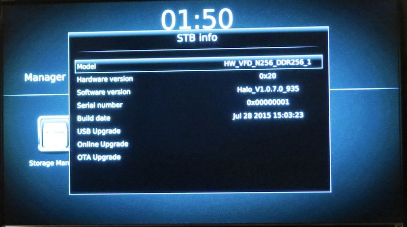

Sorry, only 256MB RAM. The RAM and flash specs in my previous post are what I have. I looked in the box shortly after I got it and was a bit disappointed to see that it has a Hynix H5TQ2G63FFR DDR3 chip (2 Gigabit) and a Hynix H27U2G8F2CTR NAND flash (also 2 Gigabit).
2 Gigabits = 256MB.
Here's a photo of my STB info screen which confirms that in the model number containing 'N256' and 'DDR256':
