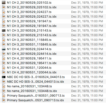

Hey Eugene,
I discovered something today when I was accessing my recordings on my computer.
All my recordings since updating to firmware 1339, show a date of December 31, 1979, but the end of the filename shows the correct date
And when I set the recording time using the manual function, it doesn't stop, it just keeps recording. I have to stop manually. I also tried to record from an audio channel but it didn't record anything, even though it showed the LED blinking on the box, and pressing info showed it was recording, but the time was 00:00 and never changed.
I tried doing a factory reset, but still the same results.
Other than that, I'm having no problems that I can detect with anything else so far.
Thanks!
Hey Eugene,
Thanks!
I have the same issue with recording. It never stops recording. I'm using firmware V1344. Any ideas Eugene?
