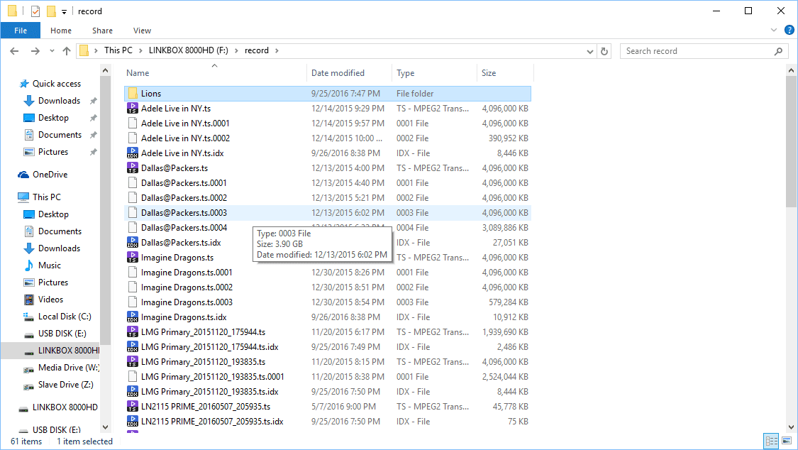

Today I recorded to external drive a 3hr .ts file using this firmware. Played back looked just fine. Attempted to rename the file to keep on the hard drive and the file became unreadable after the rename. No longer a .ts file. Will no longer play after rename attempt.
You have to rename both the .ts and .idx (index) file. Index file is the one that tells the receiver which file to play
Best practice is to have both files renamed. Make sure your browser is set to see system and hidden files.
Let me know if you were able to fix file name.

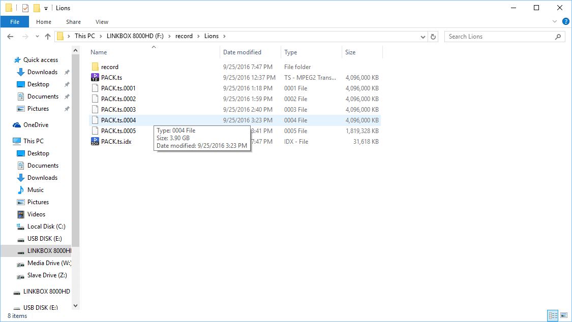

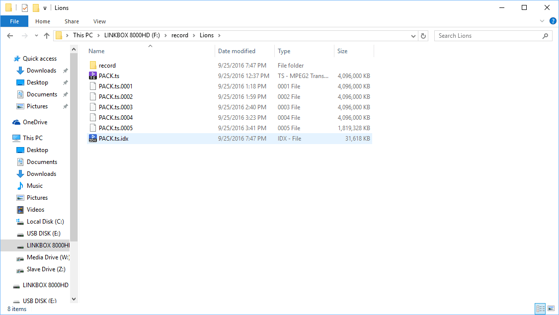

I was attempting to edit/rename the file using the GeoSat 3500. I never remove the hard drive(via usb) from the rear port of the 3500. I can't do anything to the file I tried to rename. I was going to plug it into my computer just to see if the file is still there. The file won't play now on the 3500.
I plugged the hard drive into my computer and here is what the 3500 had done to the file when I renamed the recording. It made a folder called Lions(which is what I was going to rename it) and when I open the folder called "Lions" on my computer it contains the recording, but was not playable from the 3500 when I try to click on Lions. This has never done this before as you can see I've renamed recordings before using the 3500 to rename.
Note: The drive is called Linkbox 8000 because that is the receiver I had before I got the 3500

Its seems that every 41 minutes the HDVR3500 stores 4 GB of recording. Thats about 6 GB per hour! If its recording the entire mux, it would be more space efficient to filter the stream and store only the program being recorded.

What was the recorded content?
I believe the issue is in the renaming of the recording there was an interruption that did not complete the renaming. If you correct the file extensions to .TS and appropriately name the files, you can play them from the Media option. Media option will show the .TS files properly on HDVR3500.
