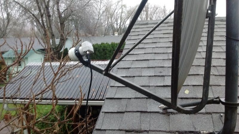

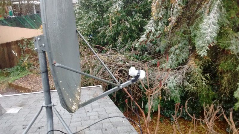

I had a customer having a slightly difficult time getting quality. I was very curious why the signal would not change when customer was moving the dish.
Please see the picture attached.
If your receiver shows good level but no quality, make sure LNBF is pointing at the dish.
Lol.. Oops sounds like a fun support call nightmare.
