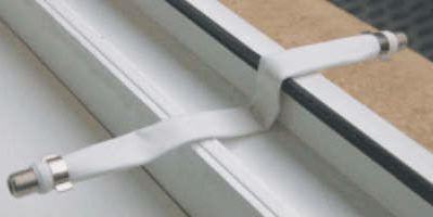

How do most people get their cords into their apartment? I'd rather not put any holes in the walls, and I'd like to be able to shut the door. Do they make flat flexible cables that'll work for a motorized 90cm KU dish setup?

When it comes to Flexible cables - YES, I've found that the RCA brand flat cables worked quite well for me in regards to being able to close the balcony door. The cables I used were about 6 inches long and had female ends on each end. I used normal RG6 cable up to the door, then RG6 again after getting past the flat cable.

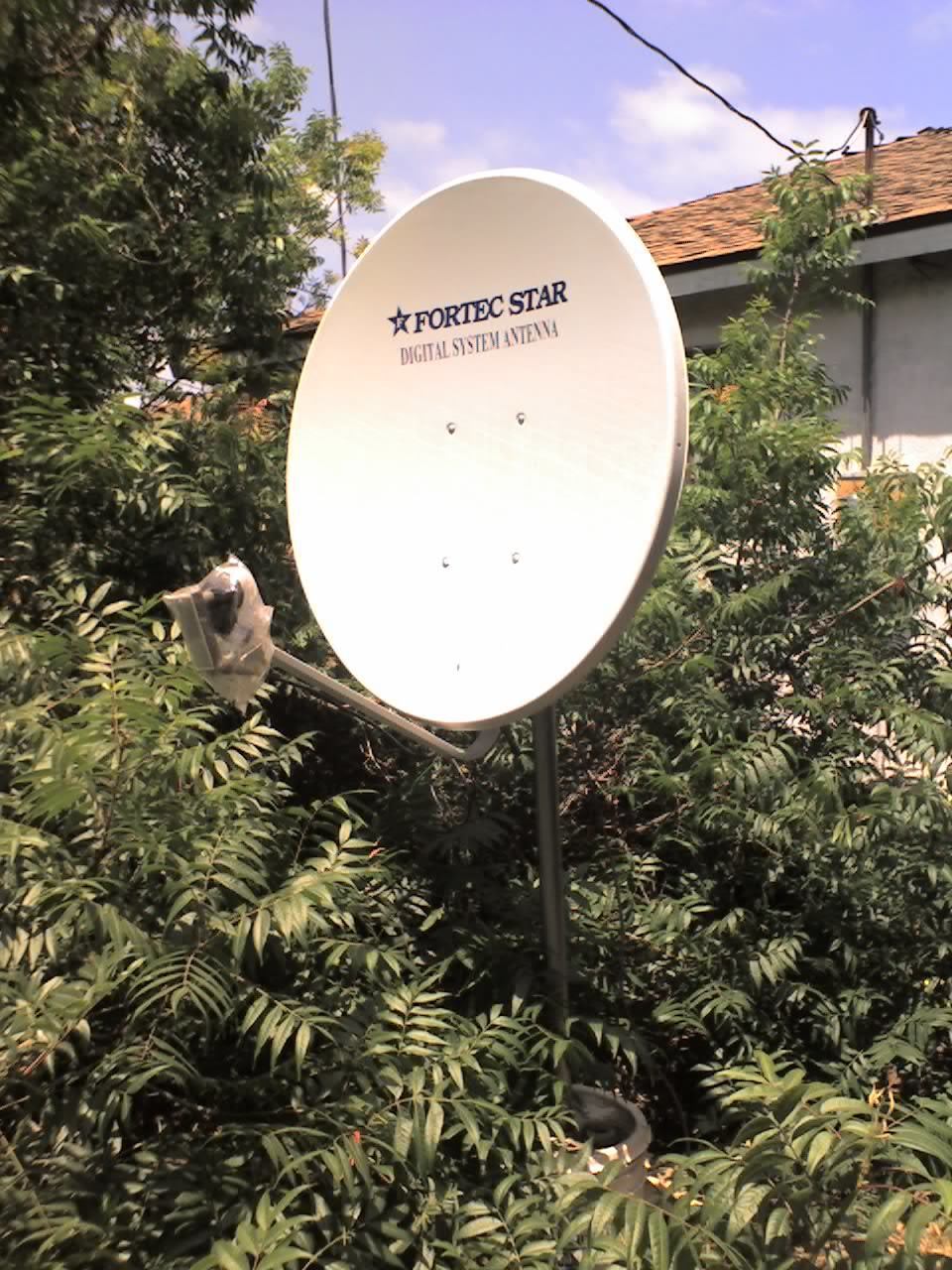

I've used a 5 gallon bucked filled with cement for a dish pole.
It's not ideal, and you don't want the dish to be chest-high, at least if you use the recommended 36" size.
But if you secure the bucket, put the dish at knee or waist level, and don't use a motor, it can be quite useful.
If you look closely at the bottom of the picture, there's a 5 gallon bucket. - :rolleyes:
I broke all the rules:
- it's chest height
- that's a 36" Fortec dish
- the bucket is not braced/secured.
During high winds it did blow over once in several years, and suffered no damage.
That's the only concern I've had. - :D
Here's what you need: Amazon.com: 2 Pack Flat Coaxial Coax Cable RG6 RG-6 Door Window RV: Electronics@@AMEPARAM@@http://ecx.images-amazon.com/images/I/316%2BllV-9TL.@@AMEPARAM@@316%2BllV-9TL
I've used these, in the past, with excellent results.
