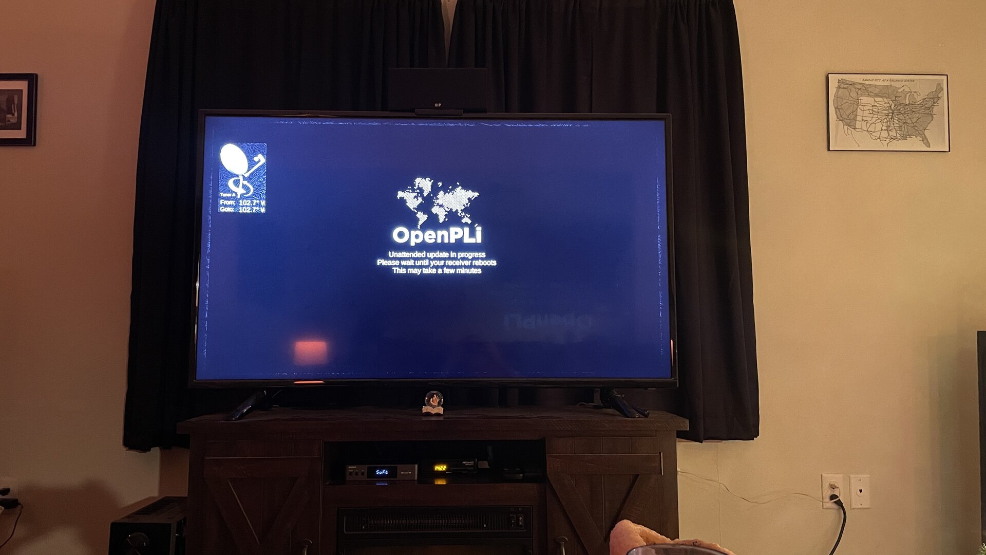

I'm using the Amiko to drive my motor as it has a more beefy power supply. One question I have- did a soft update to OpenPLi from within the menu. It said there were 500 packages to update. Receiver has been stuck on this screen for probably 20 minutes. Does that seem right?
500 packages update within the menu is 420 too many from my experience. I doubt it'll finish, but I'd leave it alone overnight JUST in case.
It really needs to be completely reflashed from a usb drive for that case. Even IF it manages to complete above, I doubt it'll be stable.

I thought the maximum number was something like 20 that could be done from the menu. Just reflash the latest image from scratch using a USB sourced from el bandido. Don't try to carry forward any settings. The effort is worth it.

Openatv will tell you when there are just too many updates to cope with and just flash a newer image, then restore settings.
