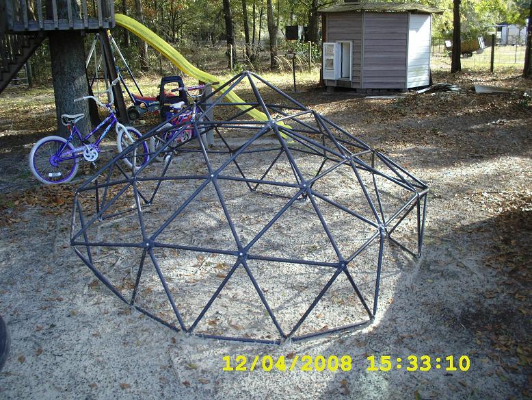

Want to see what happens when a guy has too much time on his hands, a couple hundred wildblue struts and two kids?
I meantioned an idea to my wife in passing and it became her obsession for a while. i had to build it to get her off my back.
see attached

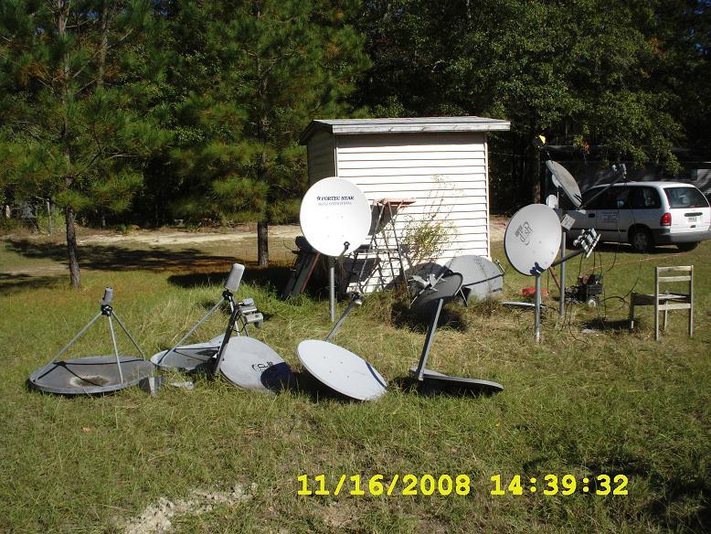

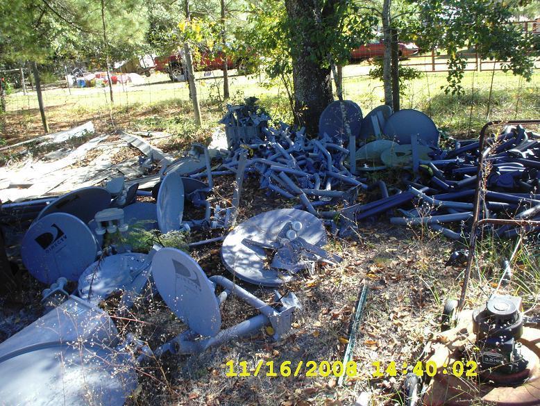

I know its not much in entertainment value. I guess i could show you my dish junk yard.
Theres more too, My wife really hates it. But I have three acres. So she really cant complain

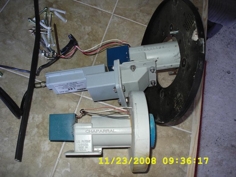

Duh, just read you signature. I have several old c-band dishes that I can just go pick up if I wanted to. Can the old analog lnb on the scaler ring assembly be swapped for a digital one? or do I need a whole new assembly? see the pic
nevermind, they were on ebay for $7 but now they are gone. Could you recomend a good ebay solution for a cband setup. I am planning to use my primestar 40inch dish for a stationary cband setup. Just need an lnbf.
