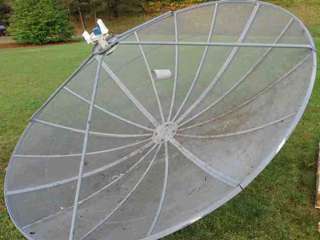

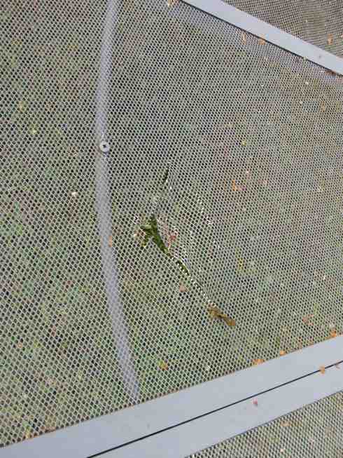

Before I got anymore involved with trying to setup my Bud I wanted to ask what everyone here thinks I should do. I had it laying in the woods for several years and the LNB was uncovered (my bad) and I'm not sure if that would render it toast or not. I've attached several pictures of my LNB and dish (10' Winegard) since I wasn't sure if it's too old of an LNB to get the C band digital programming on Galaxy 16? Also, the dish itself has suffered a couple holes from branches and some of the mesh has bulged out a little between a couple sections, and I wasn't sure how much of an effect this would have on signal reception. Oh, and the actuator was still attached and is fairly rusty.
With all of this said I'm inclined to buy a new smaller setup, since I could find a good location for a smaller dish (say 6 ft) a lot easier than the 10 ft one and since I'm guessing I'm going to need to buy components to get the 10 ft system going, I'd rather use that money (plus some more) to get a completely new system.
In case Iceberg is reading this: I saw you have a Fortec 6 foot dish with GeoSatPro dual C-Band LNB aimed at 99W. I was thinking of getting the same (or similar) setup for the same purpose. Does it work well for you?
My current setup is a Coolsat 7000, Fortec 90cm dish, Invacom QPH-031 and SG2100 motor.

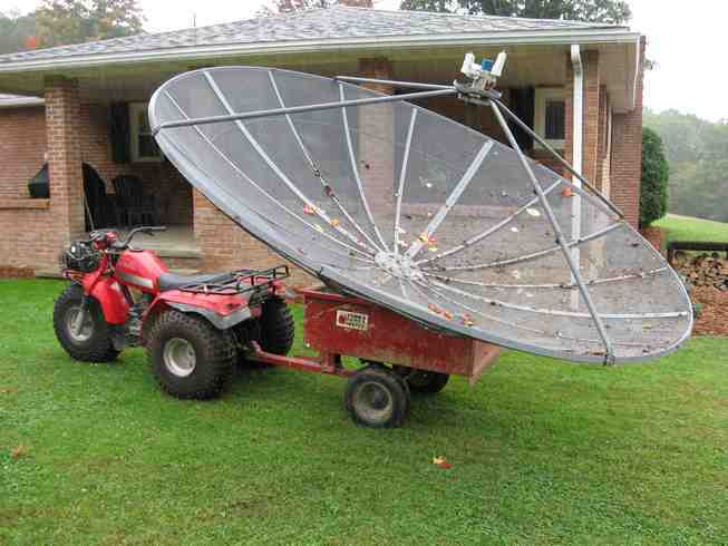

Oh, I also attached a picture of my new found method of transporting my Bud. My Honda Big Red now gets 500 channels!:D

Unless you just don't want a 10 footer I would set up what you have there. I see nothing in your pics that would keep me from trying it out.
My main BUD (10' Perfect 10) is in a LOT rougher shape than yours appears to be, and it works great.
You might try testing your actuator with a car battery, or battery charger, to see if it still works. Also pull some strings on the dish and make sure it's not warped.
Hook that bad boy up and point it at something. The only problem I had with an LNB like that was that the motor that changed the polarization was frozen and I had to take it apart and WD40 it.
I propped my last BUD that was that large against two pine trees. Worked great but changing sats was a different matter. :)
I'm just not sure where I can put the monster, but I'm glad to hear the condition shouldn't be an issue. I'll have to check and see if it's warped tomorrow. I'm inclined to think it isn't or if it is, it isn't too much so. I hadn't thought about testing the actuator that way. Thanks for the reply. :up

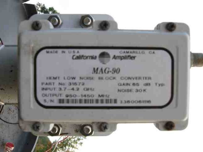

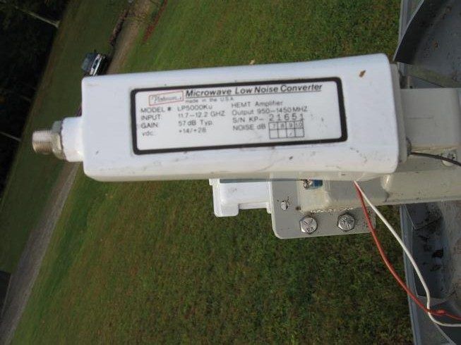

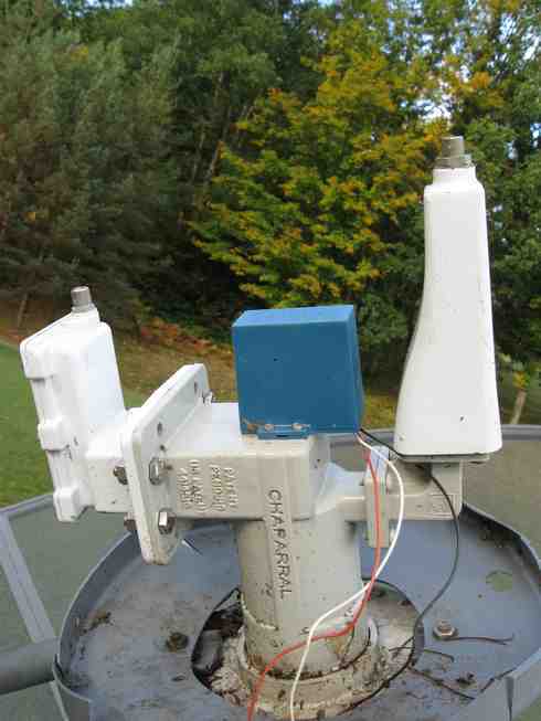

I'd take the lnbs and set them up so the connectors are down, for a day or two and see if any rainwater drips out! Let them stay in a warm dry place for a day or two before trying them out-they might be ok but I wouldn't bet on it, if they've been open to the moisture/rain for long. (on the other hand-I saw a ku lnb in a junkyard a couple of years back, bought it for a dollar, lol and dried it out like I mentioned, and it worked great!)

My ten foot Winegard mesh looked a lot rougher than yours, with several damaged mesh panels and about 1 inch out of true on the string test.
I warped it back into shape and repaired the panels. It gets 95% or better signal quality on most C-band sats, using a new LNB. It's the large dish in my avatar photo.
The old LNB was ruined by water/corrosion, and the actuator motor was rusty junk. However, the actuator screw jack is fine, and I use it to position the dish along with a simple measuring stick, marked for various sats. I chuck the drive coupler from the old positioner motor in a cordless drill and use it to move the dish.
It stays on G16 @ 99w most of the time for the networks.
Yours is definitely worth fixing, but I would suggest a new LNB.
I also should mention that mine is a later model than the one in the 10 foot Winegard dish owner's manual PDF available on this sight. Mine has a longer focal length/flatter parabola, and the panels simply bolt together on the edges. Yours might also be newer/different than the PDF manual.
Mine measures 22" deep at the center of the dish. The calculated focal length is 40.91 inches, giving a f/D ratio of .34. Quite a bit different than the older model in the PDF manual, which caused me some confusion, until I realized the manual was for a different 10 foot Winegard dish.

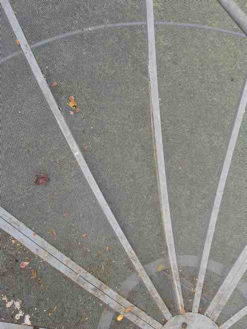

It looks somewhat better in the pictures than it does in real life. One of the mesh wedges came out and was flopping around. I had to try and slide it back in (to very limited success: my patience was wearing thin:eek:) I'm glad to hear there is some hope for mine since you're doing that well with yours.
I'm thinking that the description of what you had to do is probably what I'll end up having to do as well with the LNB/Actuator. Yeah, I'm going for the G16 networks, since losing all the Equity channels and now KTWO on G18.
I like your idea of using a cordless drill to position the dish, I have a feeling the motor in my actuator is toast too.
If I was really ambitious my cousin has two 10' Buds behind her house. One is a fiberglass model and the other appears to be a solid stainless steel model. Both look like they were built to survive a nuclear war. :D

"One of the mesh wedges came out and was flopping around. I had to try and slide it back in (to very limited success: my patience was wearing thin:eek:) I'm glad to hear there is some hope for mine since you're doing that well with yours."
I had to re-install several mesh panels that were knocked loose. The best way I found was to unbolt the offending panel section, turn it on its side, and gradually slide the mesh into place.
By having it on its side, gravity helps to keep the mesh fully seated in the lower channel, while you tease it into the upper channel. I also spread the aluminum channels the mesh fits into with a thick putty knife, then hammered them back tight after installation.
Re-installing the panels was by far the toughest part of my rebuild, and I was getting nowhere until I broke the dish down into the panel sections and turned the panels on their side so I could easily reach both sides of the mesh.
