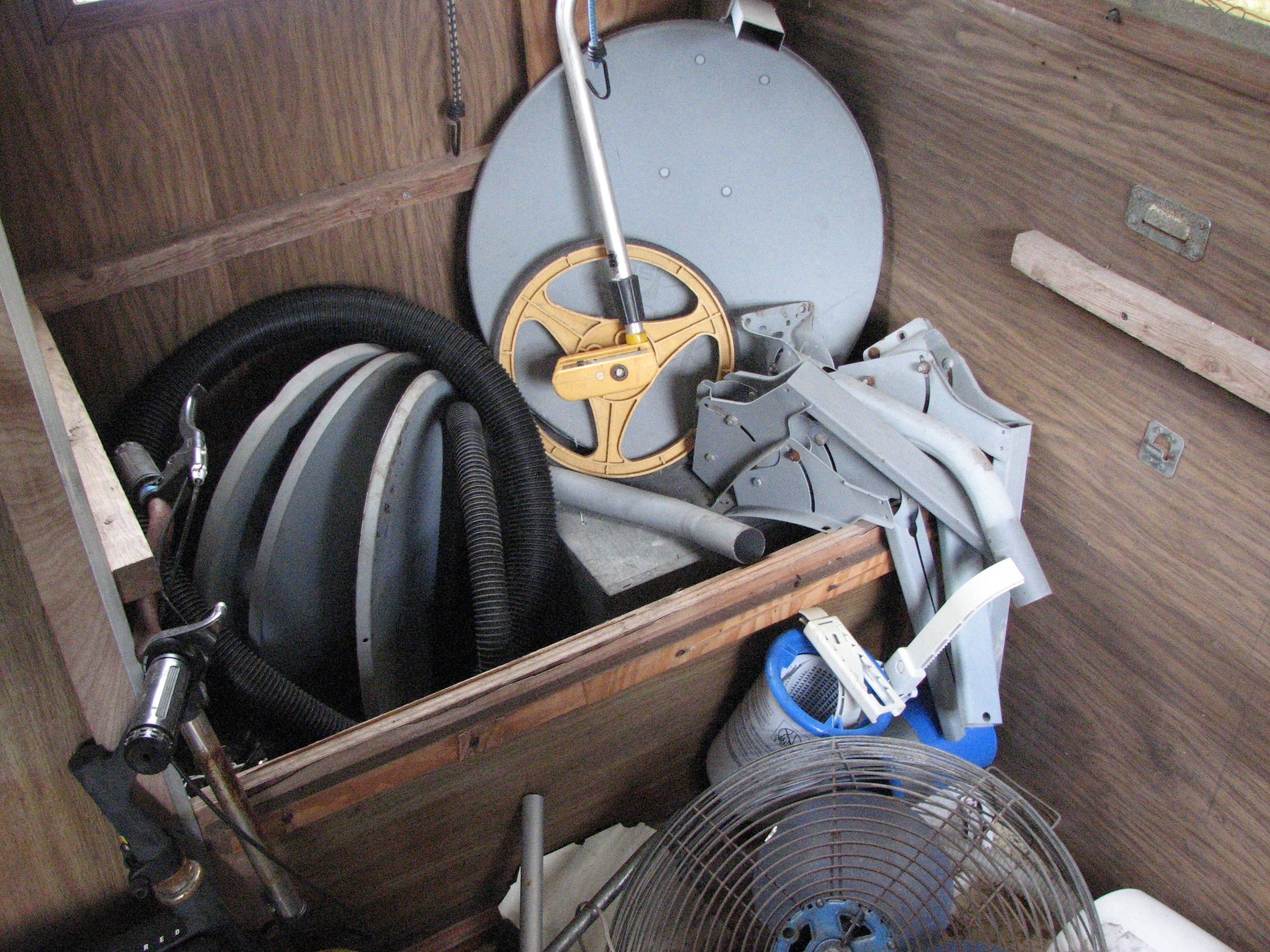

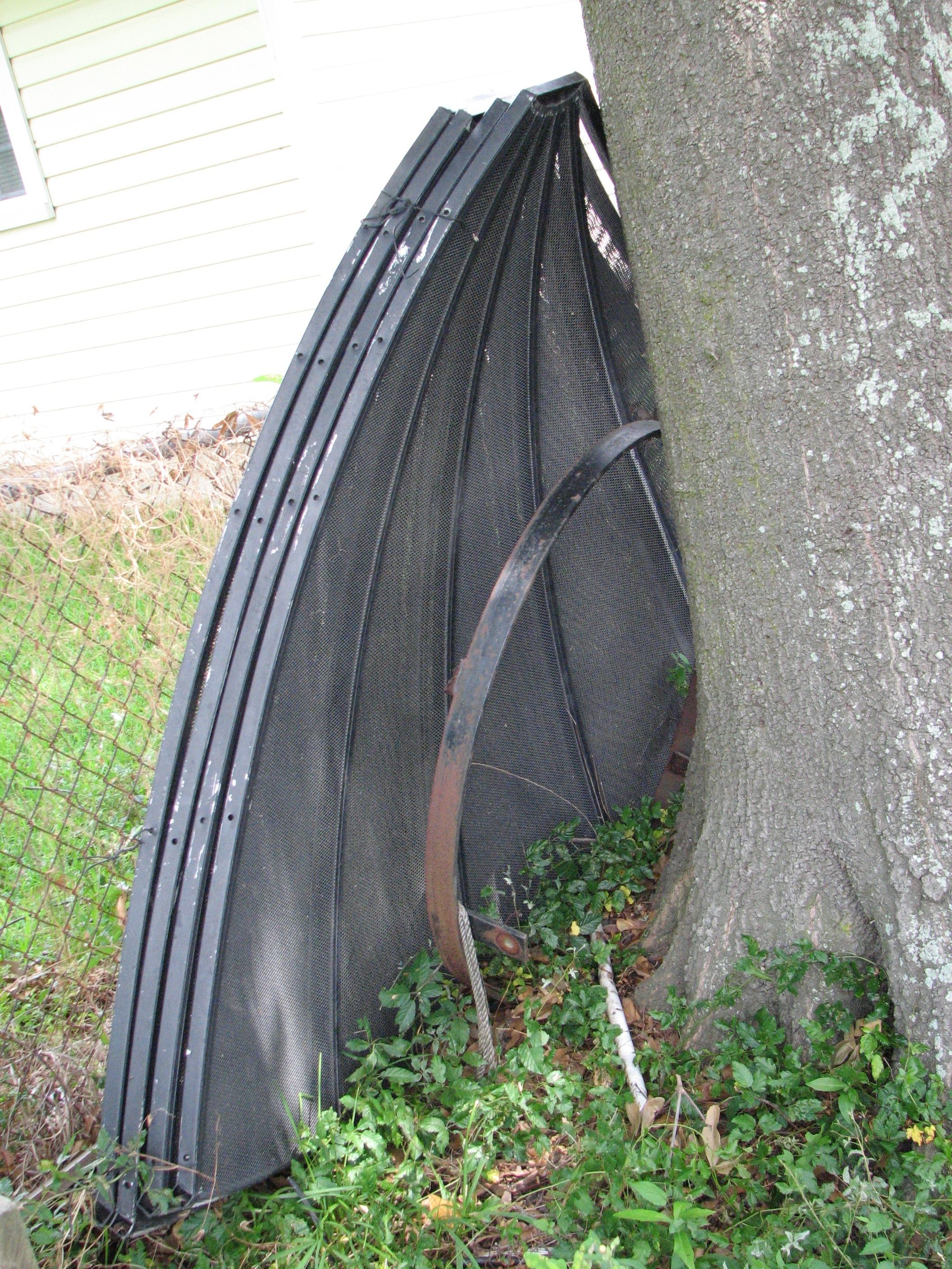

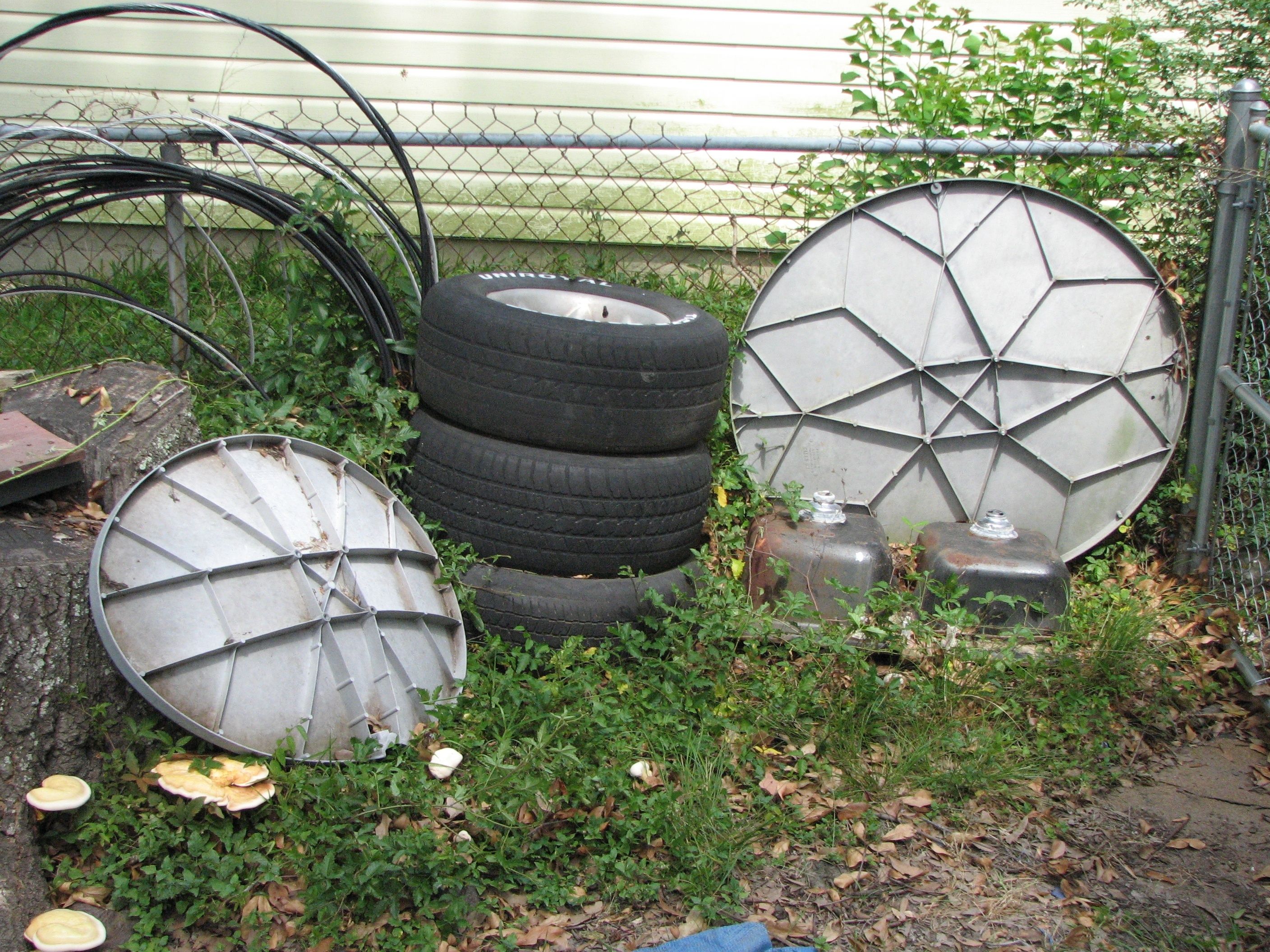

I went out with a camera this morning and poked around the yard to see what so called treasures might be lurking about. Like I said, my ex had a habit of picking up just about everything he saw on the side of the road. Not just satellite dishes. Oh joy, the cleaning up I have to do now. Seriously, I was about to throw all this stuff back to the curb again until you all advised me otherwise.
There's stuff scattered all over the place, all shapes and sizes and brands.
There's the remains of that old monster we cut down years ago too. I do not know how big it is for sure but it was BIG. It was a good bit taller than me, I remember that because I helped him roll it when he took it down. I am *not* going to put that horrid thing back up. It broke constantly. It was *not working* far more than it ever did work. No thanks. It's going to the curb.
I found some more of those larger gray dishes and a lot of the small ones that say dishnet and directv. After every hurricane you can see oodles of them thrown out to the curb. It was so embarassing, he had no shame, he would stop, jump out and throw them in the trunk and grin like a possum. I kept telling him to stop, enough was enough but I think he has some addiction to collecting junk. And really, he would pick up *anything* especially ceiling fans and TV's.. He would clean them up and give them away. I do have to admit though, we haven't had to purchase a ceiling fan in years. And there's one in every room, even the garage. :rolleyes: Sheesh...
Ok, so anyway, I do not know where all the parts are for these things.
I found a few of the tubes that go to the bigger one (the one by the old sink) but it looks like one or more are missing. And I do not see the parts that go on the back of it. I have a pretty good idea of what it's supposed to look like from looking at others and from photos on here of others. As a matter of fact, I think it is the same as the purple one that "turbosat" has in his thread, "Everybody wants one"
I remember when the ex picked it up, he was all giggly over it. I was not too happy.
He picked it up like 10 years ago and never did anything with it. It sat around with all the other junk all these years.

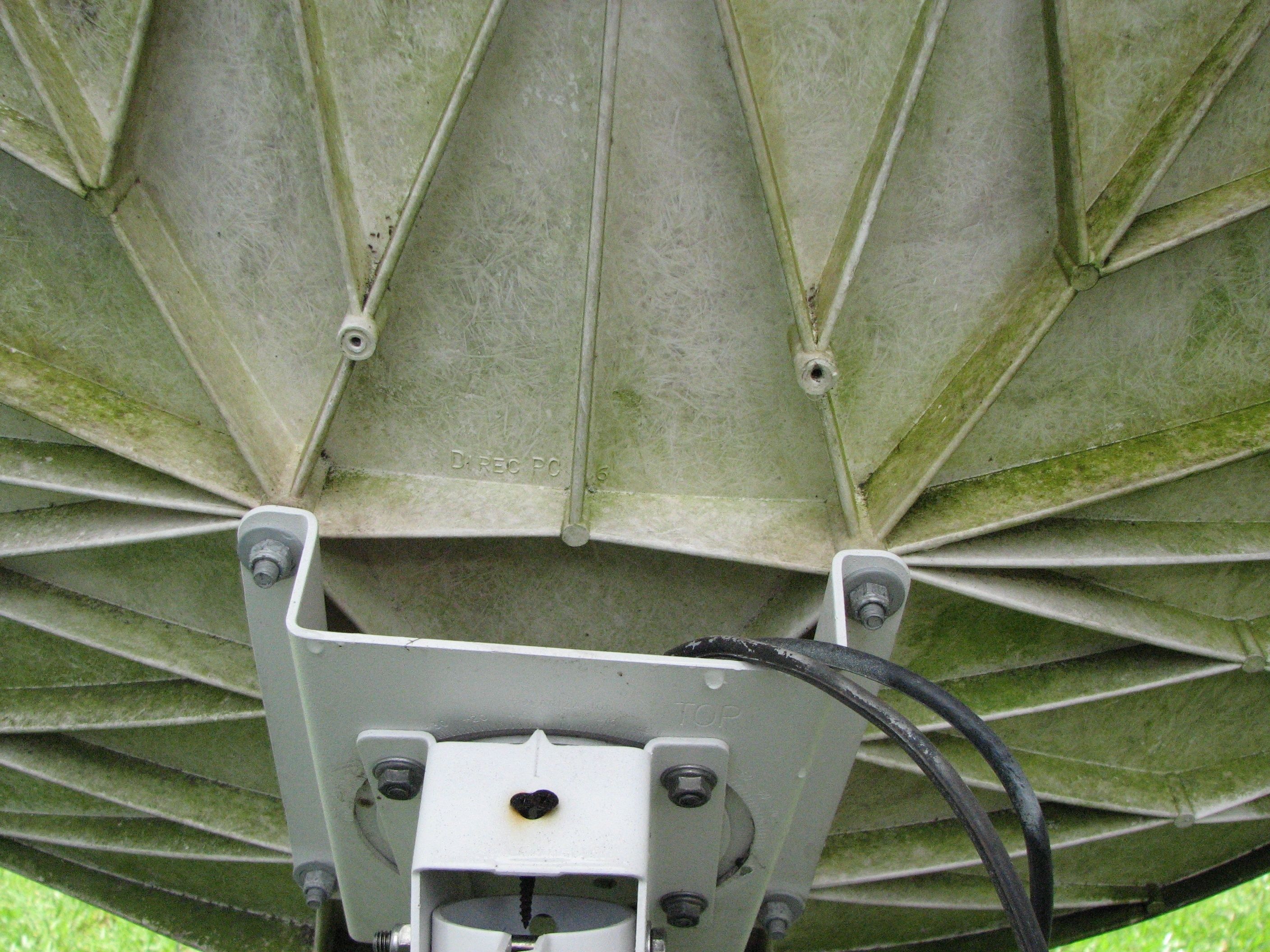

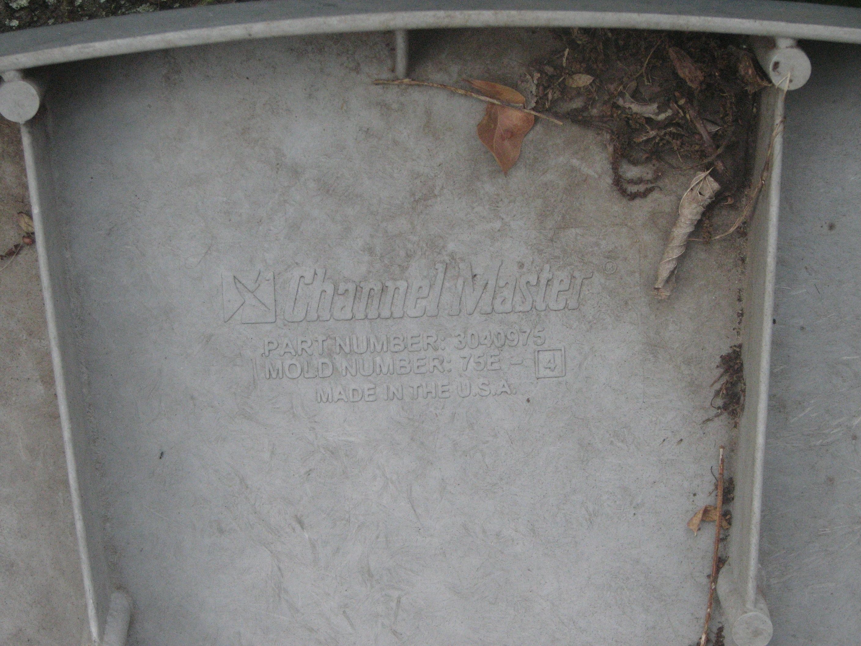

I took some pictures of the stuff and am attaching them, maybe you guys can tell what the stuff is and what can be done with it, if anything. As far as the stuff being valuable, heh, ok, if you say so. I'll have to take your word on that. So for now that stuff got a second chance, saved from the trash pile, again..
One thing I have learned is that there are a lot of satellites with stuff I would like to see but in a lot of cases, there is only one channel on the whole satellite that's worth watching. And since I only speak English, that limits a lot what I might be able to watch. So sprinkling the yard with gobs of these horrid, ugly little things just really turns me off. Put up one for each channel? Um, I don't think so.
For now I can put up with 3-4 of them, that's what he had out there anyway. I got sick of looking at it and took several smaller ones down. I really would like to get a single dish that moves around so I can check out all the different things. They are just too ugly. I'm trying to clean the place up, I used to be gone a lot and didn't worry too much about the clutter but now it's time for it to go.. I would like to have a pretty yard again. :)
Thanks again guys, you all are super!

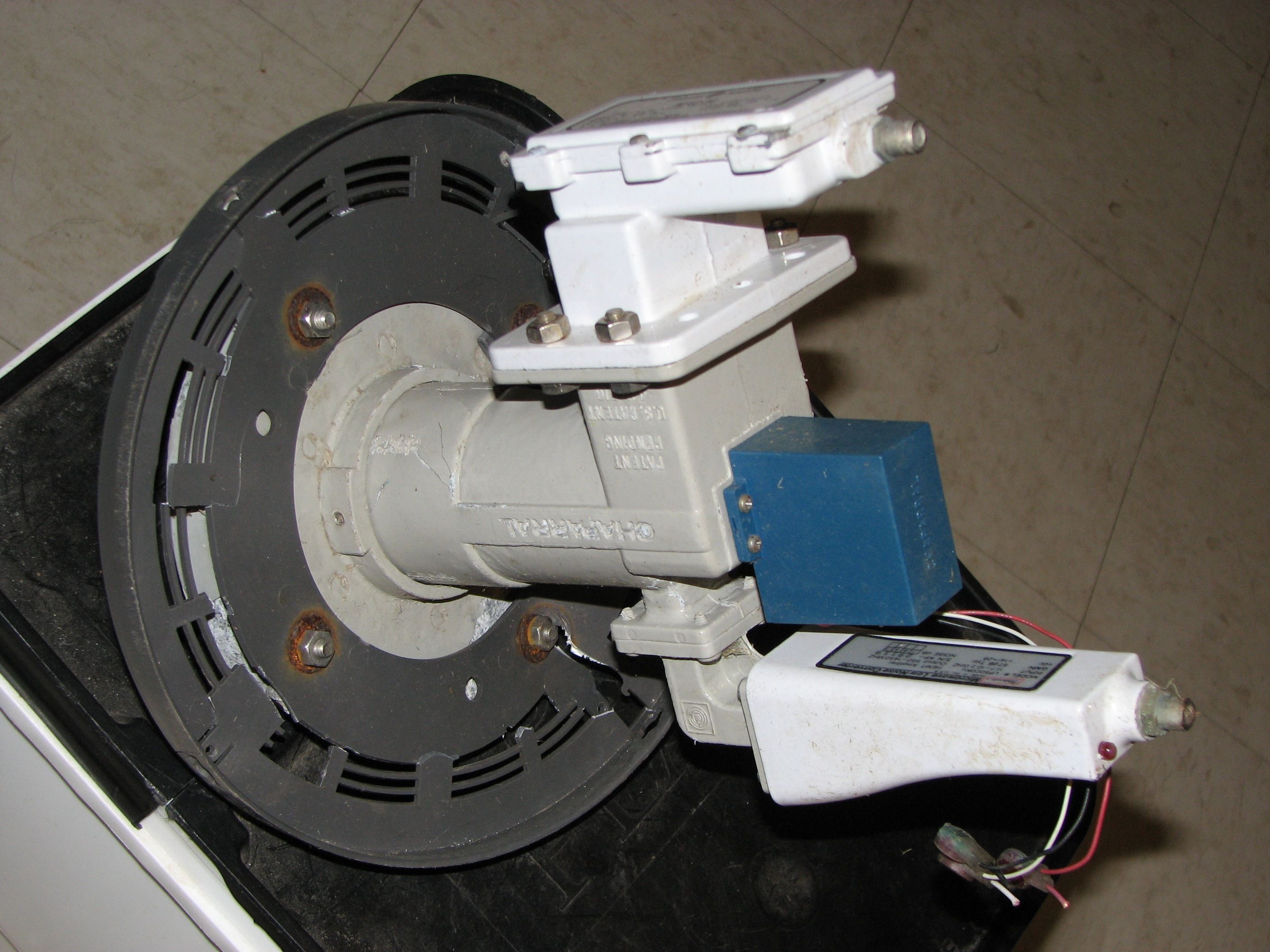

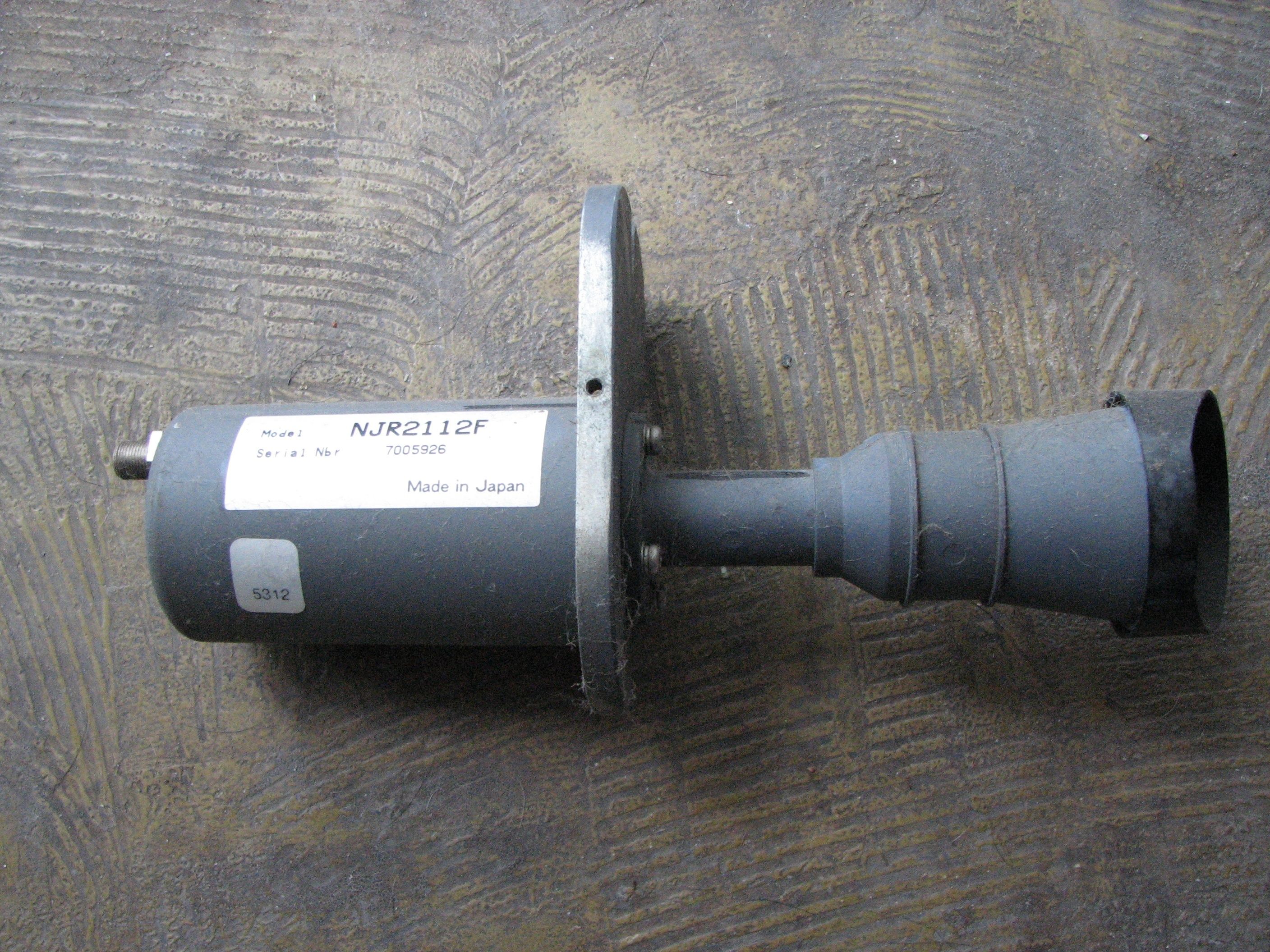

The second to last picture is the lnb and feedhorn for the Channelmaster 1.0 meter dish. I'm sure someone would be interested in the CoRotor and the mesh panels and mounting ring from the big dish too.

I see that your ex had quite the eye for the good stuff.
All those molded commercial dishes with the ribs on the back side, are very desirable.
The smaller metal dishes are probably Dish Network and DirecTV, the two main pay TV satellite providers.
Their equipment isn't totally useless, but would be a distant second for your uses.

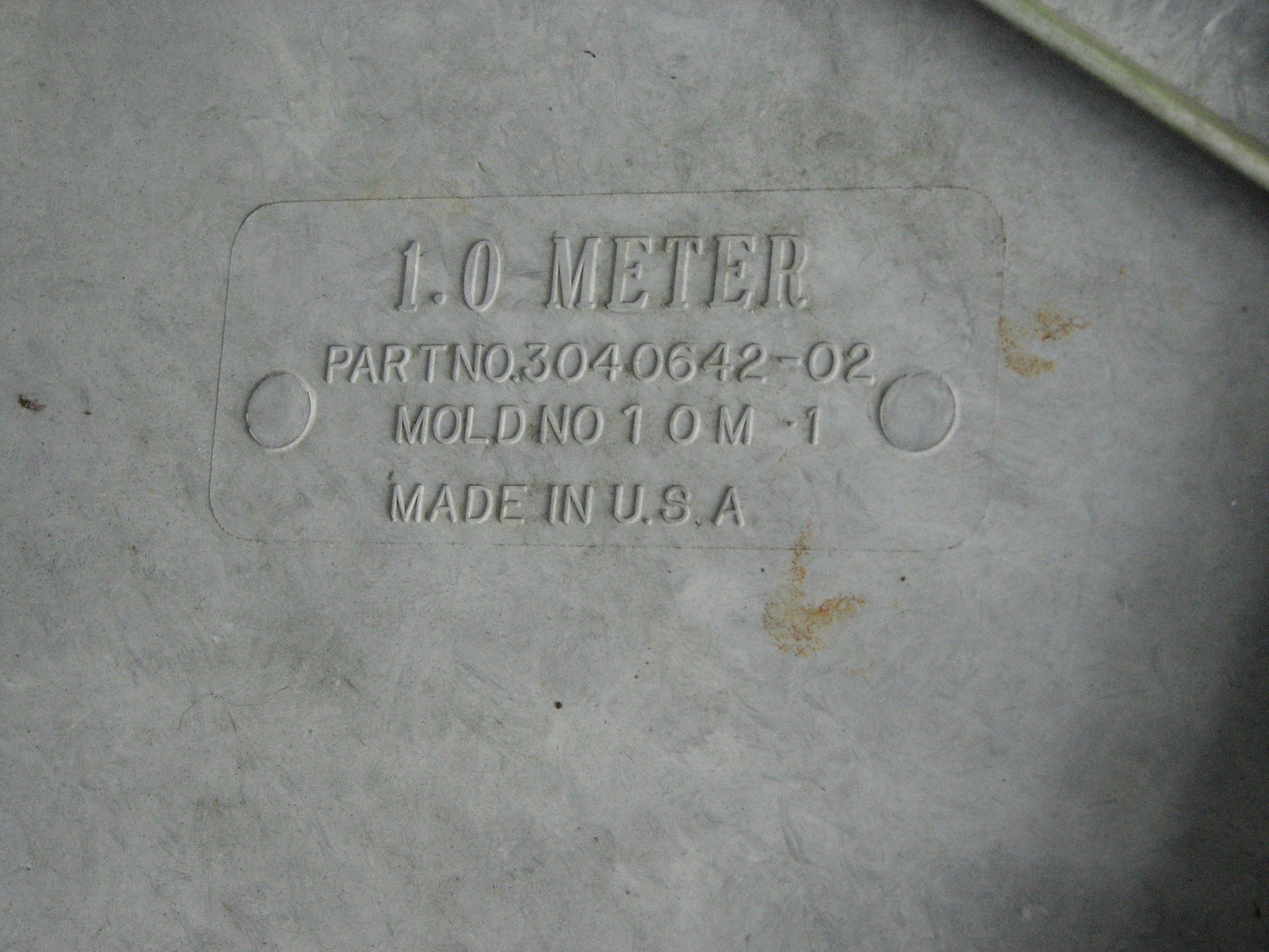

#1): tops on my list would be a round 1.0 meter ChannelMaster molded dish.
You have the LNB, the dish, and probably the 3 LNB support struts.
I'd make that my choice for a motorized dish.
Just need to find/make some bracketry for the back side, to hook it to the motor.
Been done many times on the forum, so there will be many threads and pictures to go by.
#2): That dish with the 1.0x0.7 markings, is a favorite with the members.
It's got one wide LNB support at the bottom of the dish
Often, we put multiple LNBs on 'em, to get two satellites.
Just check the first post of this thread and look at the pictures by Linuxman, for a clue how easy it is.
We won't get into all the details right now, but there are two considerations:
- the two chosen satellites have to be near each other in the sky, 'cause the LNBs need to be fairly close to the center focal point
- the two satellites can't be so close together that the LNBs interfere with each other.
#3): I hate to not put this higher on the wish list, but that 1.2 meter (four foot) molded dish you have is hot stuff.
The down side is that it's heavy, and would be more trouble to get set up.
For most of us, it'd be the first one we grabbed and drooled over.
Keep at least one through the end of the year, no matter what.
You might decide you have a use for it later. - ;)

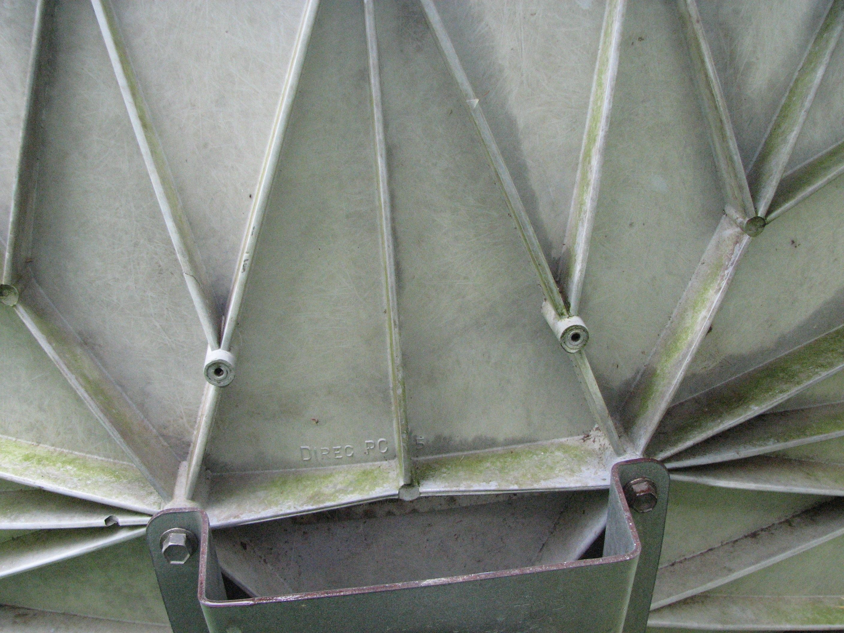

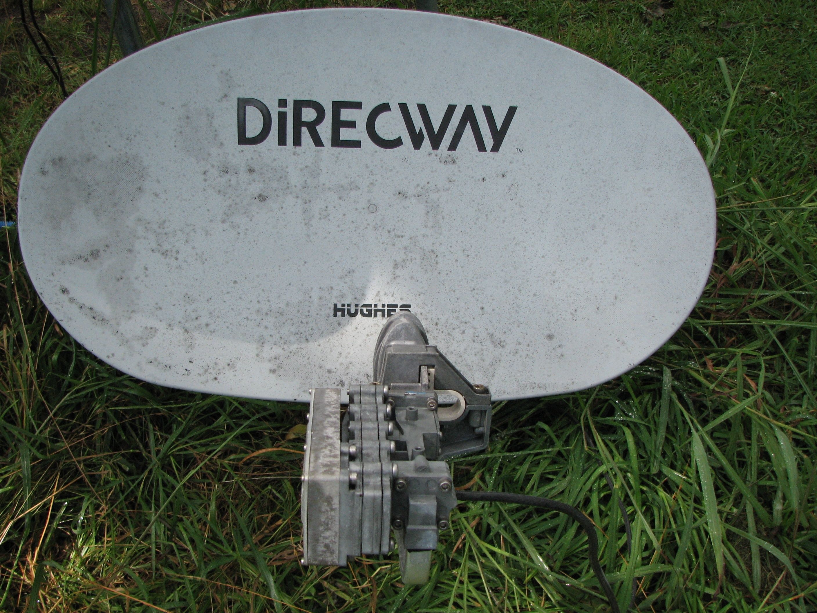

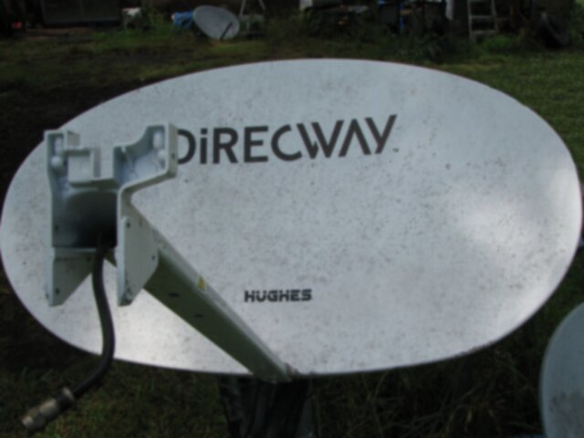

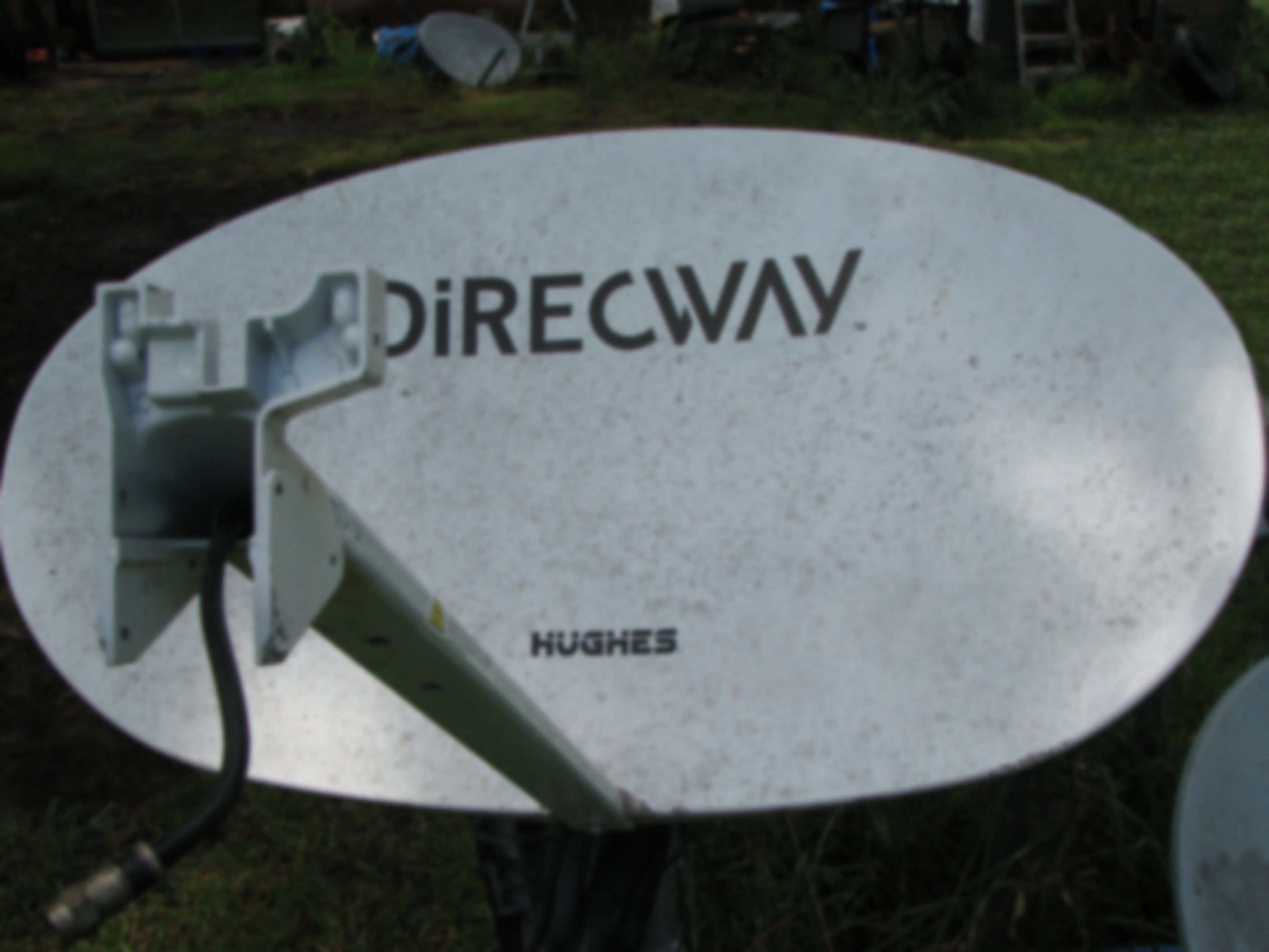

Hi again. Hope I'm not being a pest but I'm still not clear on things.
Which one is #3? a 1.2 meter ?? I guess I need to label those things so I can easily tell which one is what.
I took some more pictures of the internet satellites, the ones that say direcway.
One says Direc PC 6 and one says Direc PC 5
Both are the same size, I used a tape measure, I think they are like 23" tall and 40" wide.
The last picture came out badly, I must have pushed something on the camera, it has buttons all over it and it beeps at me everytime I touch it.
Oh and it quit raining so I may go out and try to setup that one for White Springs, I like the shows they have lined up. :)
Thanks again so much! :)

I was saying #1, #2, and #3 in desirability, not in order of your pictures.
You have plenty of good stuff to work with.
The DirecWay dishes will get single birds just fine.
Thanks in part to them being wide , which helps reject the adjacent satellite.
You can also mount two LNBs on them, and should be able to receive two satellites pretty much like the pictures I linked above (which uses dishes similar to your 1.0x0.7m dish).

As for the barn full of BUDs...! - :eek: - We need pictures!
Solar cookers, my big green lizard tail!
