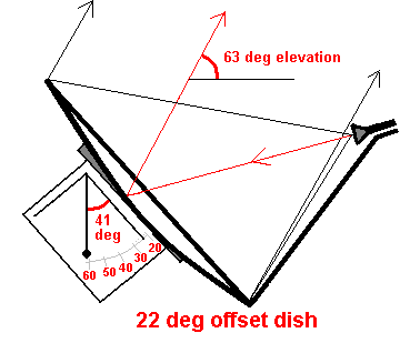

Dee that is a good representation of how an offset dish looks at the sky. If you got a few frozen frames off WhiteSprings, the tree might be in the way. Or maybe you just momentarily hit the signal, and something moved again before you got to tweak the aim fully. I have a big walnut tree in the back yard, to the east, when I aim my dish at 72W-it looks like the dish is pointed right in the middle of the bushiest part of the top of it, but I get 93signal, 99quality on most of the transponders on that sat. So don't give up yet.

take a breath - you're doing fine:
The dish is a reflector. Acts just like a mirror.
Everything you see in it, is reversed.
In fact, think of the dish as you would a flat mirror, and see if that helps.
Your picture reflects that analogy (pun intended) - :D

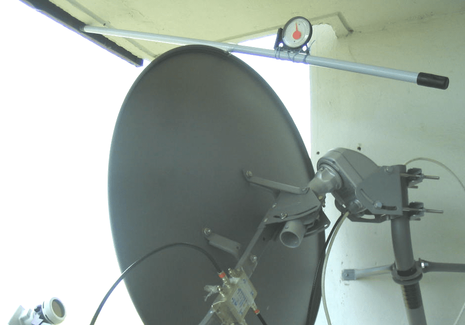

As for knowing if your overhanging tree is the problem...
(and by your description, it is)
... here is a little tool you can make for a buck to help you out . . .
ThisBUDsForYou and his soda straw inclinometer
http://www.satelliteguys.us/free-ai...a-straw-inclinometer-line-sight-pictures.html
Delta Charlie had some variation on the idea, too
http://www.satelliteguys.us/free-air-fta-discussion/146479-15-min-duct-tape-elevation-gauge.html

Here is a pic to understand what dish elevation angle is. As you can see, its much higher than the angle your dish seems to be pointed at due to dish offset angle. So, may be your tree isn't obstructing the beam at all, despite the dish may seems to be pointed at a top of the tree, as the beam reflected by your dish towards the LNB really comes from above the tree.

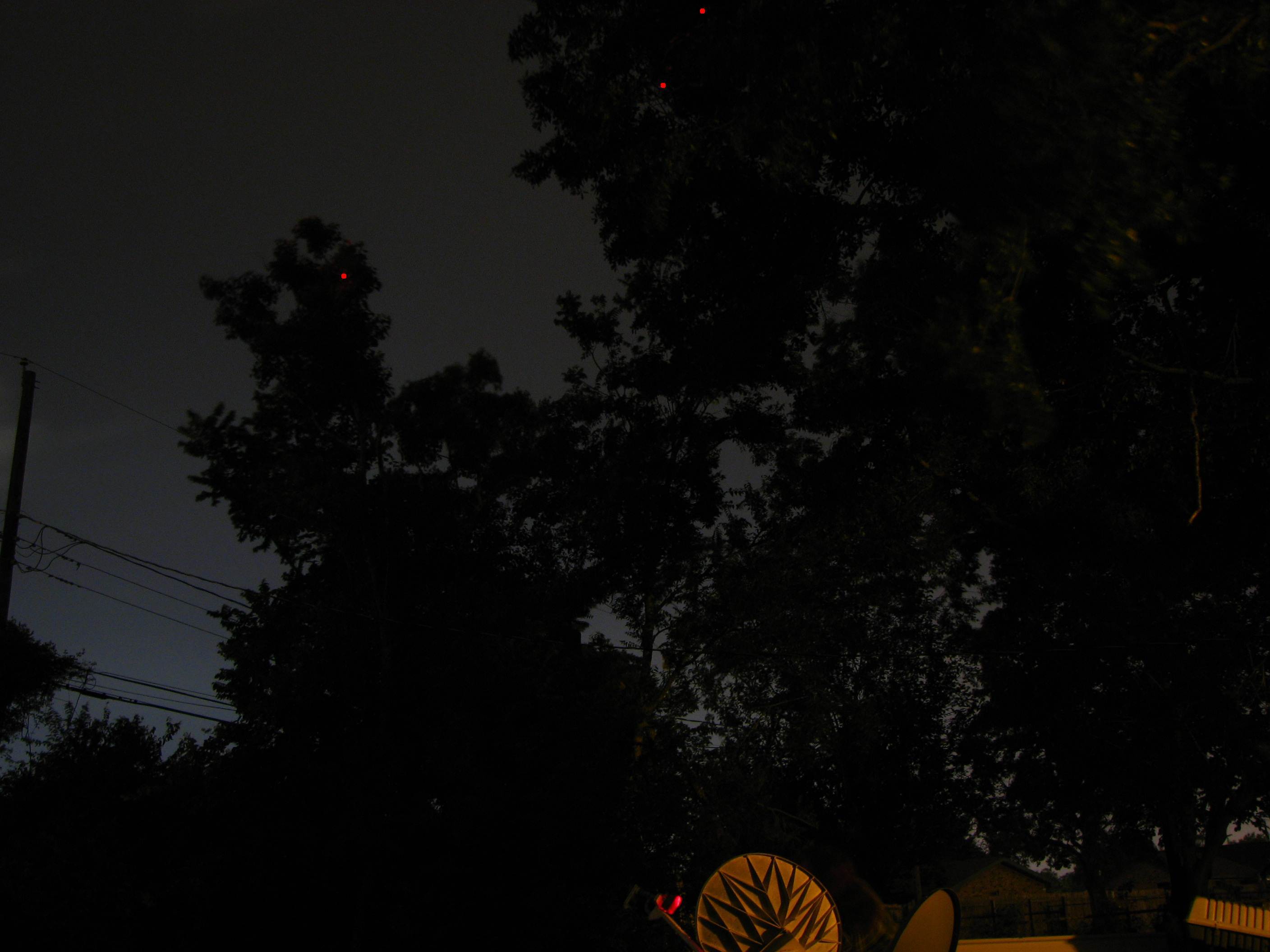

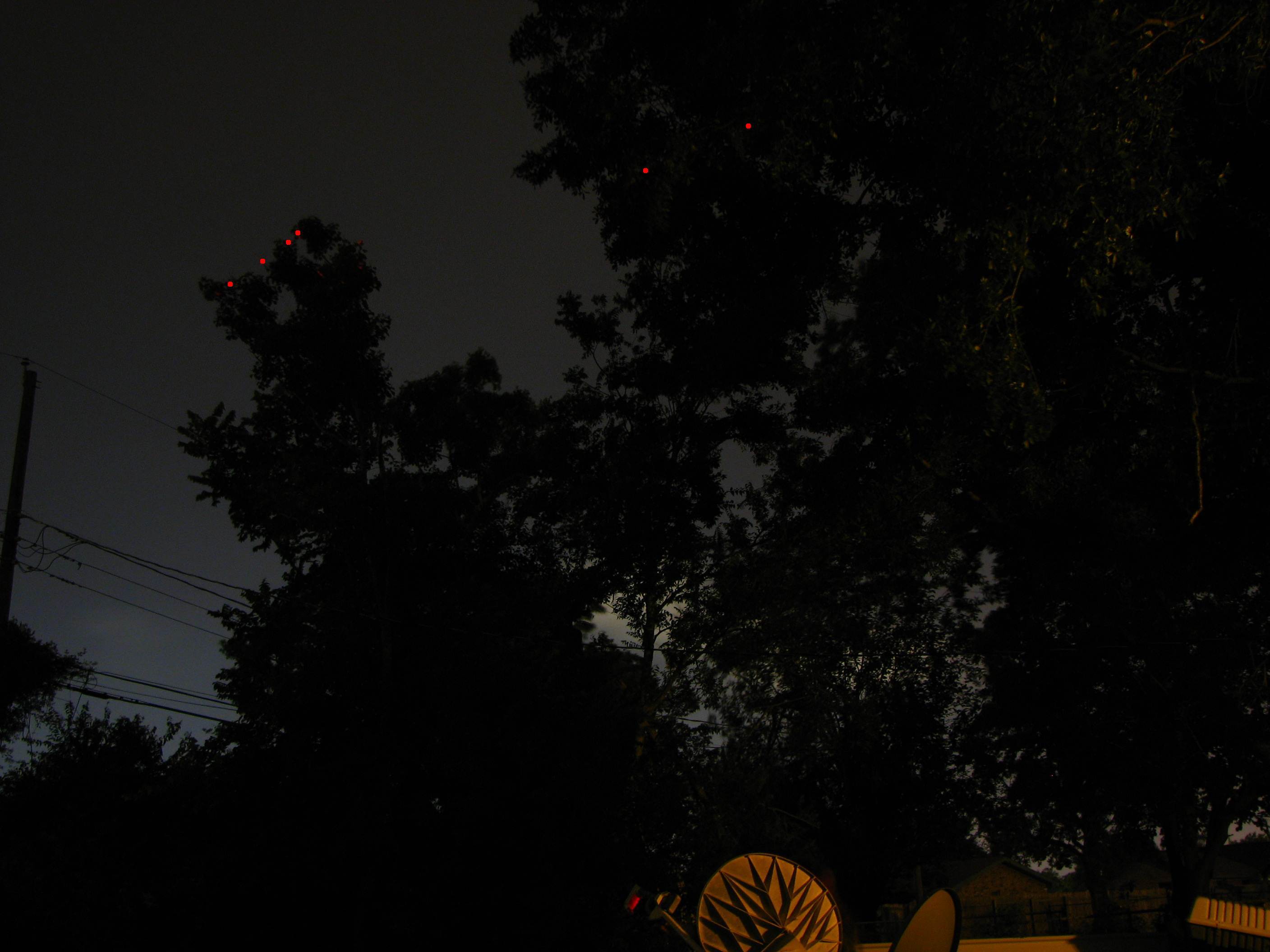

Ok so I might have a tree problem. The arm on the dish is NOT pointing at trees but as I've just learned, that doesn't mean much, it seems the satellite dish is "looking" at a much different place than where the tip of the arm is pointing.
So I went out there tonight and braved the mosquitos and took my nifty neato camera and tried something. I set the camera on a tripod and pointed it towards the dish and the trees. I set it to hold the lens open (is that the right term?) for 15 seconds then set a 30 second delay timer.
I pushed the start button on the camera and ran over to the dish.
I placed a toy laser pointer against this flat triangular plate on the side of the LNB then when the camera began to take the picture, I moved the laser up and down, shining it where ever it would shine. The dot showed up in the trees but only when I was pointing it very high. I have no clue where the dish is really "looking" so I don't know for sure if it is looking up into the trees or not.
The tip of the arm it pointed at a telephone pole back there but the pole is not in the way. But again, the dish is probably looking (that sounds stupid, it's an inanimate object) much higher than the telephone pole.
I took a few pictures but had to get back in pretty fast as the mosquitoes were eating me alive.
I attached the two pictures I took. I used a paint program to highlight the dots because they are extremely hard to see but I could spot them since I could see them when I pointed it, I can see far better than the camera can.
They laser dot jumped around a bit as I moved it because it was hard to hold it still with the bugs chewing me to death. But you get the general idea, the dots are a little crazy but in general are pretty close to where they really were.
I'm about to give up on the birdog. I even took a loose dish out further into the yard so I KNOW it was clear of any tree problems and still could not find the free satellites.
It's sooooo frustrating! :mad:
I think I need to read and reread the instructions the birdog people sent me and make a custom file for the meter just for those two satellites, 83 and 129.
I read somewhere that the direcway LNB has a tone switch(?) built into it and maybe that's why the meter can't read it.
I gave up on that universal LNB, it doesn't work at all, it sees nothing I point it at, no matter what I set the meter too. Junk. As is most everything around here.
I'm getting close to setting it all out to the curb.

I looked at your nice laser dots. Very creative. Not sure what it means, though.
I really think you would be put well at ease, if you were to build up the soda straw instrument described above.
You hold it next to your dish, look up at the angle required, and see if the limbs give you trouble.
From all you said, and your laser-dot pix, I'm sure that's the problem.
If you want to be even MORE creative, put the laser on instead of the straw, and use the thing at night!
Just be sure the laser line is parallel to the flat side of the protractor.
The lasers will be off a bit - you can see the error by rotating one around it's centerline.
So, just shim a little to calibrate it.
Maybe moving the dish forward, backward, or to the side just a few yards, might get you a hole to shoot through.
