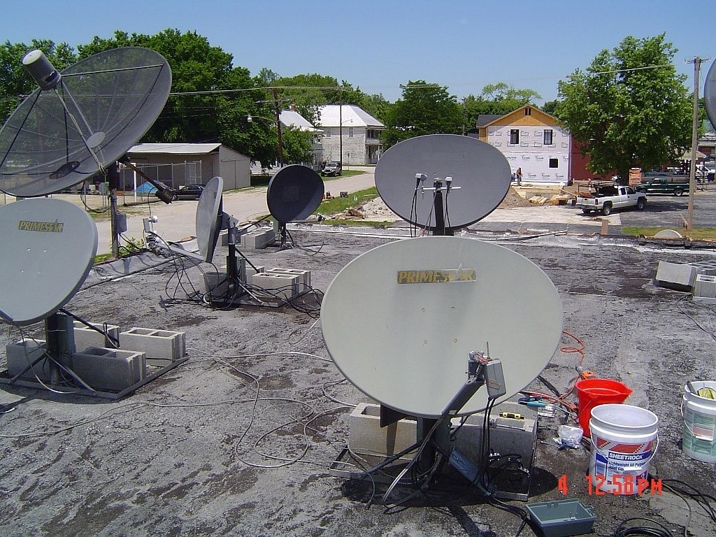

After watching the photos I beleive the issue are the branches of the trees. Like I said DN signals are stroger so you will get them behind branches but not the case for your White Spring TV. I also overlooked the fact that the LNB was Universal otherwise I would have mentioned this when I looked at the picture of the birdog the OP posted at the begining.
I am a Telecomm Eng or at least in Cuba I can claim that however I have learnt most of this stuff by trial and error and reading a lot after graduation , well actually, after living in Canada lol. The only Dish you are allowed to have in your home in Cuba is the empty one on the dinner table because the full one even your own pet would still it and eat it. A cuban who owns a pet nowadays? , well that is another story!.

I can't believe you are about to give up! It looks like the only small fix left is to move the dish to a different spot, add a working Linear LNB, then program your meter to look for signal on White Springs channel frequency (i.e. select the right TP: 11964 2920 H 1/2) and aim the dish like your did to catch Ceil 2 DishNet sat with a Circular LNB, as they're both at 129W. That's it! Don't be disappointed though - it may not be the best channel out there to watch anyway, and there's nothing else on that sat.
When I was trying to setup my first dish, which happen to be motorized on top of it all, my impression was all the equipment I just bought wasn't working and out to be returned. Trying for hours, I couldn't find ANYTHING in the sky. The only thing I found - FTA to be unusually hard to crack target for a 1-st time DIY project. Almost giving up and looking for an installer, I then realized, most of them never installed a motorized dish though wouldn't admit that, so it would only be wasting a lot more time and money, if the installer goes through the same university with your equipment at hand charging you his tuition fee. On top, being adept in making things work, I simply couldn't agree to fail. Looked for the Root Cause, and it turned out, the dish was mounted in the wrong spot with most signals obstructed, plus I was searching signals from TPs that weren't emitting any at that time - so signal Q was always at 0. Could spend a lot more time aiming the dish - and still wouldn't get anywhere. Lucky me - I had the right LNB. LOL
But you already found several sats, so way ahead - why give up? You can put a motorized dish yourself - its the right step and easy after all you went through. Pickup the biggest dish you can handle - not less than 39", but better 1.2 m in Dia, otherwise later you won't be able to lock in many Linear sats' channels, especially of newer types like DVB-S2 and 8psk HD. Its a simple trade-off: more free channels with a bigger dish, because it gives stronger boost to weaker signals.The reason Circular sats are easier to catch, often having better pic quality and getting away with small dishes is next gen. equipment these Broadcasters use, and very strong commercial quality signal they emit for the money. And review your views about C-band. If you still think, a C-band dish looks ugly, look below what kind of dish farms some FTA fans built on their property.
If you decide to install a motor driven Ku-band dish, look through a detail and quite informative for a novice multi-section Tutorial Aiming a Motorized Dish.

Dee, don't give up. You've got some really great dishes, which equals a great start on the hobby, and you seem to have an aptitude for this stuff :) ... Lots of people take weeks as newbies to get where you've gotten in a lot shorter time. It really is fun, but the summer heat takes a toll. I try to work at night, when its cooler (under a full moon for good light), so you know what the neighbors think of me. And the mosquitoes are always present...
