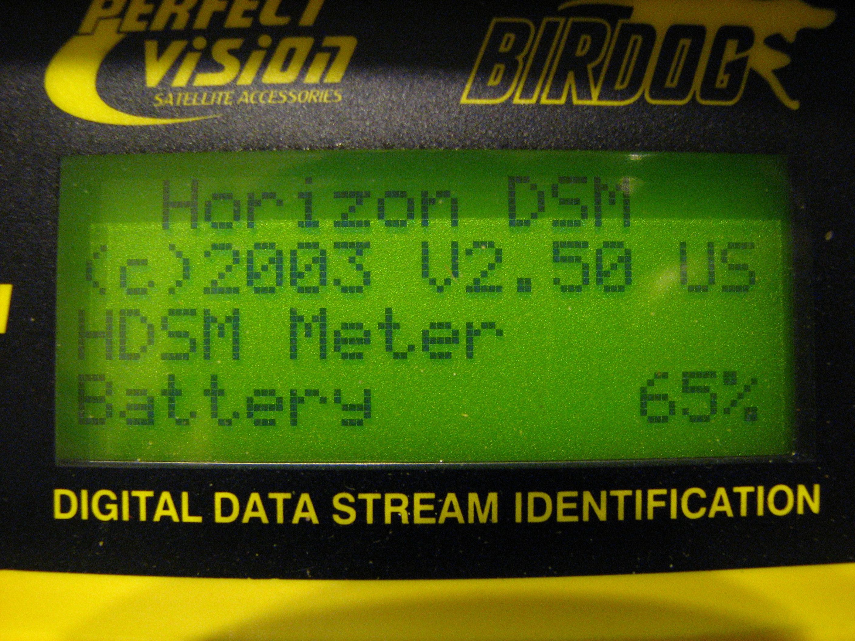

I took picture of it's startup screen to show what model/version it is, maybe that will help clarify better, my descriptions may be a little lacking at times. :o
The man I bought it from had bought a brand new meter, much better than this one and didn't need this one anymore. So he sold it to me, cheap. :D At least I think so.
I paid him $100 for it. He said it was in perfect condition and to me, it looks pretty clean. However it does appear to be pretty old from it's little info screen, could that be a problem?

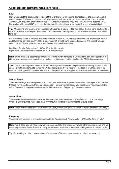

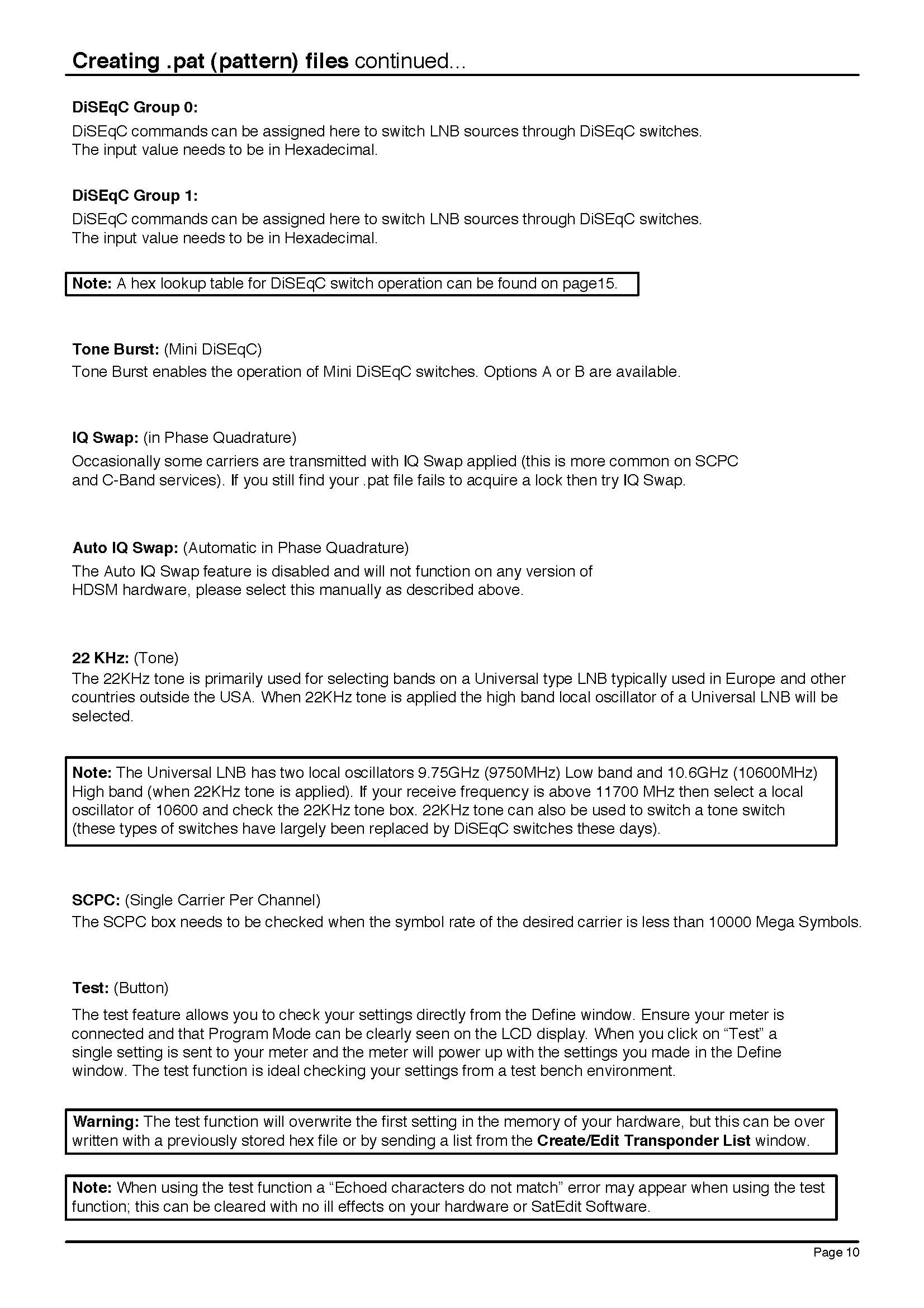

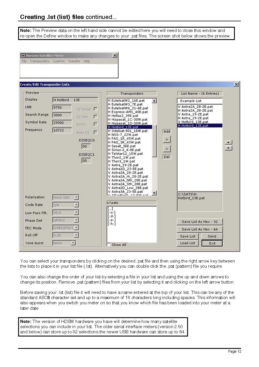

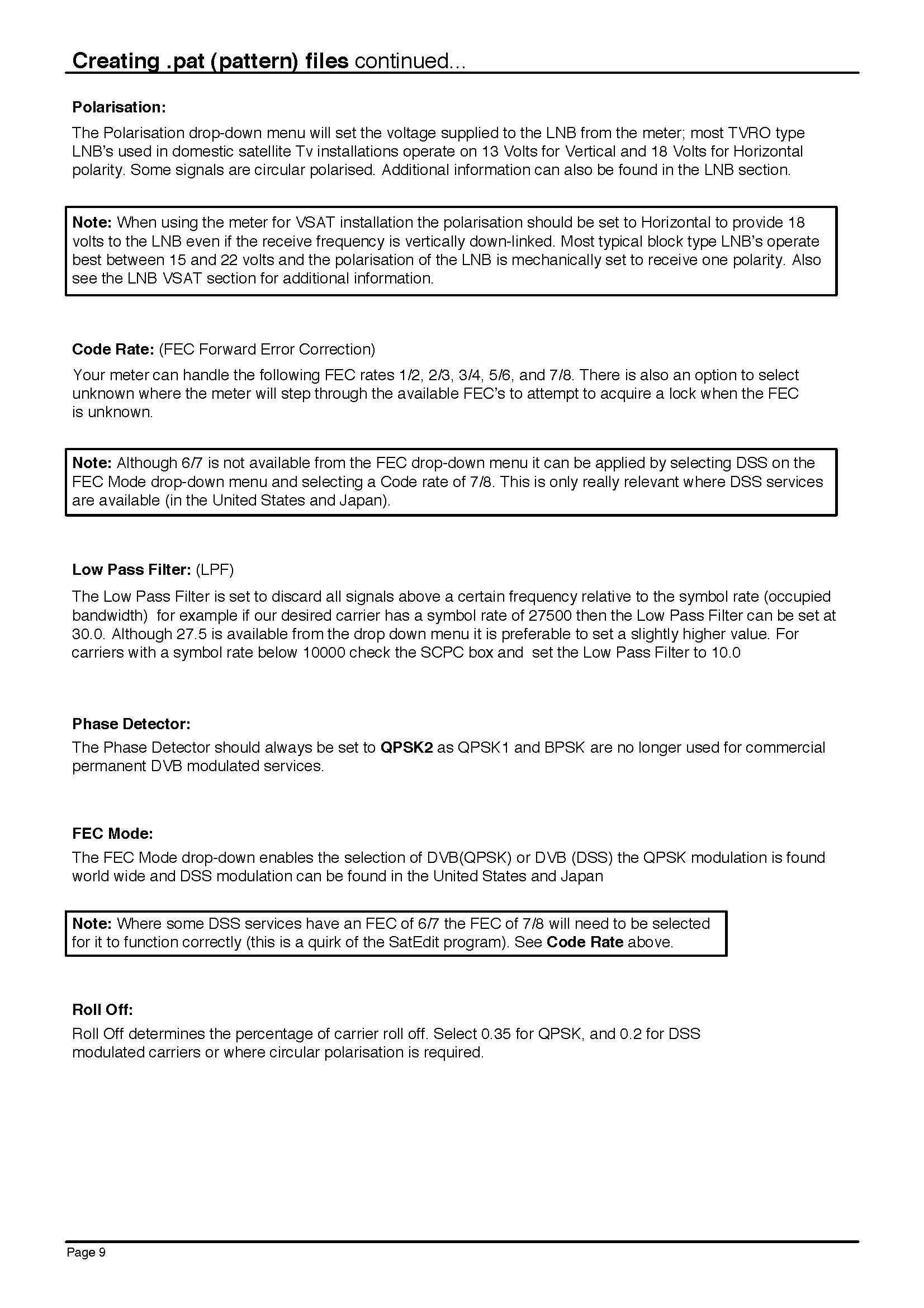

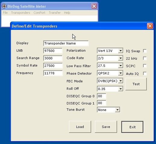

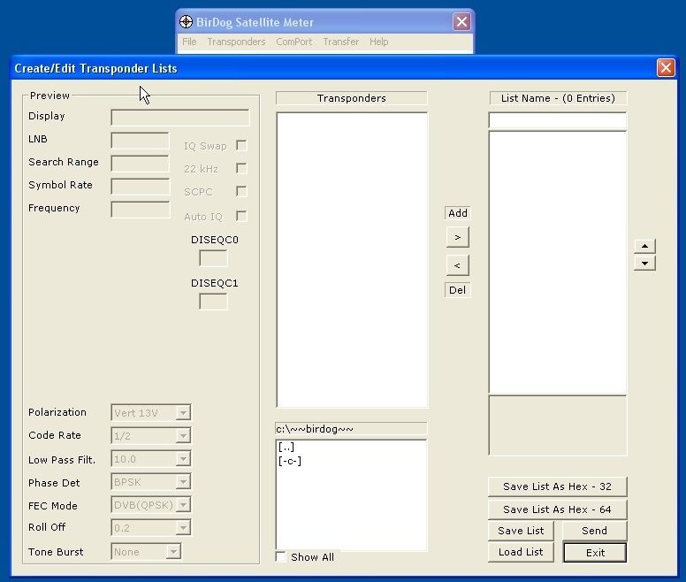

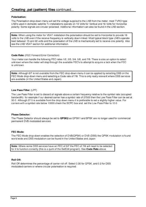

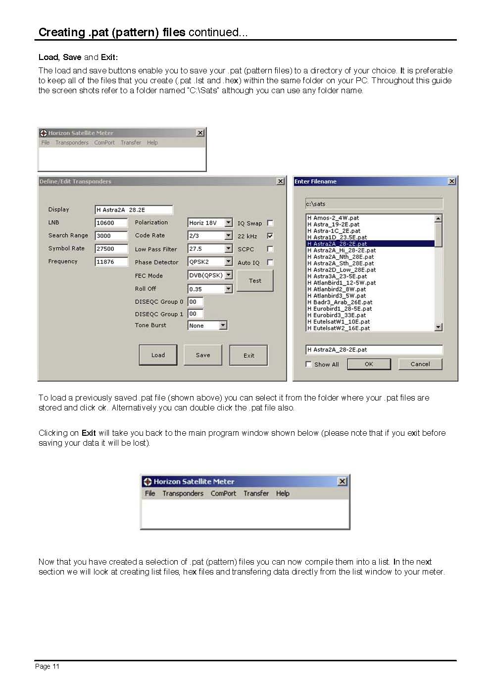

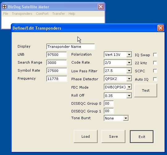

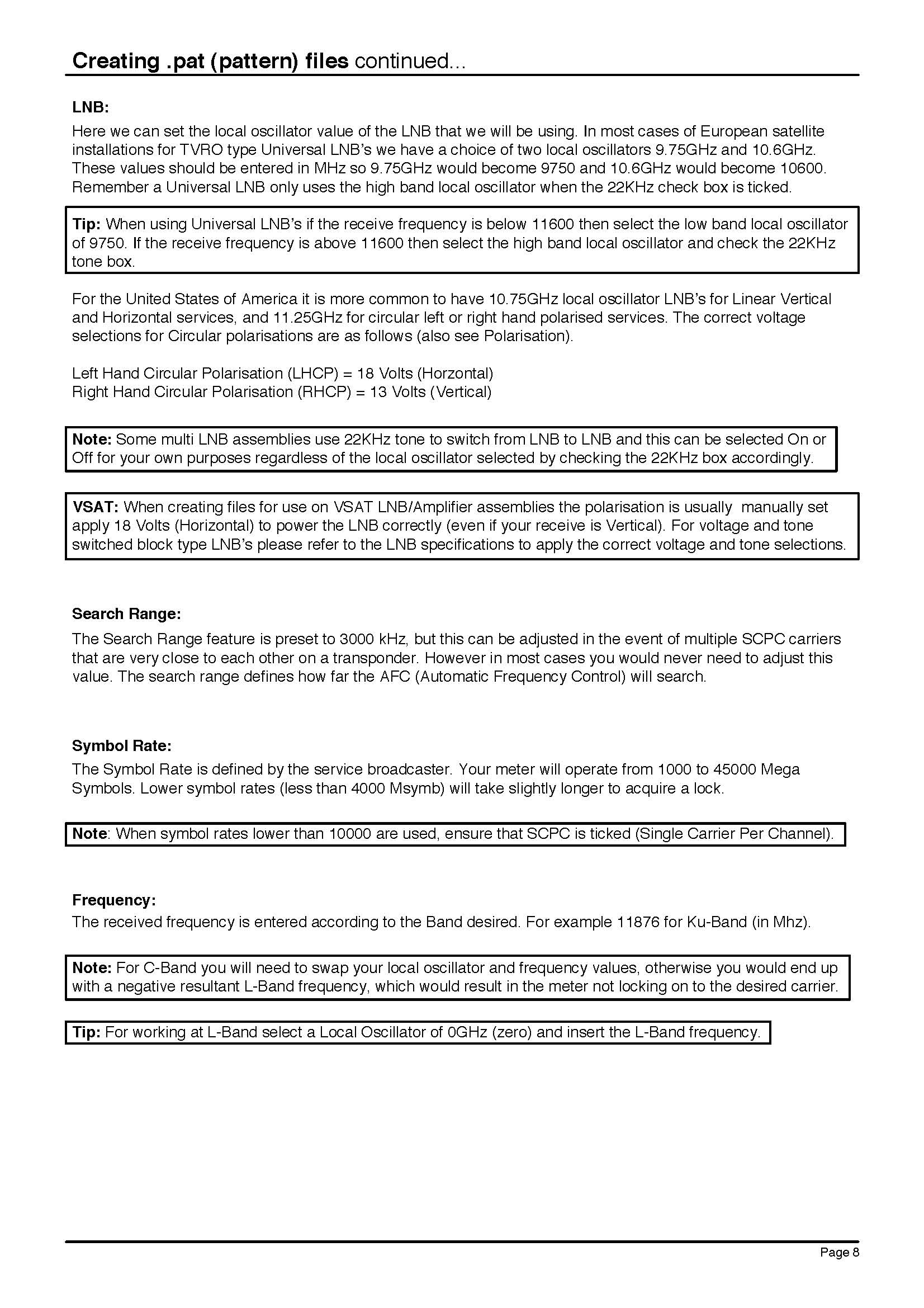

These are some snapshots of the screen for building your own files for the birdog.
More reading to do tonight...

Well, as best as I can tell, you can't change many settings on the birdog. You get a file from their website that they put together for you. You tell them which satellites you want to find and it makes a custom file which you load into the meter.
About all you can do is scroll through the list of satellites.
It looks like I have an older meter that has fewer options than the newer La-de-da meters.
The thing works just fine with little dishes on pay satellites and it works great on the big grey dish
From what I've figured out so far, the birdog people take care of all the little details in the files they build for you on their site.
They may not be making files that will work on the direcway dishes I have.
Maybe the dishes are too old and the meter expects a newer kind than what I have.
This is why I think I need to make my own custom files for the meter myself and not use the ones from their website. They sent me an editor for making custom files myself for anything.
I'm sure I can do it, I'm sure the answer is out there somewhere, I just have to plow through forums and try to sort out all the terminology and technology as it's all new to me. Some makes sense, most does not. Yet. But I AM reading, a lot of stuff.

Well I acctually envy you as you actually have full control of the birdog with that editor that the birdog people sent you. I can only update it via internet and I am not able to suit it for a particular application unless I ask them to do that for me. I can only search for the weak Tp that it usually has. For instance lets say that with the Direcway dish you could watch RTN on your tv , then all you have to do is create a file that uses that same carrier parameters that RTN uses and you will see the birdog will see FOUND since that carrier is already there.
Your meter is fine , it lacks USB connectivity , the Spectrum Analizer and I think the DiseqC Switch Contol capability , but who cares! , most people do not need to use those either. The SWM is a technology Direct TV uses so for professional instalers for Direct
TV is very useful since older meters can not even power those LNB's because it uses 24V I guess. for users like us any birdog meter will do. Just make sure it is updated.
Well, I'm sure the birdog people would mail you a copy of the editor too, I just sent them an email asking if the meter would work on the WSTV satellite with that direcway dish and they sent me that. Easy.. :)

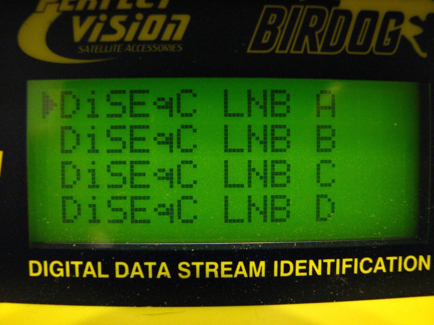

Also, the thing can switch lnbs. The instructions say if you hold down the power button it goes to a screen where you can change the switches.
I tried it and it does work on the grey dish with two wires going to this little switch box then one wire to the meter. I got help with that from my neighbor and by looking at the stuff the ex left behind. :)
It seems too much work to hook all that up and push all the buttons when you can just use one wire. But I guess it's there for a reason. :book:

The point we're still missing in this story is how BirDog controls LNBs. Try to find it in the Manual. Based on scarce web info, your LNB appears to be Linear, of a single or dual polarity (Vert / Horiz), with LO 10750. I found a bit dated, but somewhat useful info for you:
DirecPC Installation Technician Training. ;) It doesn't say anything about your LNB model though.
P.S. I looked at the BirDog File Editor pics you posted, and now everything is clear. It may still be over your head to program it correctly. The starting point for you is to post in this thread shown by your PC Card parameters of the channel you're trying to catch (or confirm locking, since you already watch it) with BirDog. The thing is, in order to program something into BirDog, you need to know just a bit, what are you doing. It may well be that these parameters are already refreshed in your latest file. Look also, whether LNB control params for this sat match the LNB you have at hand.
Now, it was said, BirDog is looking for a weakest TP on each sat its pointed to and able to register signal from. I wonder, if its only true for the latest model with Spectrum Analyzer, or even correct at all. It may be, your meter is looking for the 1-st TP on the sat TP List instead of the weakest TP. If the 1-st TP no longer emits signal then the meter shows nothing. To use a "weakest TP" algorithm, a developer would need to define, how to select one: going through a pre-set sat TP list, with spectrum analyzer, or based on a Network provided TP & Channel Table. More, depending on geographic location and tuner chipset quality, it might often be impossible for a given receiver or meter to lock in every emitting TP of a given sat. If in this frequent scenario BirDog would prevent locking any TP of the sat, it would contradict its purpose as a sat finder. No-one would buy such a sat blocking meter - getting everything is hardly possible in life, but give me at least something from that sat! We often see it with 8psk or DVB-S2 channels. It may help to ask BirDog developers about its logic, but I doubt they'll tell, or even know it, as it may be part of the chipset inner working they know nothing about. Remember, its all know-how of each component maker. We can say at this point - don't know the BirDog logic, but can edit its file to narrow and direct its efforts.
It looks like you're determined to setup a small dish farm in your backyard. Still need to figure out, how to control all these LNBs & dishes from your PC Command Center, so you may eventually need to design a whole sat reception system with all switches etc. Might even manage to permanently fit BirDog into it. :D That will be your FTA degree graduation date. :up Hope, at the end you'll enjoy the channel choice FTA delivers on Ku-band. Some equipment upgrade plans may still sound reasonable.
At this point, I think a set-top receiver would be a great investment. You can snag a good SD receiver for next to nothing on Fleabay these days. Trying to aim using a PC card is literally next to impossible. The fact that you've done it means you're VERY proficient at aiming a dish. A stand-alone receiver will really help :)
zamar23.
I believe that LO you posted is a typo.

I have an idea. Perhaps you could post the configuration files and editing sw you have received from Birdog and see if we can play around with it and get you a valid configuration of the popular stuff available up there.
It wont be as much 'fun' as having to find all this stuff yourself, but you dont seem to be having too much fun at it so far. You are making progress. You've got the 97W stuff, that's good. Did you note that you had to bring the elevation up and move the lnb polarity almost to zero skew from your attempt at a 129W fix? Learning to note these differences will let you get in the ballpark by knowing which direction and appx how much you need to move from one position to the next for what you are seeking.
Your neighbor and the original owner of the meter appear to be of considerable help to you. Maybe one of them could look at the config data you have loaded to the meter and tell you if it is correct, by comparing it to a recent FTA list.
Send those attachments, there are probably a lot of people that would like to play with that stuff.

Thanks for pointing on it, it's a typo. Correct LO 10750
Go figure from this thread, what's this LNB for? :confused: But from Dee_Ann's reports it sounds being Linear. Good idea to post here the Config file and upload the BirDog Editor package in addition to posting the channel data shown by your Card if you can find it. If the BirDog owner only installed DN dishes, he might not be of any help to her.
