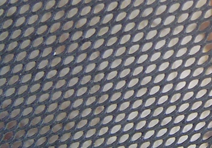

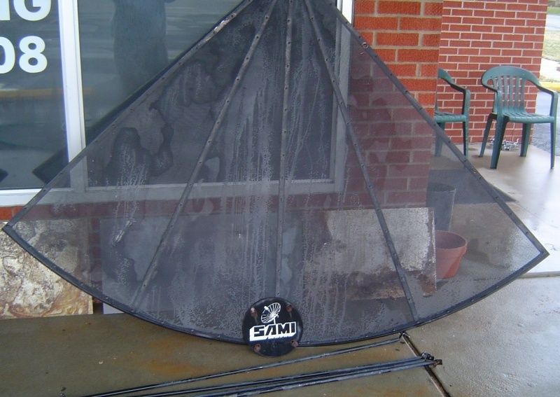

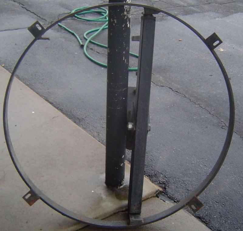

Stopped by an old friends office today because a mutual friend had told me that there was a dish in his yard.
Tried to con him out of it, but he said he was still using his with an analog and DSR-905 sidecar attached. So we talked a while, and his secretary was listening. Just as I was getting ready to leave, she spoke up and said her father had a dish, but that I probably wouldn't get it for free.
She gave me his number and I called him, drove out to look at it. He had it up about 10 years, and took it down about 5 years ago. He had it stored in sections in the rafters of his shed.
It was a 10' SAMI Model SC10 mesh dish. I looked over the sections, and was impressed by how smooth the surface was. Flat and smooth. The holes in it were tiny. I couldn't even get the point of my pen to go all the way in. There were a couple of imperfections in the surface but not much. I asked him how solid it was at the outer extremities. He said it was rock solid. It only had a Von-Weise V76-10 18" actuator with it, but combined with the off-set polar mount etc. I liked it.
I asked him what he wanted for it and he said $50.00. I tried my best to get it at a lower price, but no go. I finally said I would take it. We started loading the pieces in my van, but the sections wouldn't fit. I asked if he had a pick-up and he said yes. I asked him if he would deliver it, and he said because I met his price, he would deliver the sections for the same money. It was about 20 miles away.
I really haven't been looking for a 10' dish because of putting them on the roof, but I couldn't say no on this one.
It was filthy dirty. Mud daubbers nest, wasps nest, and bird crap all over it, so the first thing I did was to spray it with some Krud-Kutter, and hose everything off.
It was still damp when I took the pics.
This should be a signal sucking machine. :D
