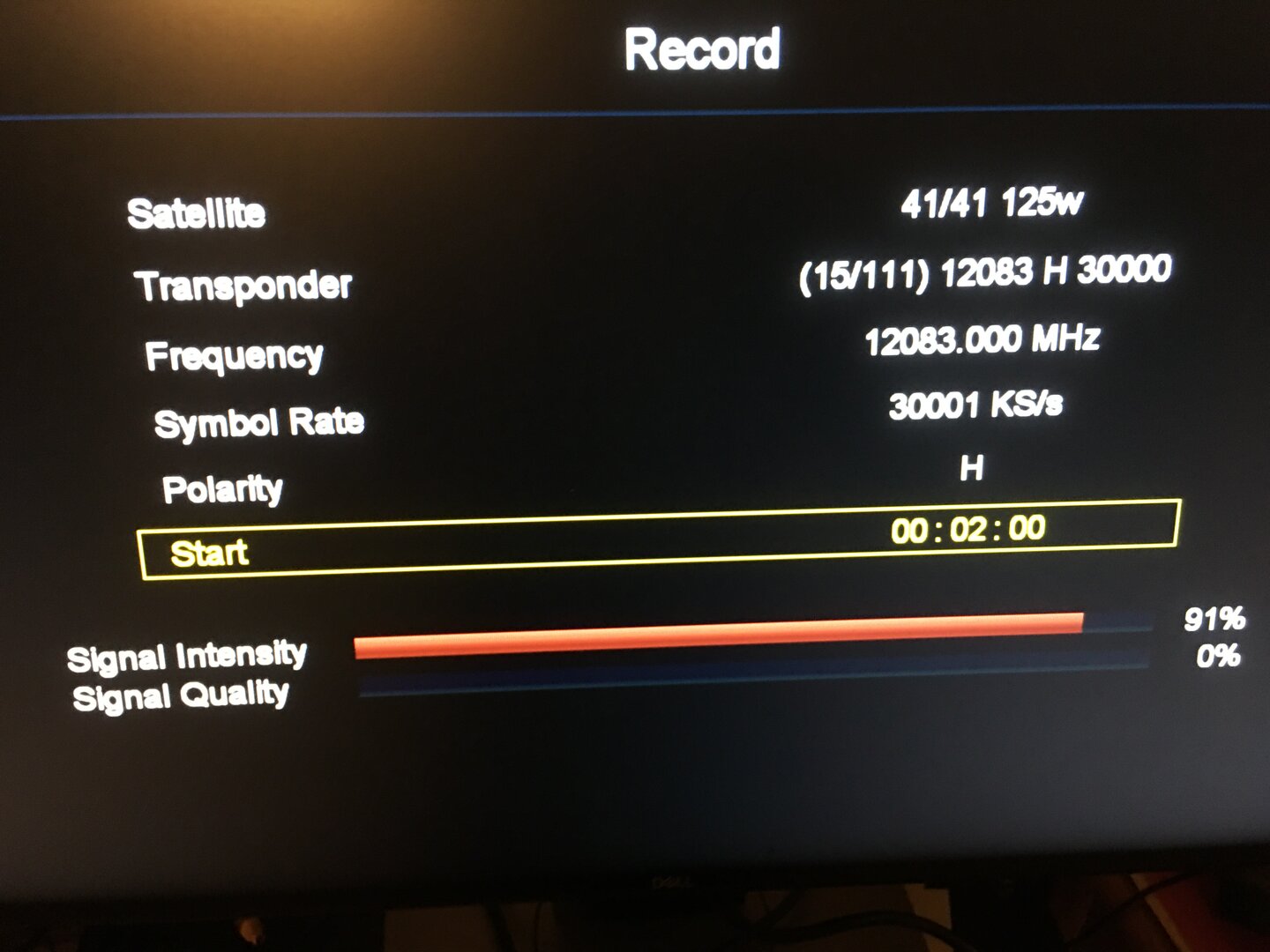

I just got this Sat receiver and works perfectly as FTA set now on 125W with all the PBs channels with 90+ signal strength and 60+ of signal quality.
However when I try to record and set the DVR or any other option related to Recording just freezes 100% and only way to get it back working is to pull the power supply off. Then starts again normally.
I re-scanned again and when trying only to user the RECORD option just seems that it does not get any signal for the particular transponder that I can watch perfectly if I go to just watch that channels on this transponder.
See pictured attached.
The instruction manual does not address the recording features or procedures at all.
Does anyone with a manual or knowing the problem can help me with this?

From your second picture "Record" I don't see where you are getting a signal quality. No signal means nothing to record. Maybe this locks it up?? I don't know so I'm just guessing.

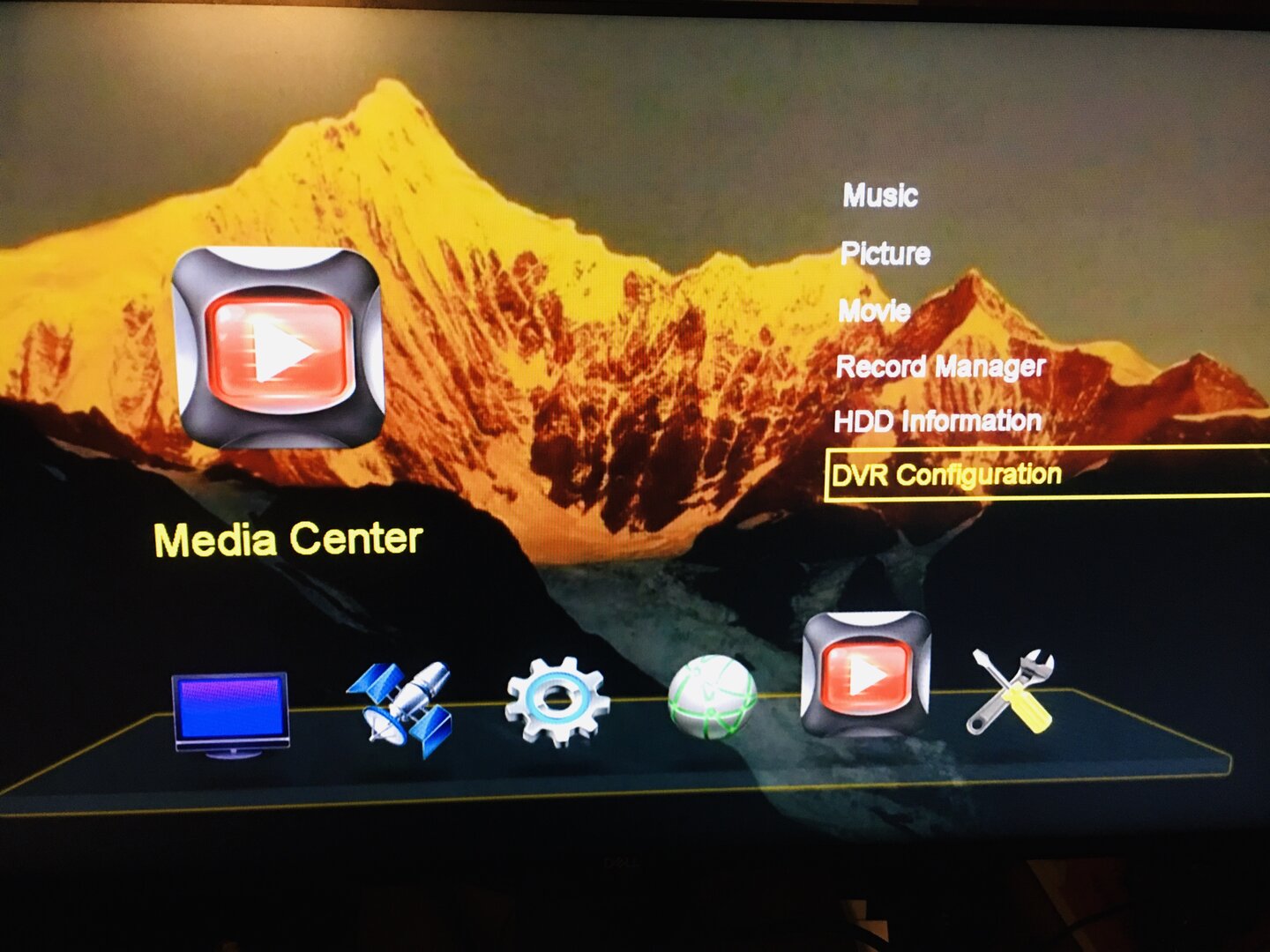

From your other thread you said you were using a "stick",possibly not compatible, maybe needs formatting.I have an older V7 that I use an external hard drive with that has to be formatted.I never tried it with a stick.
Thanks, The stick seemed to me OK in the PC, so I assumed the GT Media would recognize or ask me to Format.
Do you know what parameters your hard disc is set to? I have an external HD and will try that too.
Yes, I noticed that too, but without any changes I go to the main screen and the channel is playing very nicely with 60-70% signal quality.

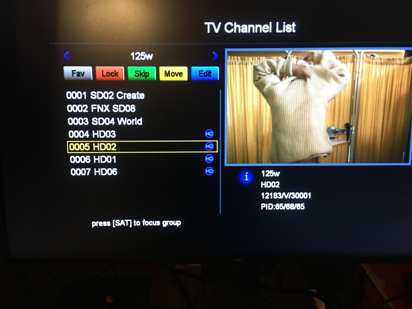

Not familiar with that receiver but I noticed that your pictures show two different transponders. The first shows the channels being viewable on 12183 V 30001 but you are selecting 12083 H 30001 for your recording attempt? Did you select 12083 by mistake?

Like I said ,I have an older V7 and the menus are different but,somewhere in yours there should be an option to format HDD.Mine is under "Storage Format"but I don't see that in your list.You'll have to go looking for it,also be aware that not all receivers like all hard drives,YMMV(your mileage may vary),file type should be NTFS.
Once you get the box to talk to the HDD or stick,record from either the REC button on the remote or set a timer from the timer button.
It was as my receiver picked it up from a blind scan.
I noticed that also and tryied to match both but cannot remember what happened but for sure did not work.
But I can watch the channels perfectly wit Sig. Strength 99+ and Sig. Qual, 70+ and when I swap screen get not signal regardless of the transponder.
