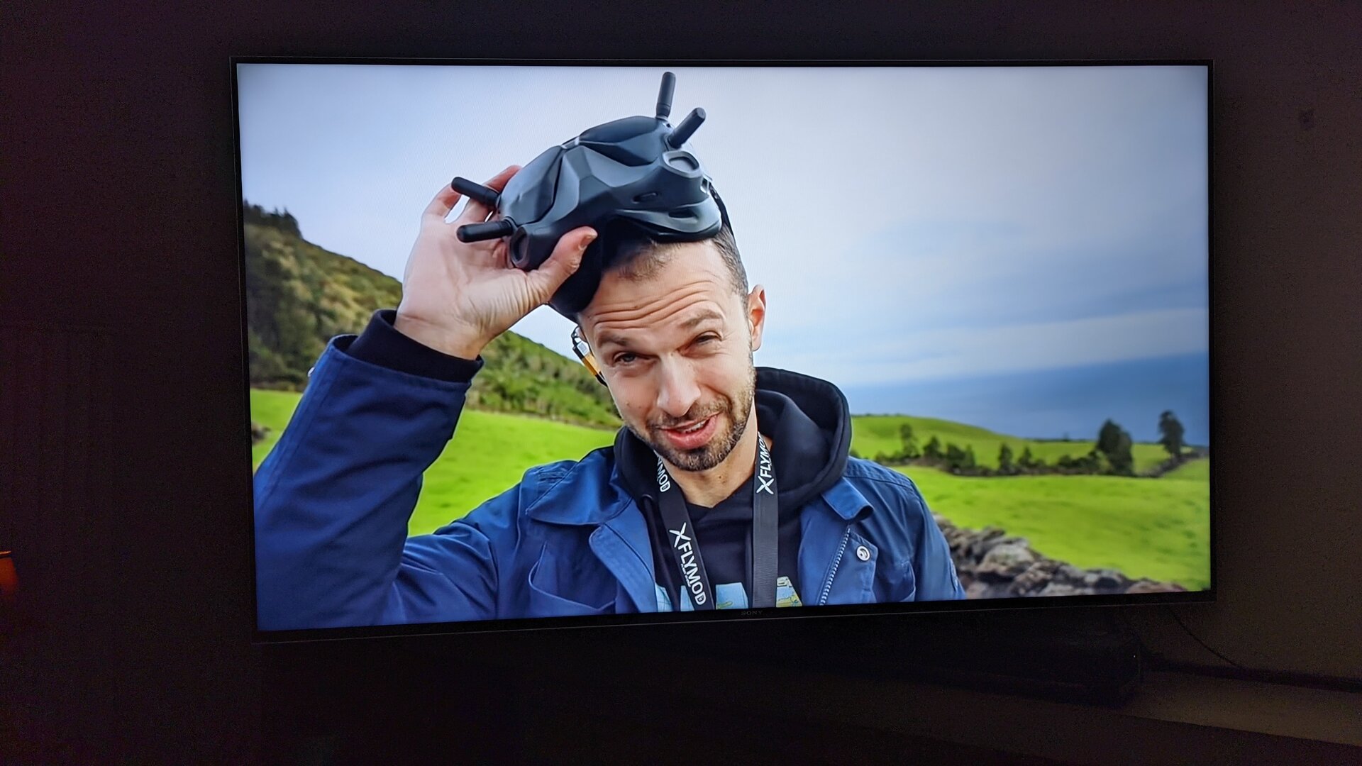

I need info on new hopper plus
Not sure how this is going to show up on here but this is a picture I just took of a face on my TV, 4K feed and you can see the definition and the details and this is what I'm not seeing on the hopper Plus
Aaaand of course it looks nothing like it does on my TV lol. The colors are not that bright irl, for example, but you can see the darks are not over-exposed
