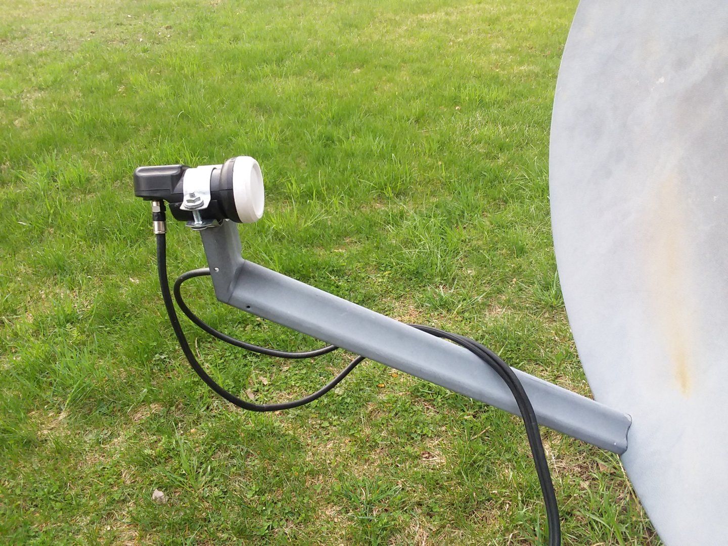

I am pretty sure those were for two Primestar satellites, I don't think the distance is right for any satellites we look at. I have three or four of the 84E dishes and I just made a bracket out of flatbar steel I had laying around. ALL of the plastic hardware on those dishes gets brittle after enough years in the sun.

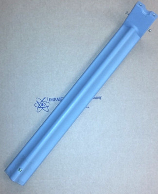

I've also made arms for the 84E out of the arms from the old directway internet dishes, the profile of the arm is similar, and I think for the lnb holder I actually made it from WOOD. LOL
I don't use the 84e dishes anymore not enough satellites to waste time on them.
Using the factory type LNB with the scalar designed for the shape of the dish would be the best solution for proper illumination of the feed. The dishes I have came with LNBs with separate V and H inputs. I just use typical LNBFs on my Primestar dishes and I fabricated a simple mount with a conduit clamp with a hole drilled into the side for attachment. Works just fine for my needs.
