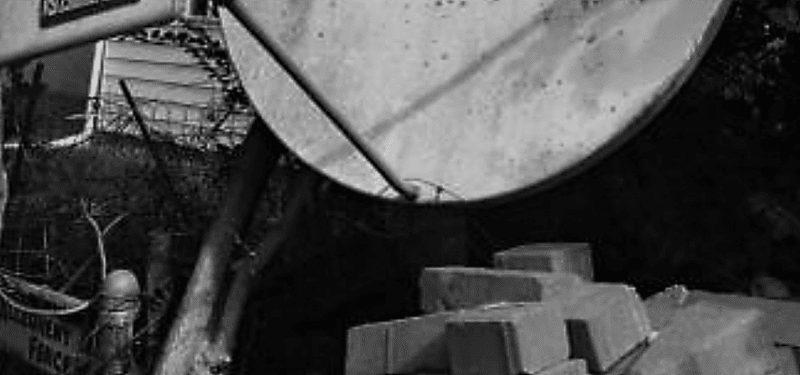

I do not think so. Crack is just cosmetics and almost do not affect performance. Of course if price is a bargain than why not have this nice dish. I also think that crack can be easily fixed, so, no one will ever notice there was one.
Not really you must reinforce it well, the signal on an off dish is not affected on the bottom, that is why you could have snow 5 inches up from the bottom and not affect it, but the top part is

That is for sure Channel Master, but not necessary 1.2m, it can also be 1m dish. Feedarm is bended, all nuts&bolts are rusted, but what is worst- the lower part of has cracks. View attachment 134966

Are you sure it has cracks? It looks like two zip-ties looped together, hanging on the lower feedarm. You can make out the lower zip tie. Feedarm does not look bent abnormally either.
I'm only looking at the picture posted here, original ad doesn't seem to have that pic anymore.
Examined the picture more carefully.... I still think it is a crack. However, it also look like zip-ties, but they are not hanging on the bottom feedarm, not even touching it from above. Side feedarm bended, but you are right it is not so badly. Does not matter, I think the dish is gone. .
When they were worth something, I did fix one with a crack in about the same place I cleaned with white vinegar which is a mild acid and from behind I took a Dremel drill with a cutting disc and cut a channel across the crack that cracks would need about 20 cuts, also used sandpaper to rough it up than I took rg59 coax wire, removed the solid copper wire and laid it into each crack, as rebar, covered it up with something like this stuff is, it worked, keep in mind you can cut off 20% of the bottom of an offset dish, and it won't hurt the signal, that's why snow doesn't affect them on the bottom

I've fixed a couple in a similar way in the past its the best way to do it imho, ive used this stuff
Code:
https://www.amazon.com/272-Bondo-Glass-Fiberglass-Reinforced-Filler/dp/B000VKZ3JM
once sanded and a little paint you would never know it was there, far better than bodging a bit of plastic on them once the above stuff has gone off its as good as new.

It's not all plastic if it was you would not have a reflector, there is a metal mesh under the plastic
