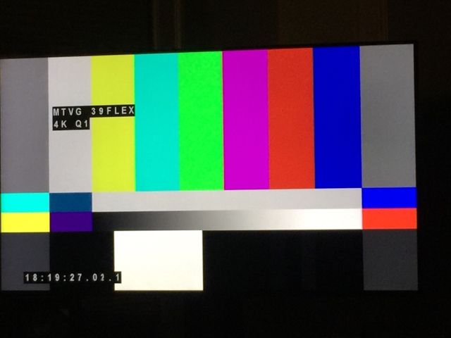

This is to show I got it working... but the HR54 does not know channel 9800 exists so I can not tune to it. I don't believe the C61K has its own IP address that I can pull this from.

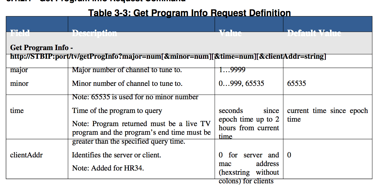

Still no luck...
Trying 192.168.1.55:8080/tv/tune?major=9801&minor=65535&clientAddr=macaddress and giving a 400 error, even though the documents say that is correct.
Ok, thanks for all the effort and the other updates so far. Seems the SHEF commands are just not going to work on these channels in their present test status.

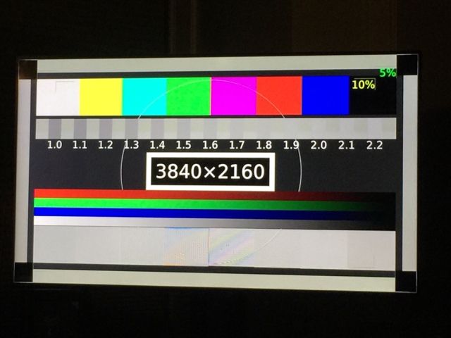

Was mainly interested to see what kind of code for the compression format may be used to see if standard MPEG-4 (H.264 AVC) is being used or if HEVC (H.265) encoders are actually being used to encode live UHD TV on the fly.
Sent from my SGH-M819N using Tapatalk
Right now they are showing soccer, with a really poor picture.
Its been frozen for a few moments.
I am hearing that 9800 is just a regular 4K stream, and that 9801 is using Bonded Transponders, which is cool.
Boxing is back on both channels now...
And my wife wants to watch TV so I am going to turn off the test channels for now. :)
