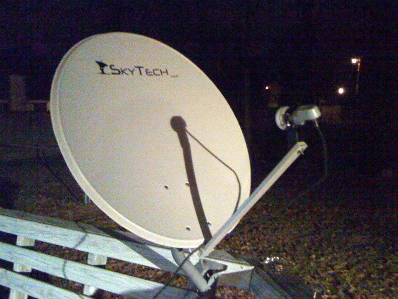

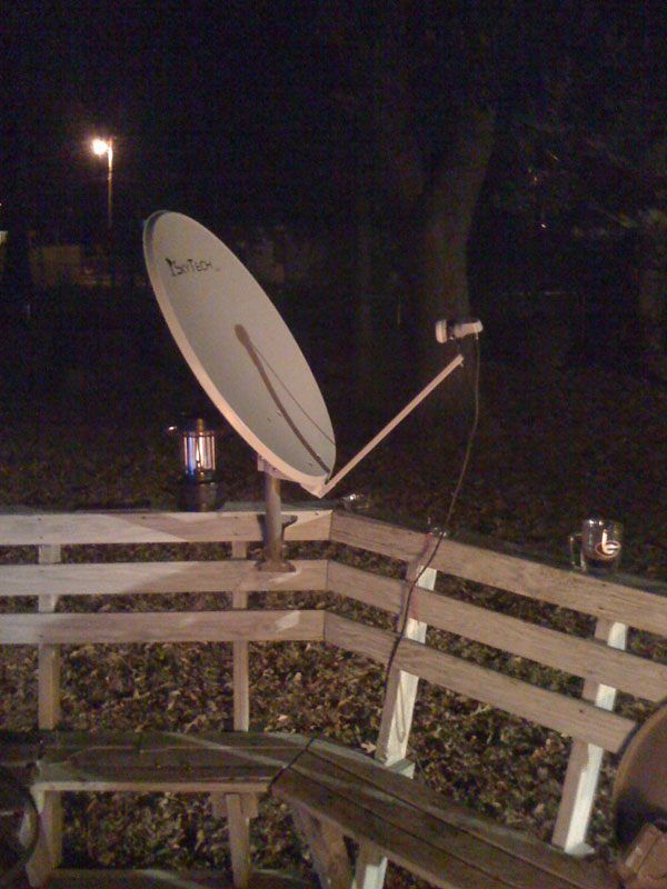

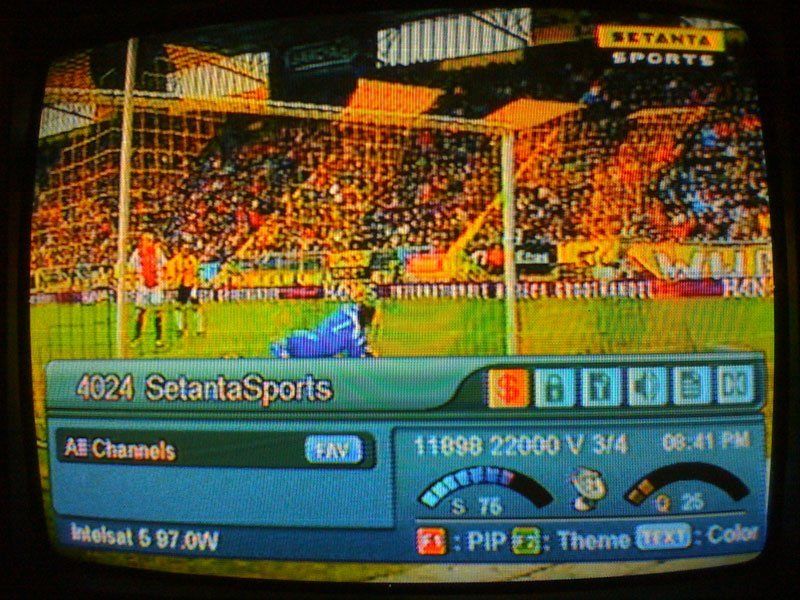

I feel bad for you guys in the north. My mom lives in NY and she loves the snow and cold but I cant stand it! Im from FL all my life and when its 40 here I'm pissed off. haha. I got the skew right (finally) and realized that I had the settings for my universal LNB wrong. I had been setting it to 10750 but it should have been 10600. :-( damn hours gone. But did get a nice soccer game on 97 after it was all said and done. Took pics with the iPhone, will post tmw. Again thanks for everyones input. satguys rocks!
