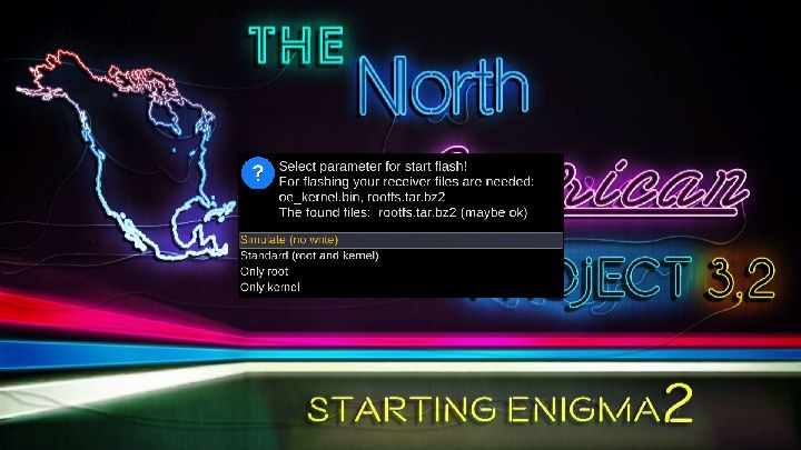

I made a backup of slot 2 and rebooted to slot 1 and then I brought up the backup plugin and clicked the blue button to restore. I then navigated down to "fullbackup_osmio4k" and clicked the green button. After that this screen came up:
Is this correct? If so, what button do I push next?

I pressed OK and the next screen gave me 4 options, which one should I choose?
