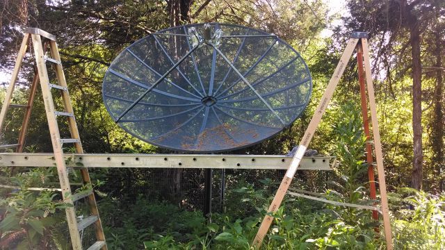

This is how I do it. With the scaffolding , the ladder is not in the way of the signal, and you can stand out of the way of the signal too.
