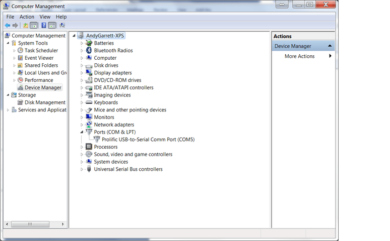

here is what the device manager says, I tried re-installing the driver with no success ether. Have to check the cables this afternoon after church.
Did you use the zip from tvro.us/USB.zip?
Figured it out and have it going now, The RX wire one the usb had come off the board. Thanks for the help guys.
